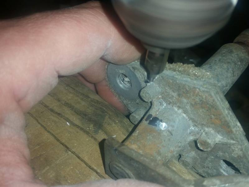

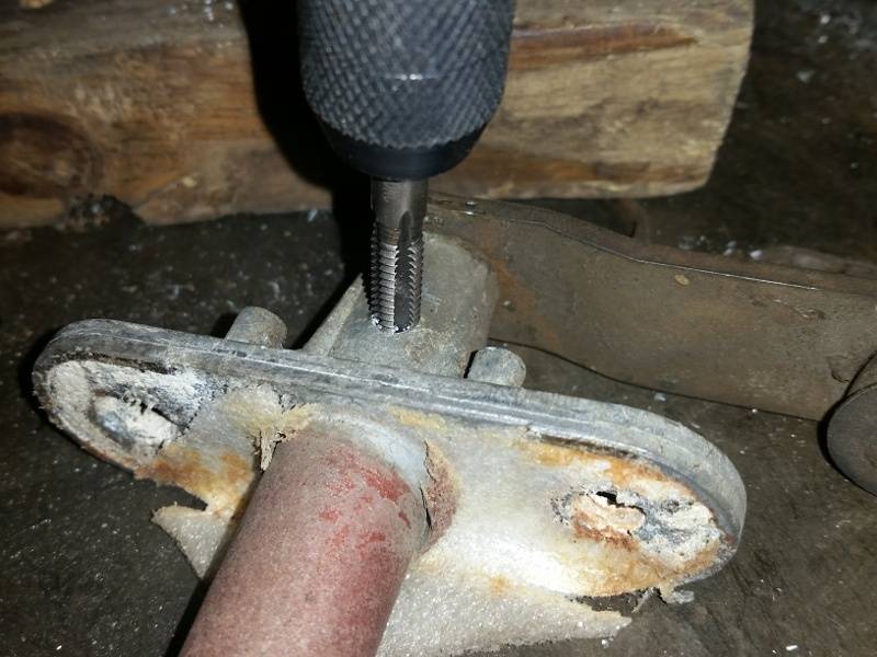

Now for the wiper pivots, and adding a zurk grease fitting . . .
First start a hole with a centering drill bit . . . ( marked a black spot on the bottom of the pivot with it in the car so they can be accessed in the car )

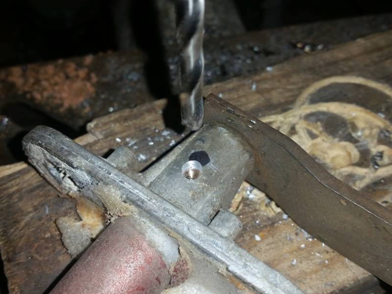

Got the centering hole done on both pivots . . .

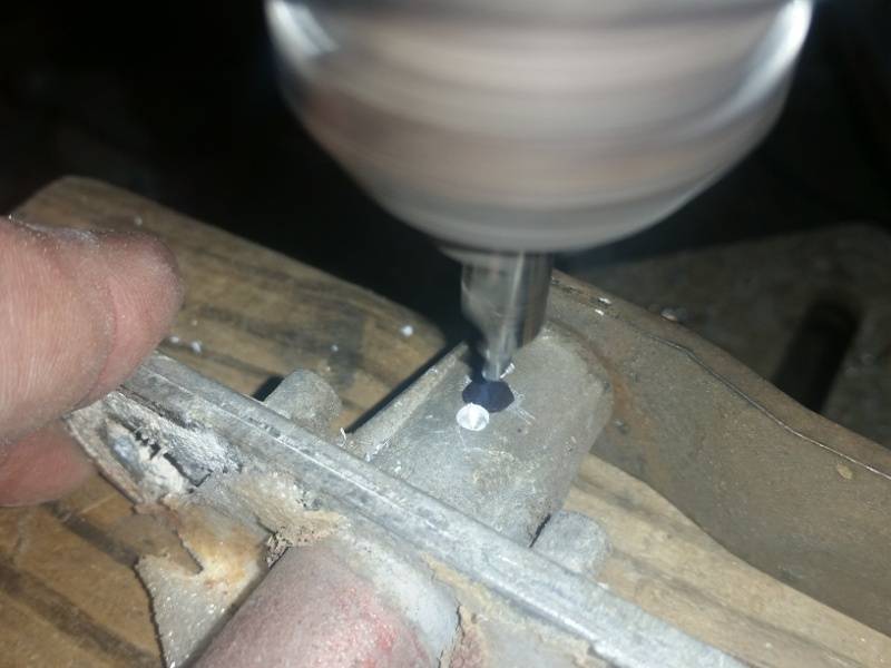

The drilled the hole until it touched the shaft wiper . . .

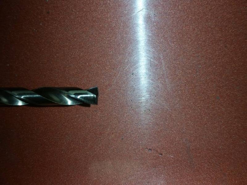

Then ground the tip off the bit to get a better hole down to the shaft . . . drilled both till it hit the shaft again . . .

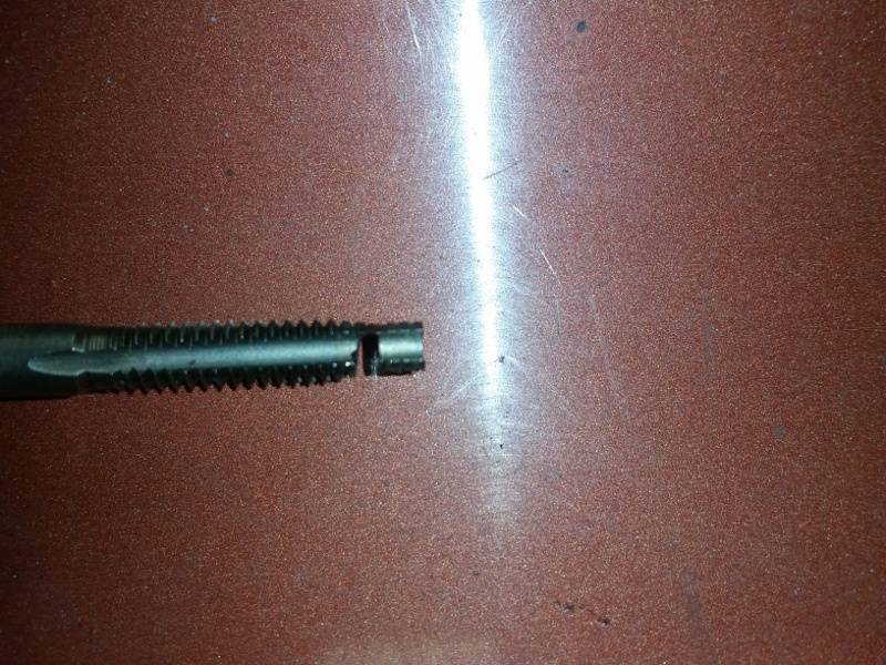

Then had to cut the end of the tap off to allow the cutting teeth to engage and start the thread cutting . . .
Continued cutting the end off until I got good threads in the hole . . .

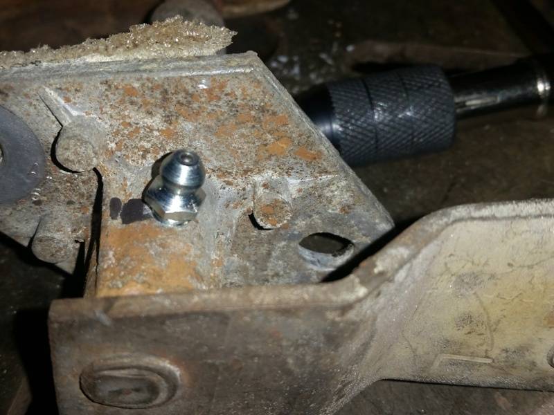

TaDa .. . . tapped the hole - we've got threads . . .
And . . . last but not least . . . add the zurk grease fitting . . .
ready to add grease . . .
