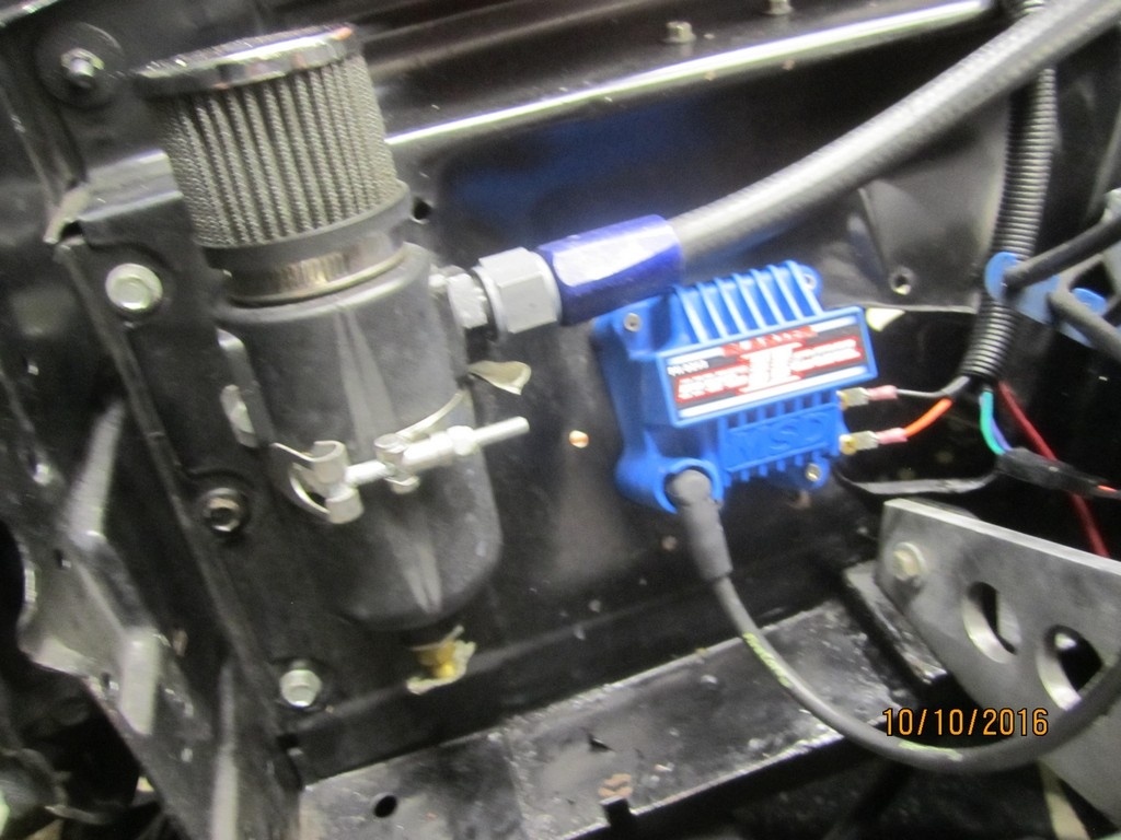

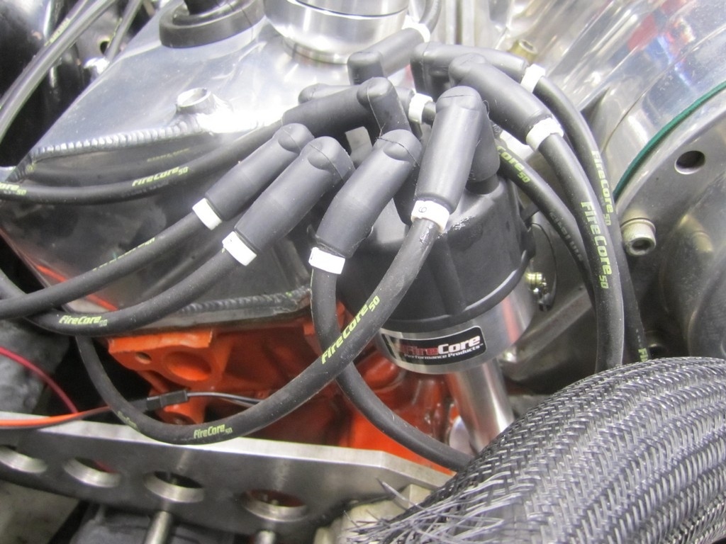

For othlers that might want the next step in igition,the MSD 6al-2 ignition box is programmable with a laptop and you can lock out the distributor because it will now be managed by the ignition box.You can use a stock electronic distributor or the Firecore or MSD ditributor

Hi all,
Just digging up this thread instead of creating a new one.
An MSD ingnition package has been installed now on my '69 Coronet (440) and the tach is not hooked up.
The distributer (MSD partnumber 8387) does provide the gray wire for a rpm signal.
It is combined with a MSD Blaster SS coil (part number 8207).
It states in the MSD manual this provides a 12V signal for the rpm meter. (positive? +, negative? -)
Originally the signal wire for the tach is hooked up the the negative pole on the coil.
Can i just hook this up?
As per Chrysler schematics, there are 2 wires for the tach, 1 wire from the coil negative terminal and the other appears to be a fused 12V.
I assume 2 positive feeds into a rpm gauge will burn something or is it supposed to be like this?
Or do i need to start to do a better job on electrical study? :)
