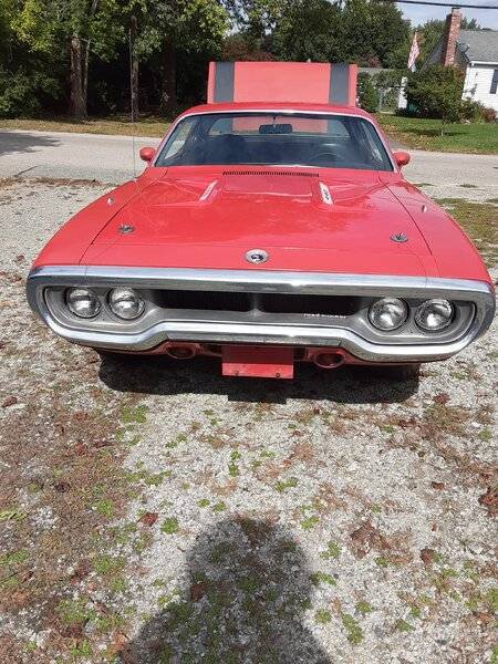

I haven't heard them refered to as hockey stick hoods either,but after I read it I knew what he was talking about. I have one that is waiting for me to get time to convert it for my friends 72 Road Runner GTX . I already painted his set of 15x7 rallye wheels so he can get rid of those ridiculous dog dish hubcaps that has become a sick fetish in the Mopar hobby the last few years. This car was an original N96 car that a previous owner swapped out the hood,note the stripes on the trunklid.
