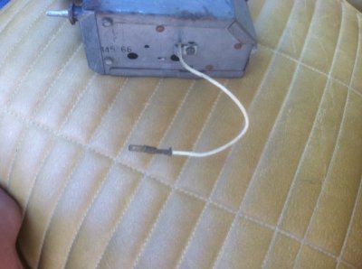

I am going to attempt to pull the dash and check each of the gauges separately. This white wire on the radio I assume is for the EL but I think it is just missing its plastic connector as long as I put it in the dash red socket and tape up any exposed metal it SHOULD be ok right? photo 2.JPG
yes
