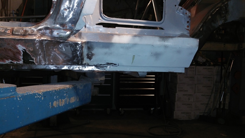

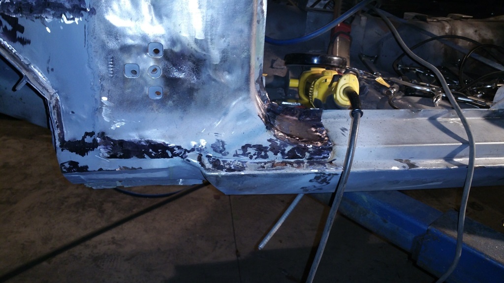

Ah ok I put seam sealer on the inner rock also where I could reach. Problem I had was while I was welding the slag was sometimes burning it on the inside. Also at the rear where i patched the outer and inner rocker I didnt put any drain holes. Should I drill tiny holes at the bottom of outer rocker for water to get out ?

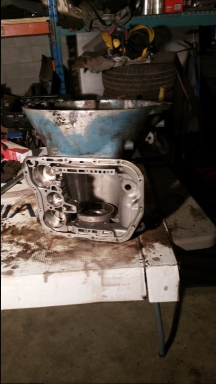

but in meantime i am also rebuilding the tranny. my question was would it be ok to power wash the tranny shell ? or flash rust would be an issue? or power wash then i can blow dry it with air compressor?

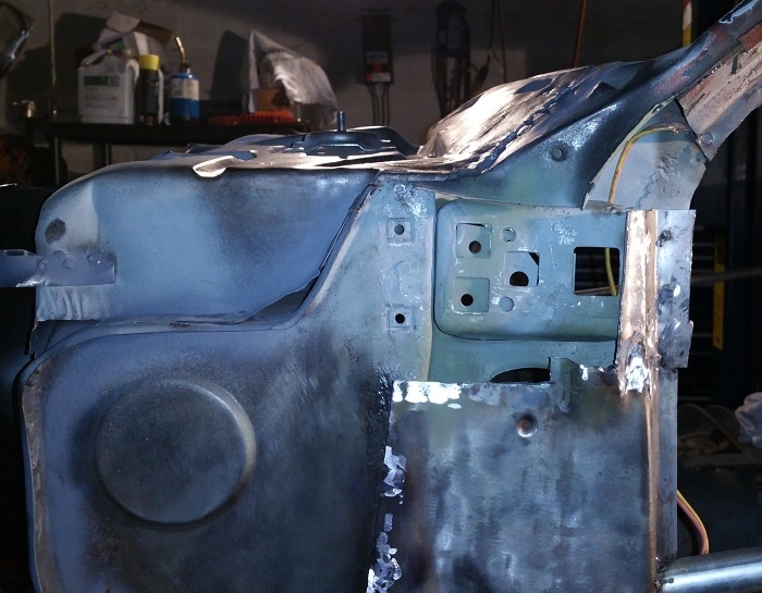

Looking good, sorry I didn't get back earlier about the rockers. Yes my 73 was bad at the ends of the rockers too I spliced them just under the rear door jamb and then patched them at the rear and at the front from the hinge pillar forward I cut a piece out of a 72 charger that was scrapped for the right side and believe it or not I cut the same section from a 75 fury I believe it was, that fit great except the flat part of the rocker you would see below the door was too wide so I cut it and sectioned out the piece. I was amazed that the fury was the same, even the door hinge post was similar.
what the hell how did you even attempt to test the rocker from a 75 fury? lol car looks totally different. thats crazy
When I went to the scrap yard to salvage what I could from the 72 charger I happened to start looking at the fury and noticed the rockers seemed similar at the door jamb area for sure, they were pretty rotten in the middle but I cut out the whole front portion from just behind the hinge pillar right to the firewall and blasted and Grafted it into my 73 charger. I thought it was weird too haha

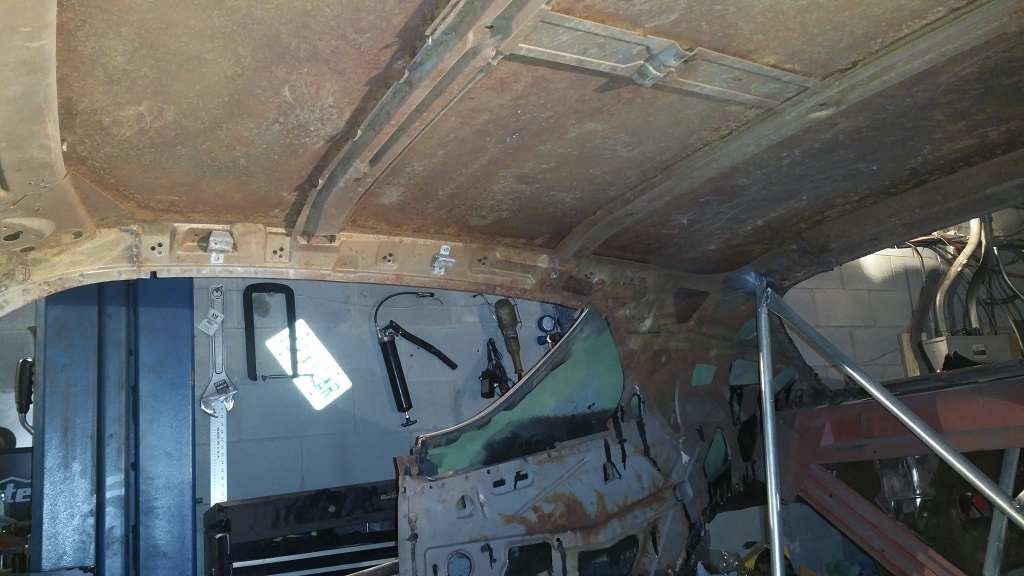

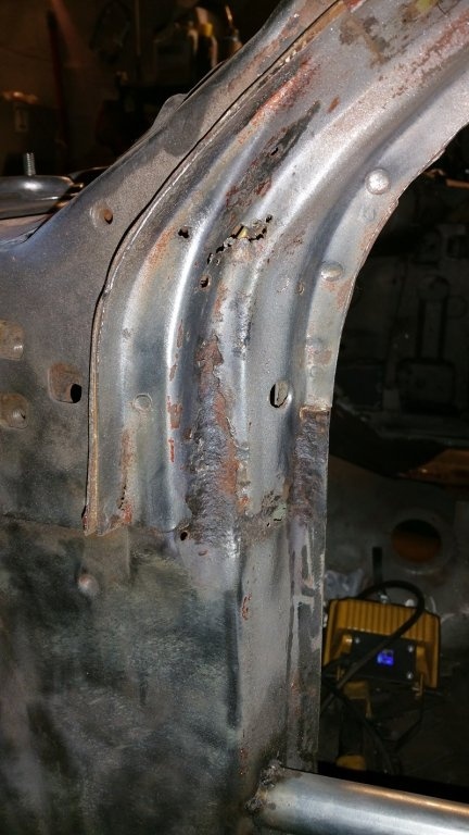

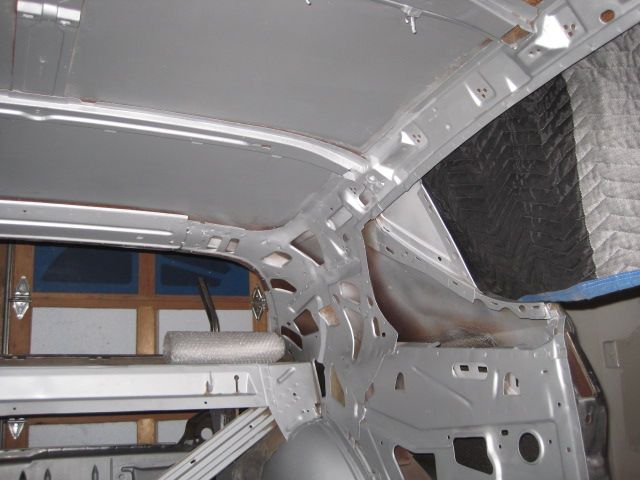

Question about surface rust. Should i sandblast this area or can i just wire brush it a bit then apply POR 15 on top of the surface rust after the metal prep?

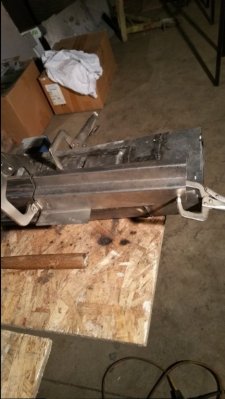

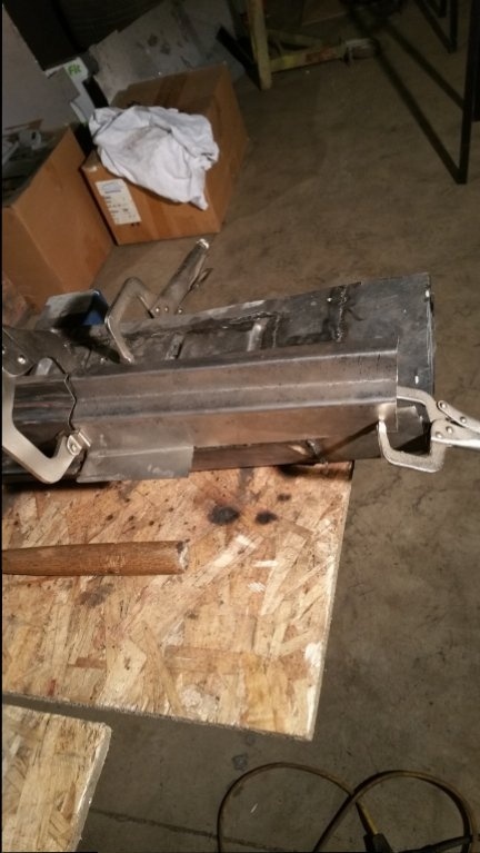

I hand fabricated the same area in my pillars on the 73 I had as well. Came out really well I just took my time and made them in a few pieces and welded it all together. I don't have a shrinker stretcher so I hand formed the pieces in sections small enough to work with. Good luck with yours!
i did the same thing, did small parts at a time. i tried to make the entire piece but it was taking to long.
I probably wouldn't blast that area. In the past, I wired wheeled it down and used Rust Bullet over it. The blasting could do more harm than good.
Looks good charger72 did you wire wheel and apply bullet or some other seal? Should I wire wheel to bare metal or just to break up the surface rust?
did you spray it with a gun or roller/brush?
I actually used one of those 3M rust strippers, actually used one of these to do most of my car. Also one of those small wire wheel strippers as well.
I went all the way down so the metal was nice and clean. To apply I used a combination of small paint roller and I also used one of these sprayers.
i just realized that 3m pad you can use sideways, damn i need those
mine attaches to a grinder and takes forever. i will use it for my hood but the under roof the one you have will be better
ill look for some of those.

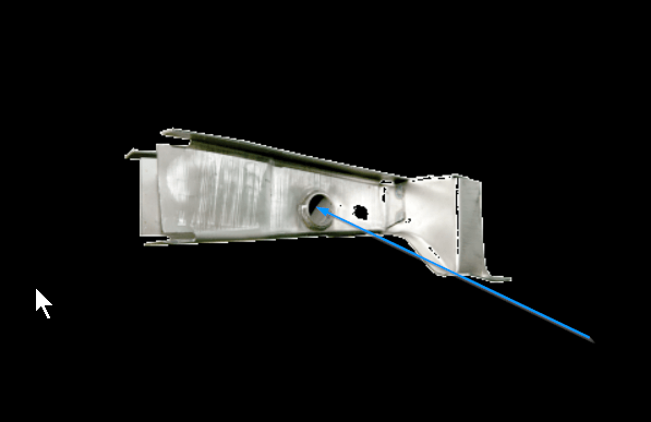

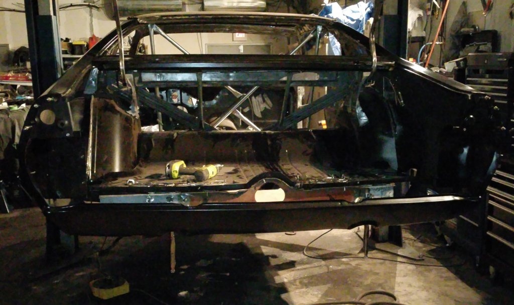

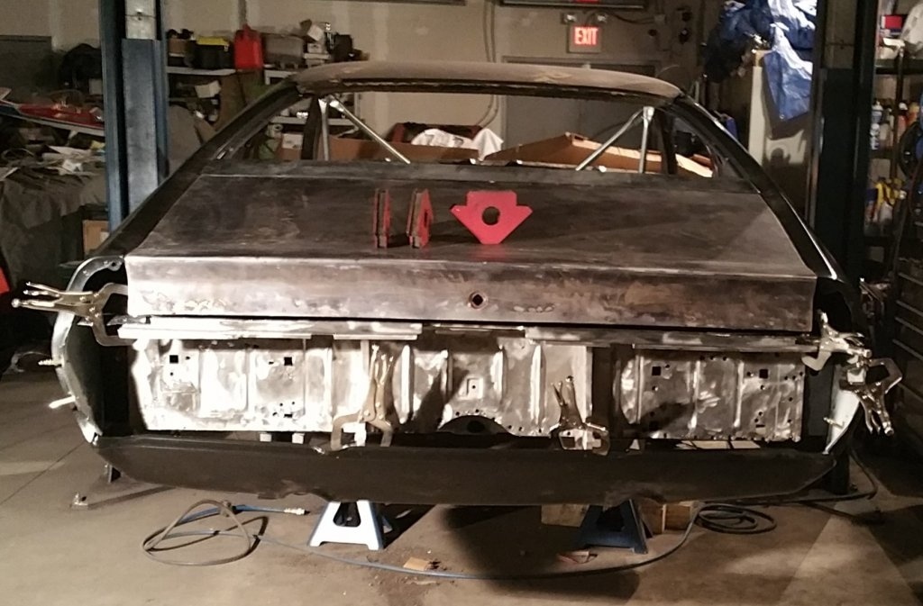

wow i think im gonna smash something. we set rear rails per measurements. we were test fitting the rear panels to find out the rails are to high. everything was measured perfectly on center hole of the rear perch. what will be the consequence if the rails are lower than factory? these are after market rails and im guessing the rear portion of the rail is wider than stock so this will make the rear perch center hole off. i need to do this so everything lines up at the back.
im not sure if it will cause any issue if the leaf springs are about 1/2" to 3/4" lower besides looking a bit lowered. i plan to lower the car a bit anyways with lowering block.

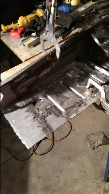

finally all patching is done. does seem my rear rails are a bit high, going to adjust those next. testing fitting all panels.
all patch work is done. should be reading for priming in a month.

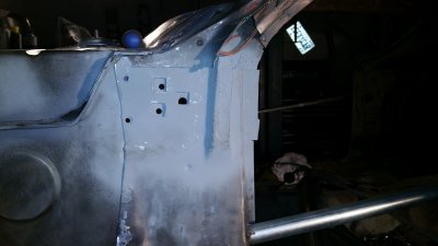

do you think it would be a good idea to install the rear passenger windows while the quarters are off? should i do that first before i weld the new quarters on?

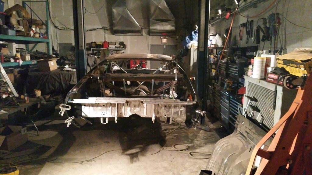

making progress. wheel wells welded on. just trying to line up the floors properly before welding on everything else.
Quarter Windows will go in after the quarters are on so probably best to leave the glass out. The regulators could be installed easily though
