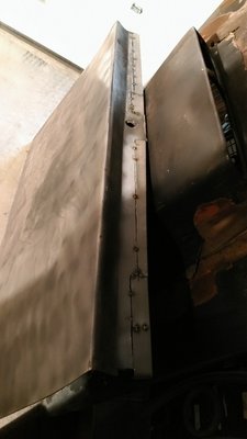

Question. Im working on passenger side door i took the skin off to get inside to deal with rust etc.
Should I seal the inside of the door skin with any type of undercoating or sound type sealent? The tar looking stuff. Looks like factory had some type of undercoating or something. Not sure if I should only paint it and thats it? Id like to limit sound from outside as much as possible of course.
I saw some guys put some dynamat inside door panel, or lizard skin, you can whatever you want I guess to match what you are expecting.
You can put some sound deadening stuff in it.
I put some rust stopper then apply a thick coat of a kind of a metal protector with a brush, then I will probably put some sound deadening in it but know yet what kind.
im thinking of applying undercoating then yea something similar to dynamat under the door panel for extra sound deadening and insulation it has silver on both sides of it
i forget what its called comes in a roll

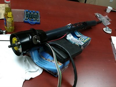

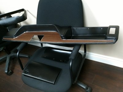

finally got my parts to continue other items been finishing up my dash and steering column and console

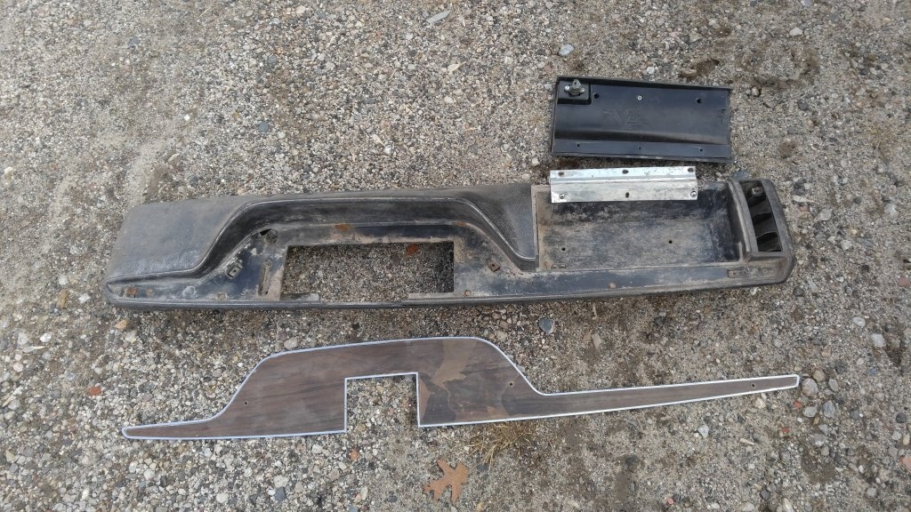

Nice looking console did it look like this before starting? This is one extra I have in storage. You're picture makes me want to fix it for sale.
lol yea mine was like that. def fix it i think they worth decent money

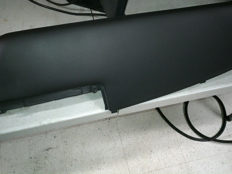

i did semi gloss black there but i gonna do matte black instead
looks like armor-all on semi gloss.
ill take a picture with matte black once done. itll match the paint on my dash pad
Thanks for the info, I think I'll hang on to it. I know year one has the wood grain sticker. Z-Man.
detroit muscle has the wood grain and i think it would be cheaper there
i found year one pretty expensive for many items

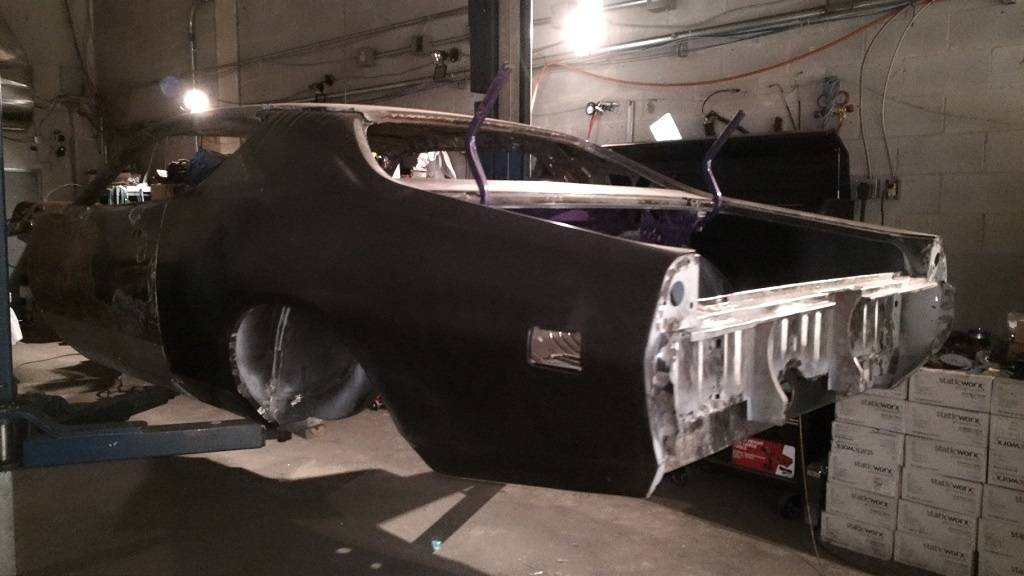

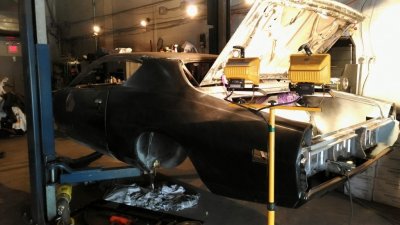

After many months started to weld everything back together
Looking good! On those qtr windows, does the glass set in a U shaped channel? If so, get some glass setting tape. Same stuff used to hold vent windows to their pivoting base.
The door jnteriors were sprayed with the same stuff used inside the trunk on the quarters. Water does get into the door and will drain out the weep holes. When I finished my doors, I poured some Rustbullet into the pinch seam where the skin meets the frame. I got the idea because I spilled some on my floor pan and it sealed a weld seam and was hard as a rock.
fromth
Do you mean butyl tape? i thought they used that for the quarter windows. i had hell of time removing the glass from the channel
if thats what you mean do you suggest i put butyl tape where the pinch welds are? i seperated the skin from the door due to rust to clean it up and will be sand blasting inside. i was thinking of spraying undercoat inside as it looks like thats what came from the factory as well
for the passenger door i will pour some rust stuff as well as i will not be taking that door apart its pretty solid

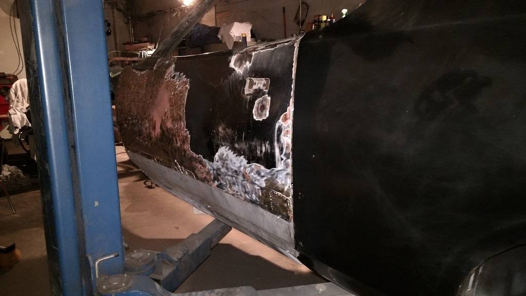

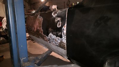

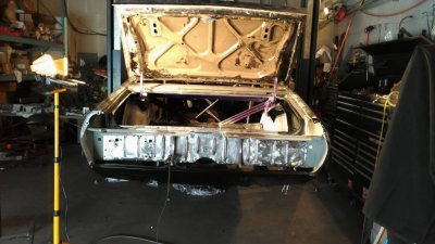

getting there. pretty close to primer.
was looking for driver door but theyre pretty expensive to fixing mine. test fitting the bottom portion.
also fixing the trunk then time for primer. everything else welded on.
