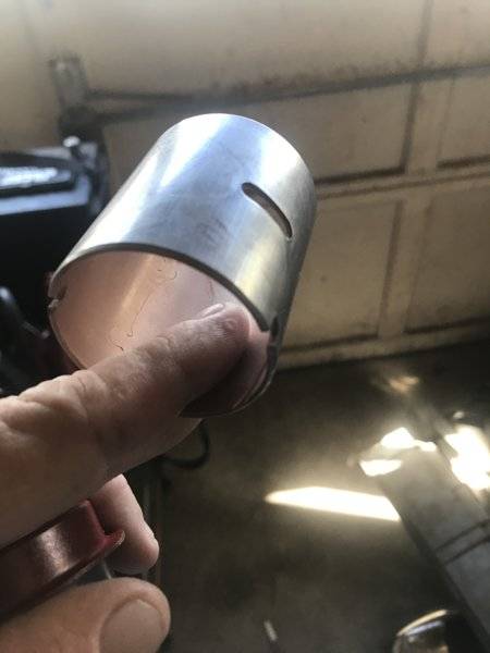

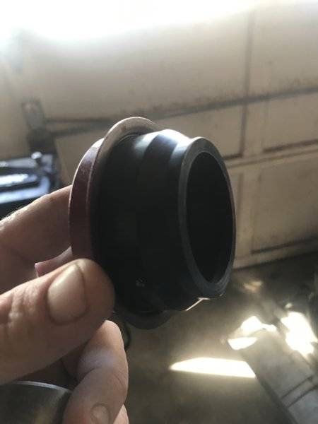

This was included in my 727 output shaft seal box. No info on what it is. It’s an autozone part number 5206. I know what the seal is but what is the metal cylinder?

They are the rear trans seal and bushing that goes inside the rear of the tail shaft. I’m not sure if that’s for a 904 or 727 (also 4 speed).

These folks are telling you correctly - same tailshaft bushing and seal for auto or A833.

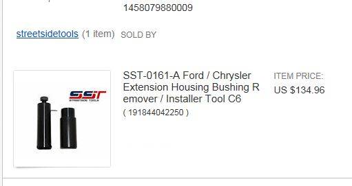

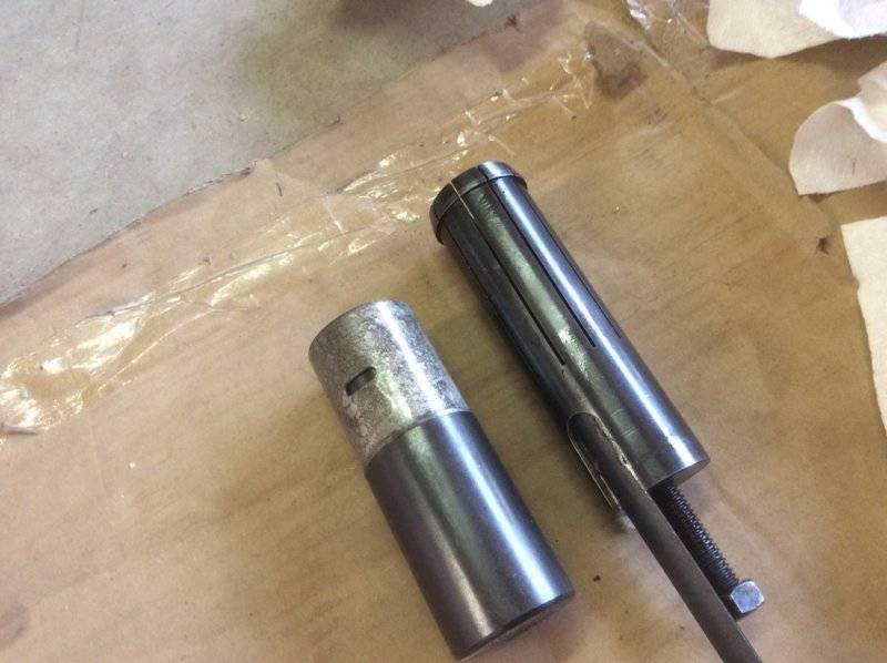

There's a special tool for removing and installing these too - at least there used to be, made by Miller.
Wonderful tool. Wonder if anyone makes it nowadays?

Anyone have the Miller Tool # for that remover? It's not a tough job to pull the tailhousing to replace the bushing. Just take a note of where the window in the bushing is located.
You don't have to pull the tailhousing. You do it with the transmission in the car (or out) just fine, no disassembly required.
