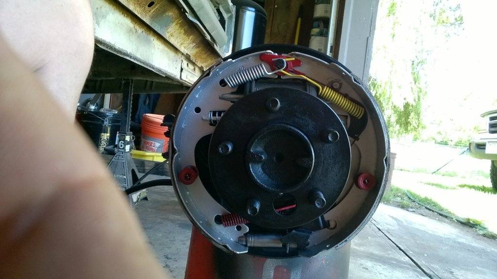

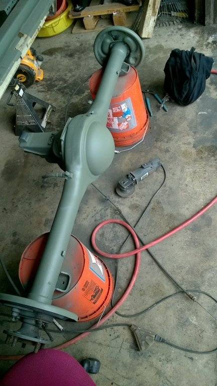

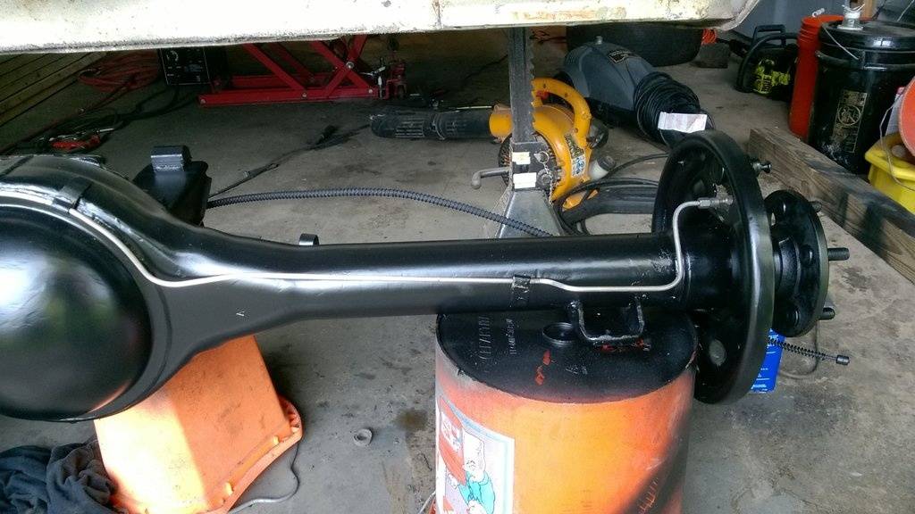

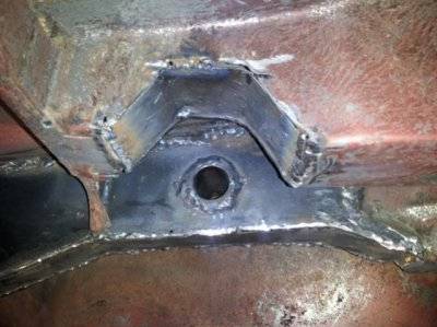

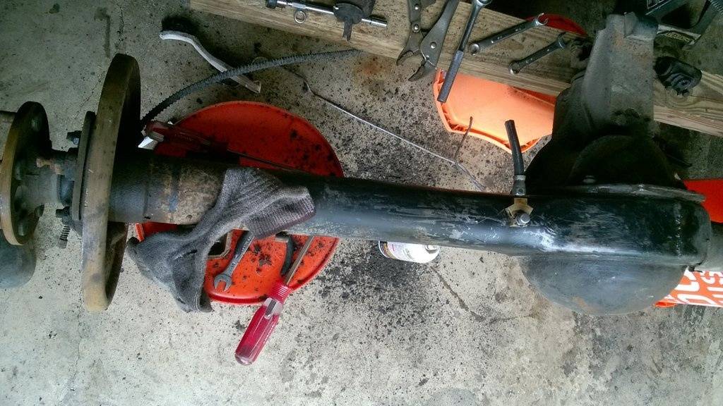

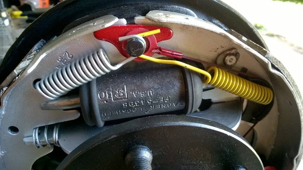

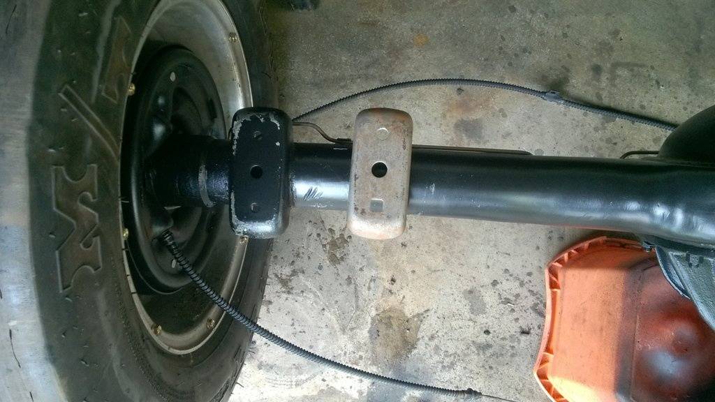

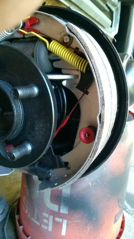

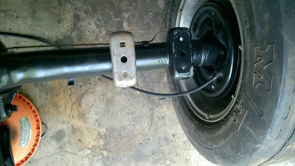

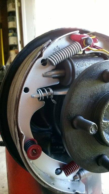

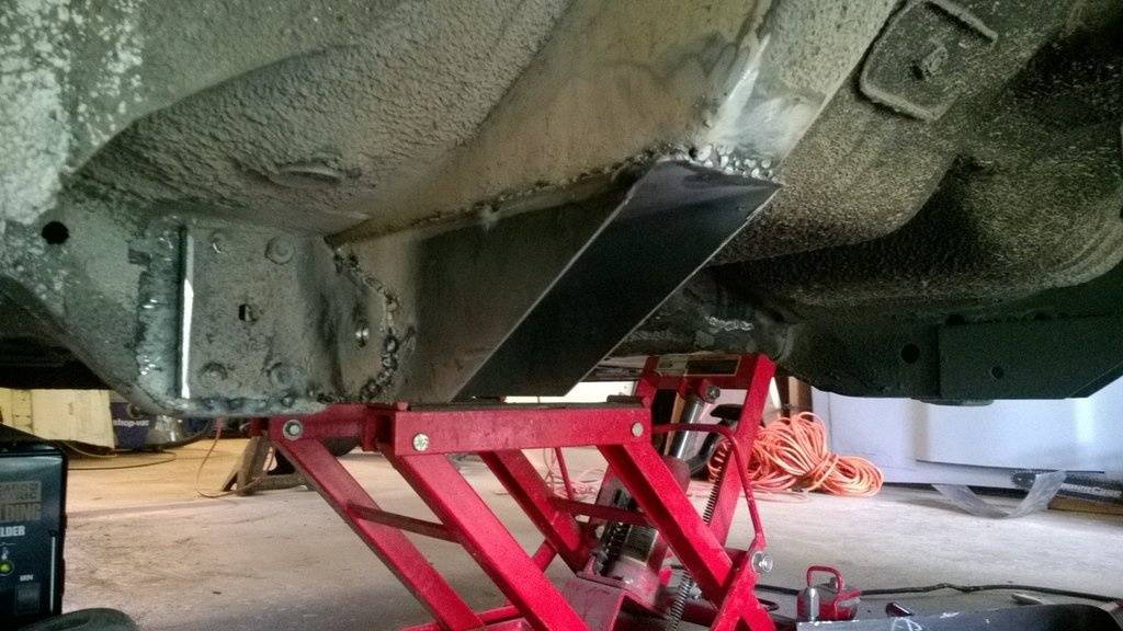

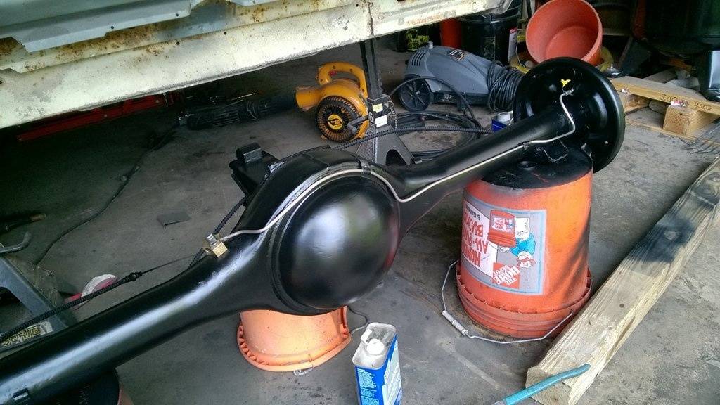

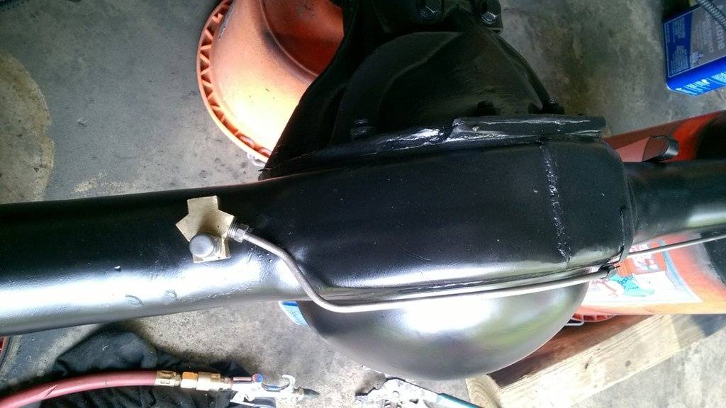

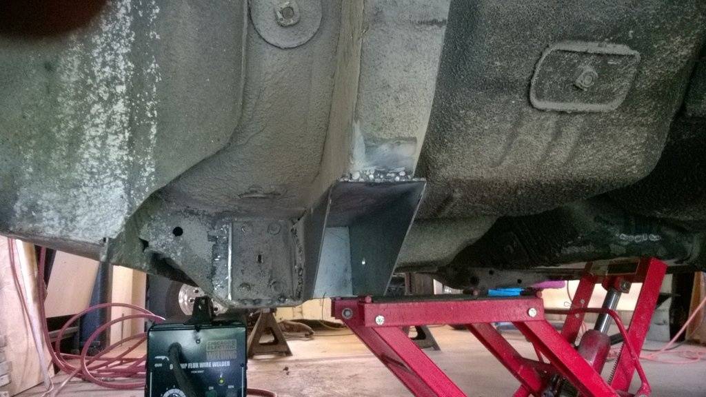

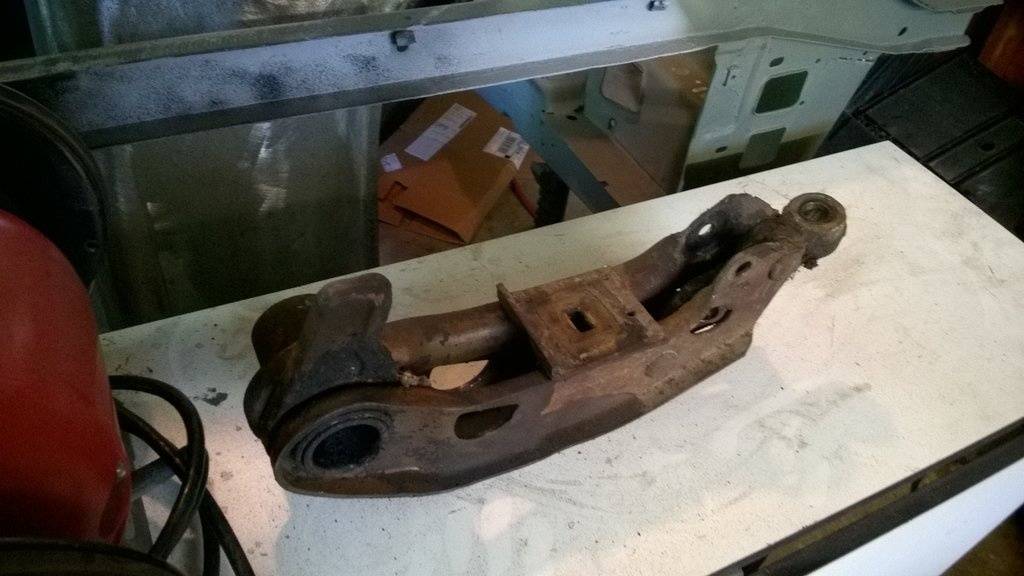

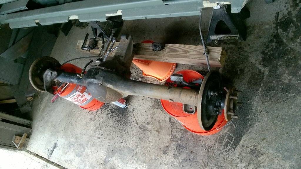

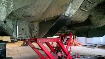

Finished cutting and welding in the left spring relocation bracket. Set the rear axles up to disassemble and clean everything.
View attachment 432297 View attachment 432298 View attachment 432299 View attachment 432304 View attachment 432305
Yep the car is a great place to get lost in workBeen a lot happening the last week or so, lots on my mind..

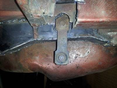

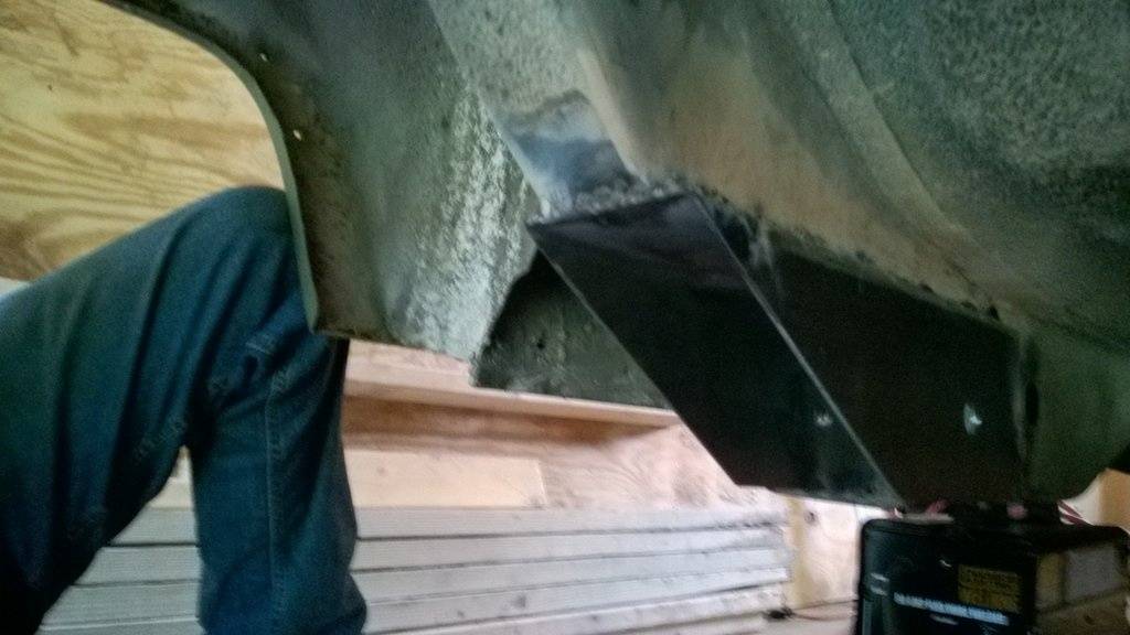

even worse...I set the old spring eye holes next to the front relocation brackets and transferred straight over so they are in the stock location. The rear is the same but the kit came with new shackles. I would rather have sliders maybe? I remember seeing those pics of yours before...What are your plans for the rear point of attachment ? From what I saw in the plans, the "new" hole will be about 1" lower than the original hole, so your car will be sitting up higher than normal. When I was working on my install, I talked to Chris at US Cartools and we came up with a "new design" that allowed me to relocate the new hole at the same height as the old one. I'll try and find pics in my build and post them here . . .

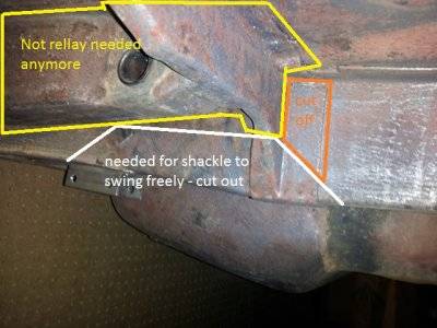

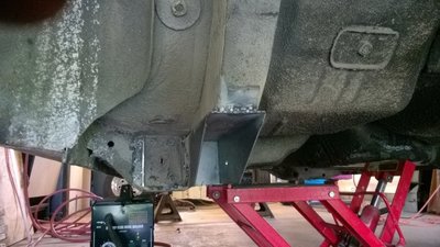

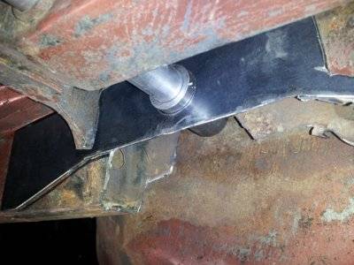

Do I remember you saying u did this because the gas tank was in the way? If so, that's a problem I don't have. In fact there's a square hole in my trunk floor 38"x38".I'm using shackles too . . . but the frame was too low . . . here's a better look at my modifications . . .
Cut away the bottom so the hole will be in the same spot ( height )
Which needed to be done to give the shackle room to pivot . . .
Hope that makes a little more sense . . .
Chris at CarTools said that he has not got anyone else to want this mod because of all the extra time and work required to make it work out . . .
Here's how I made sure they were the same height . . .
The pipe is going through the original hole - and holds the new fabrication in place while I got it tacked into place . . . Make sense ? ?
Right, mine is gone for the same reason. OK then. cool.I added the notch in the original frame member because the spare tire well was in the car - and there was no way to put the shackle in. Now I've cut the spare tire well out of the car, so the notch would not have been necessary . . . oh well - it's done and it'll work. Had to cut the spare tire will out to provide room for my exhaust to run out the back of the car . . .
The end result - the hole location did not change so my car will ride at the same height . . .
