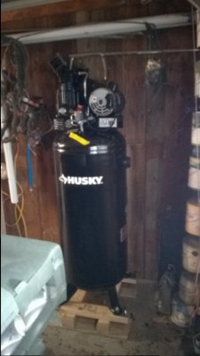

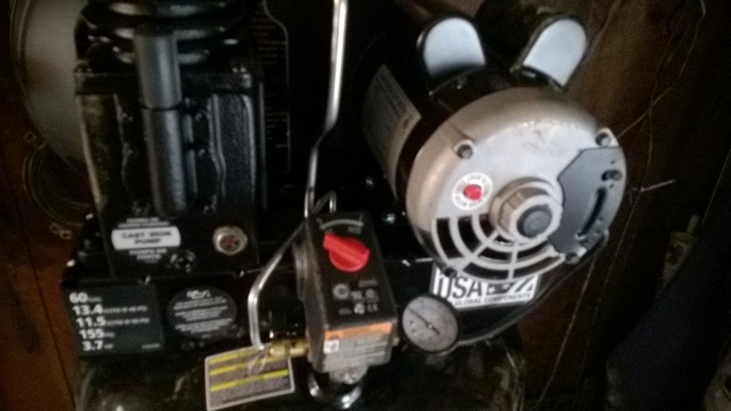

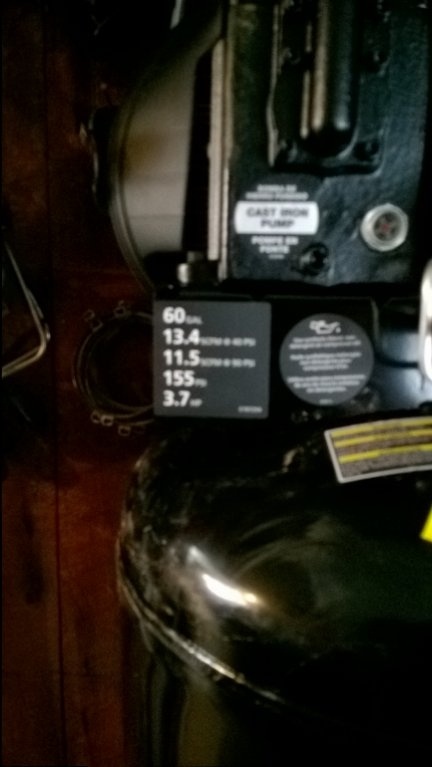

your right.With the air compressor, if you double the tank size but not the pump size. The pump likely wont be able to build up to your cut off pressure and run almost constant. You would wear out or overheat the valves in that pump quickly.

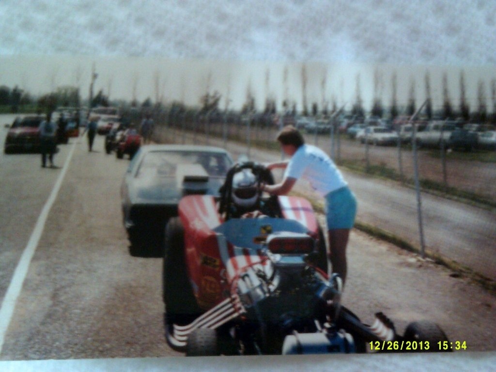

here's one I had for a while it's a Hilborn 4 port & a BBC
mech. FI

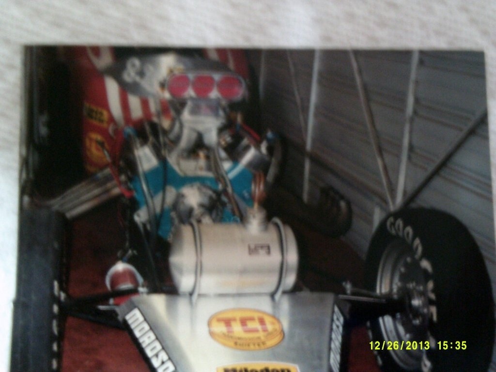

here's a Enderle Bug Catcher Hat on an Edelbrock Tunnel Ram
mech. FI on my old 23 Altered

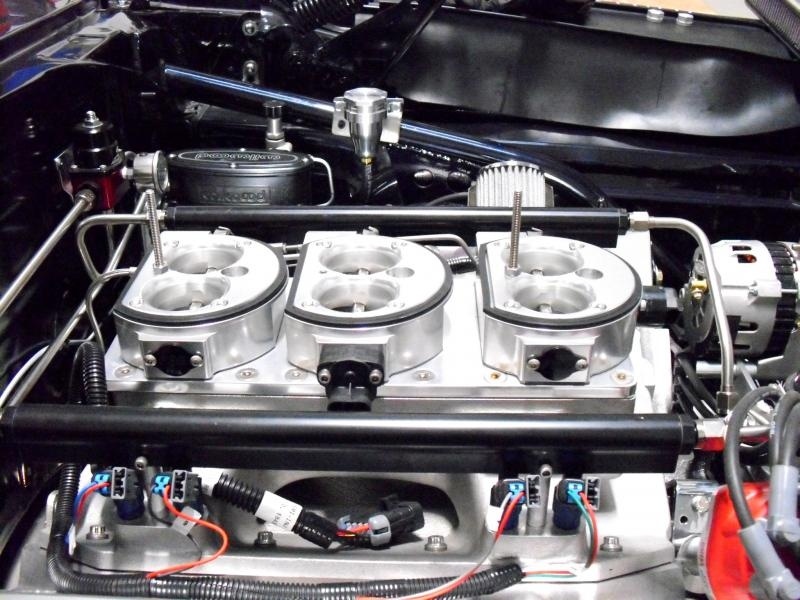

6bbl efi

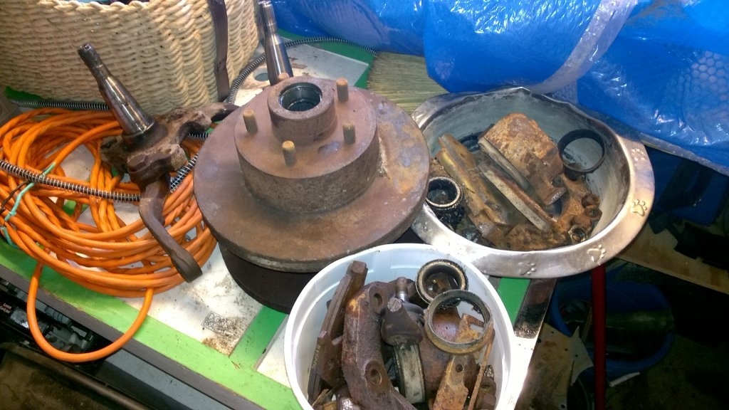

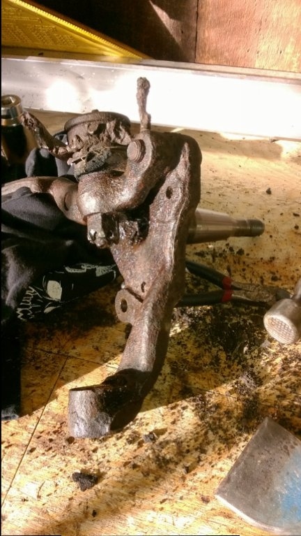

The hard part is done. Next is the rear end and leaf springs. Got wheels and tires on the way so time to get busy.Fun stuff, those don't look like much fun to get apart at all.
