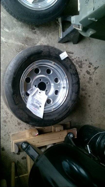

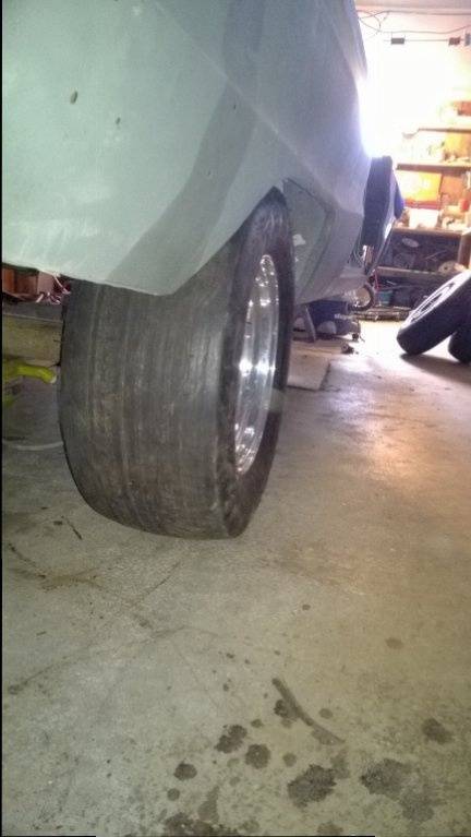

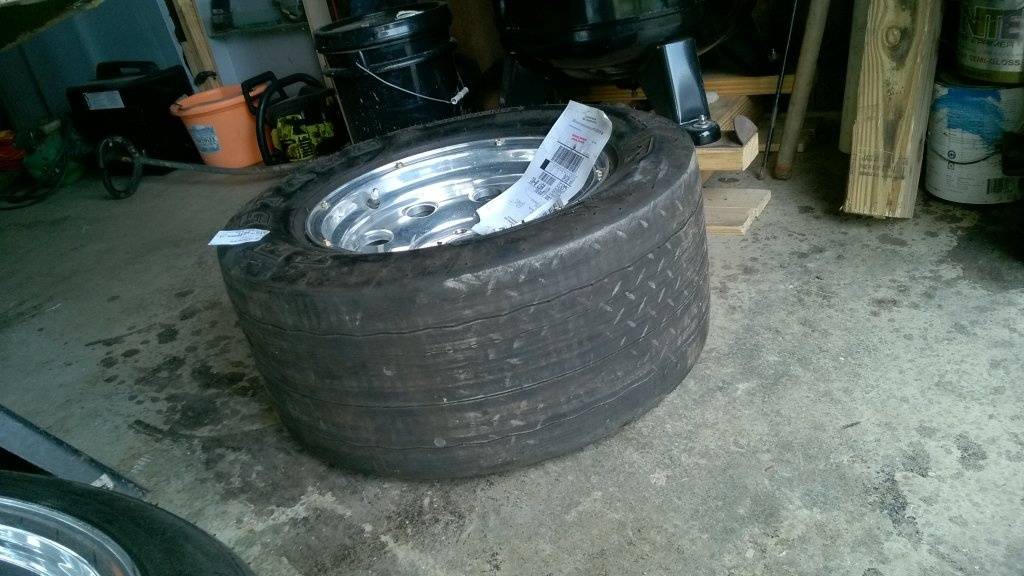

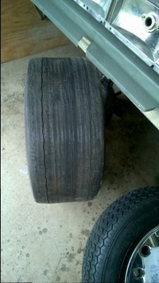

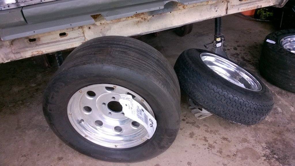

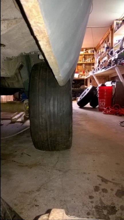

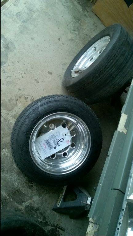

The fronts are Weld Draglites 15x7 with M/T Sportsman's 26 x 7.50 x 15 and the rears are Centerline's with M/T E T Streets 26x 11.50 x 15's.

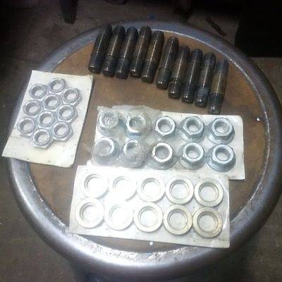

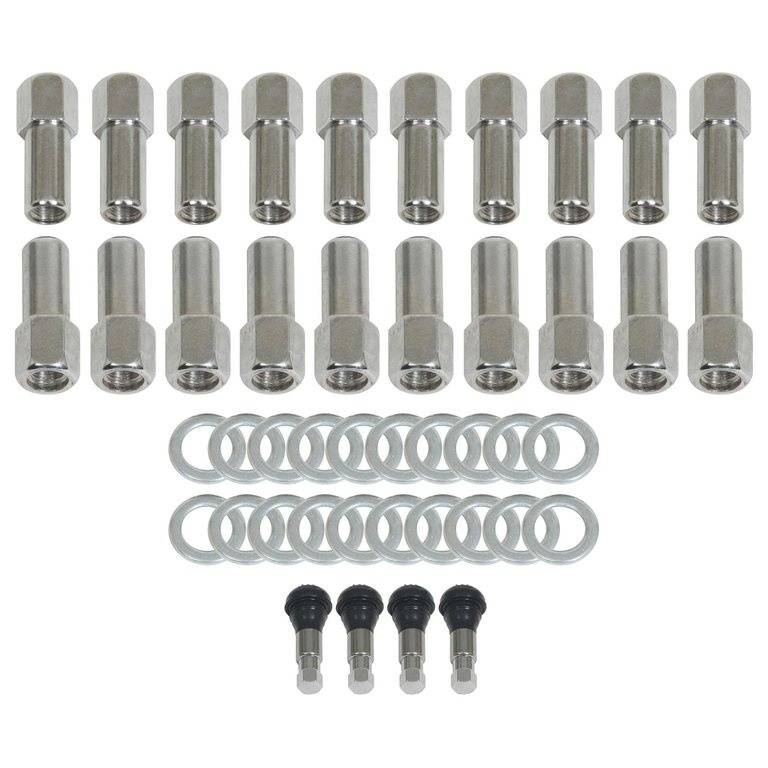

Yes, the pattern is good. The fronts are so thick in the middle though, the studs don't even poke all of the way through with the disc brake rotors.Everything fit ok?

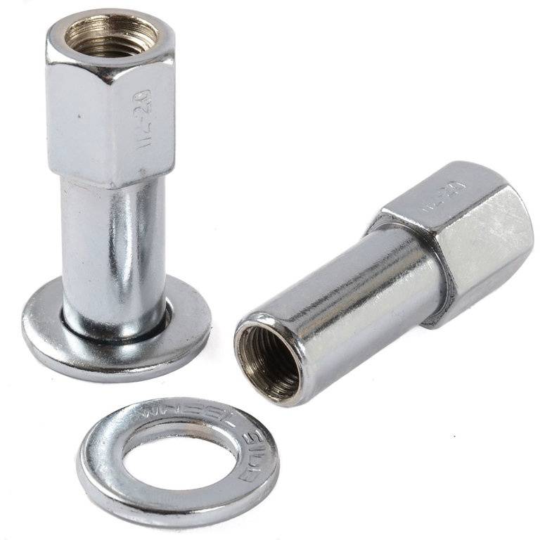

Forgot to mention that they used the long studs, I wanna say they are 4-5" I still have them at the shop I'll be there in an hour and measure what I had on there.How long of studs are there available and what's safe?
They are 3.5" ARP studs I had on mineI was going to ask that very thing!

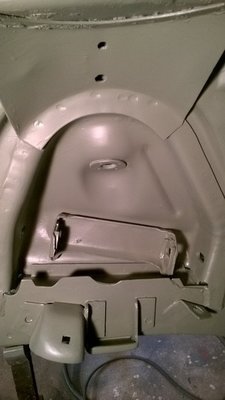

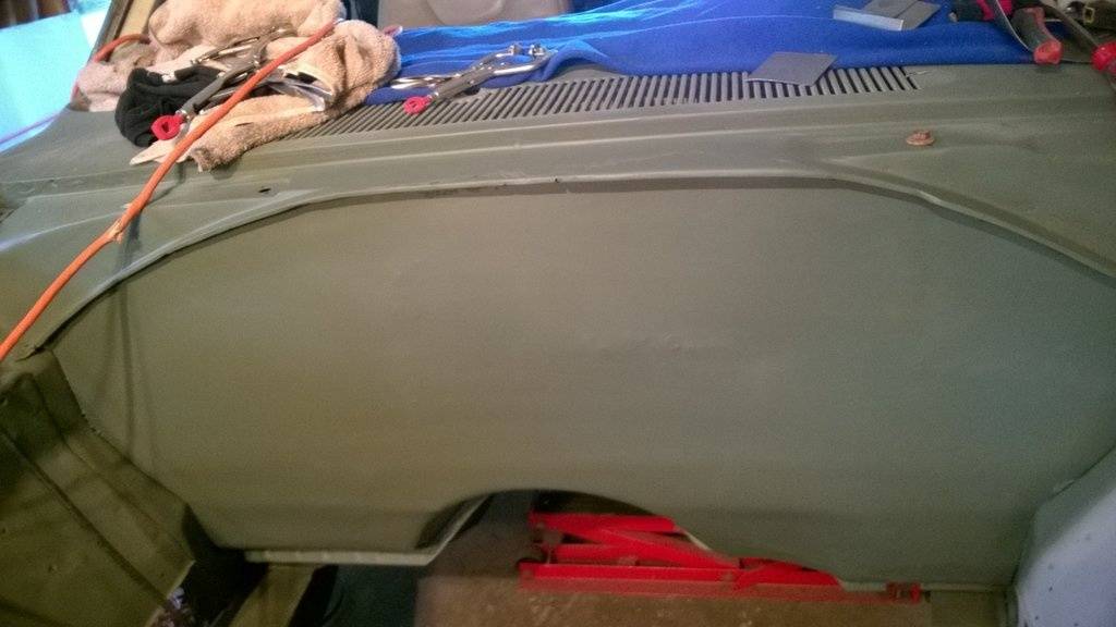

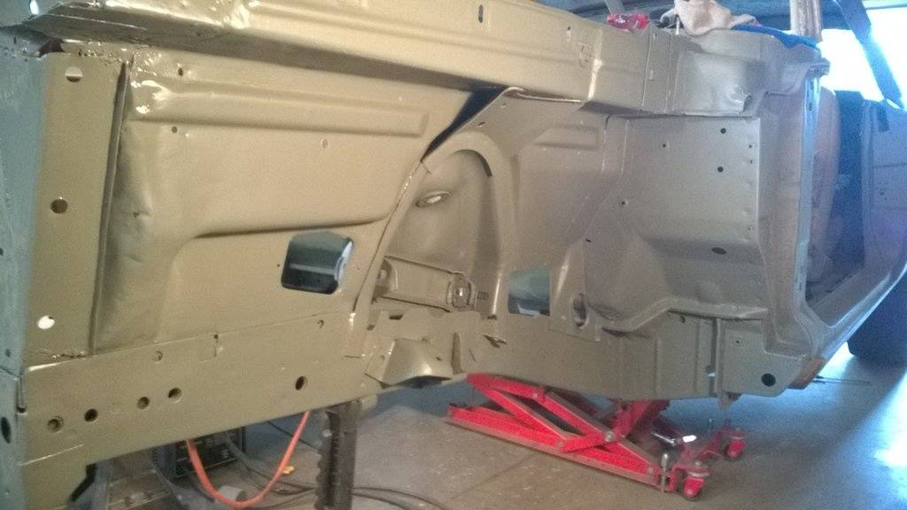

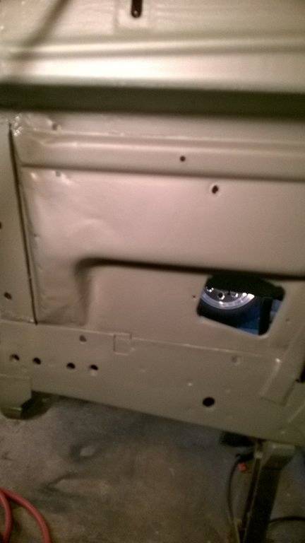

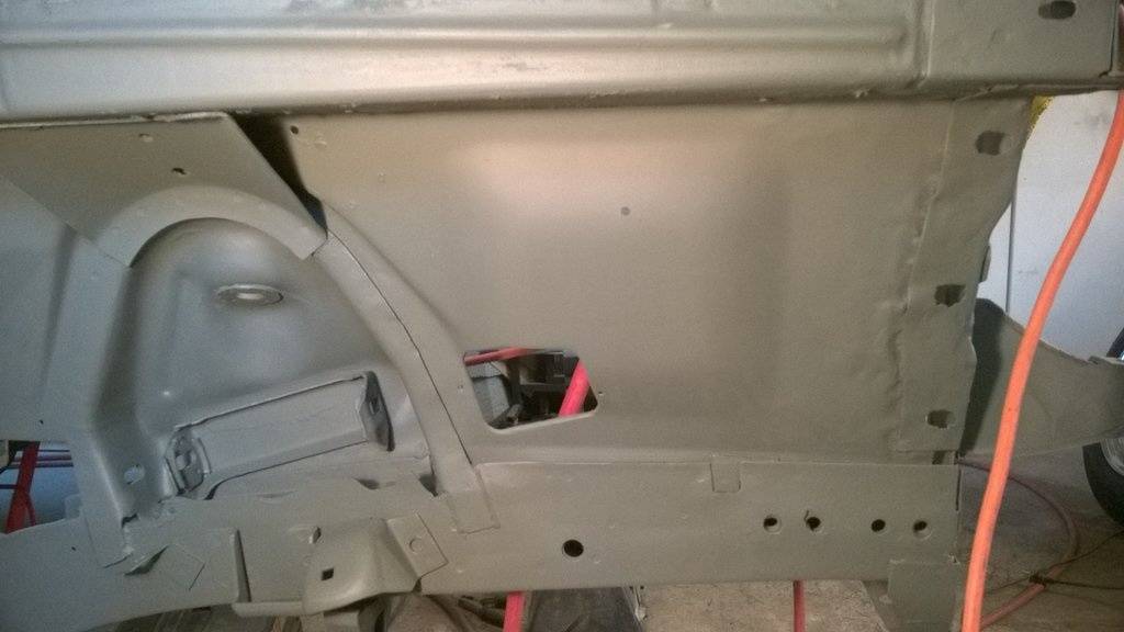

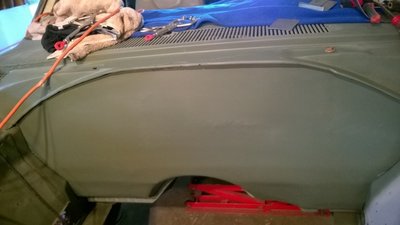

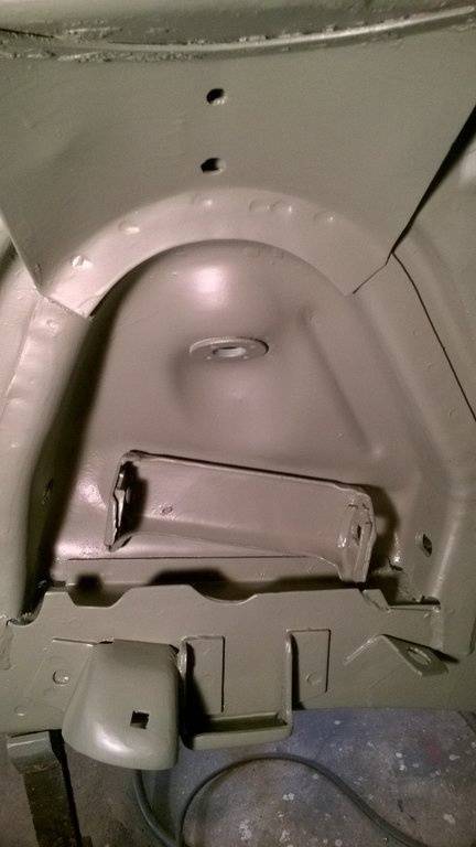

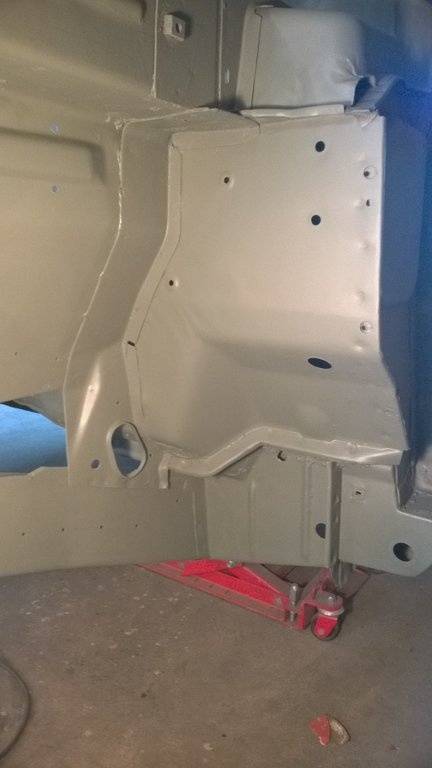

Looks good so farFinished cleaning the undercoating off of the wheel wells in the front. Grinded them down to bare metal and then hand sanded the tight spots. Finished in self etching epoxy primer. Made some small 90* angled pieces to go up under the cowl lip and rest against the smooth firewall so I could finish welding that in place. Finished it up in the epoxy too.
So, the front end is done. Moving on tomorrow to the rear.
