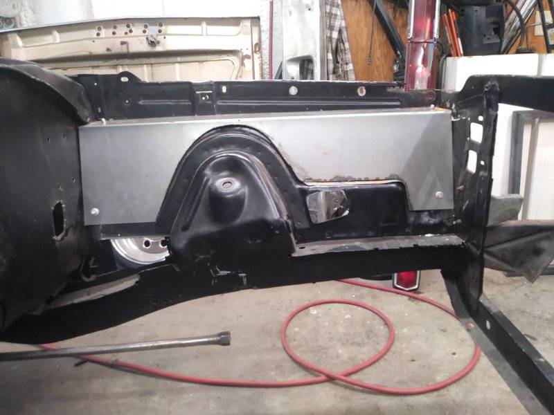

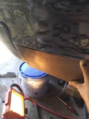

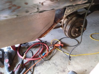

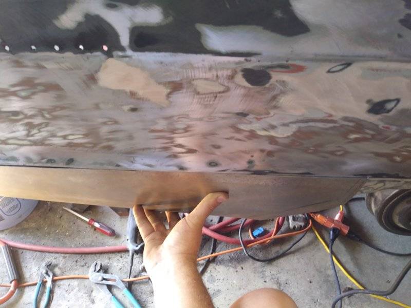

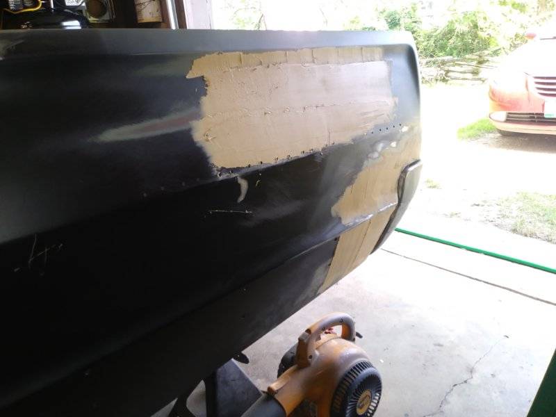

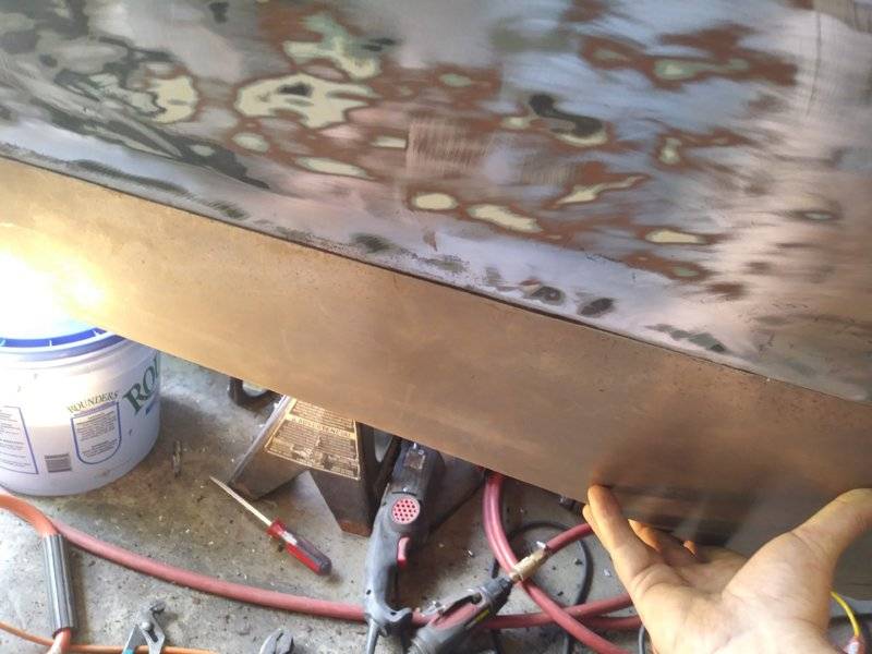

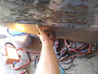

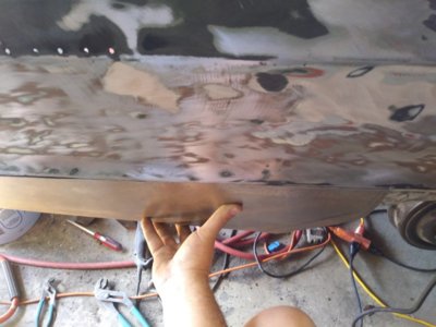

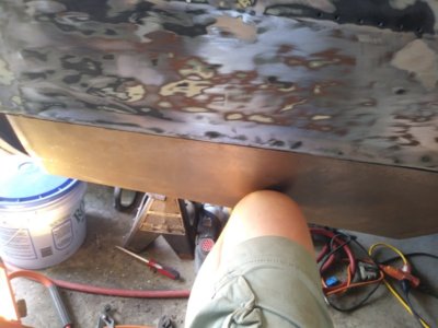

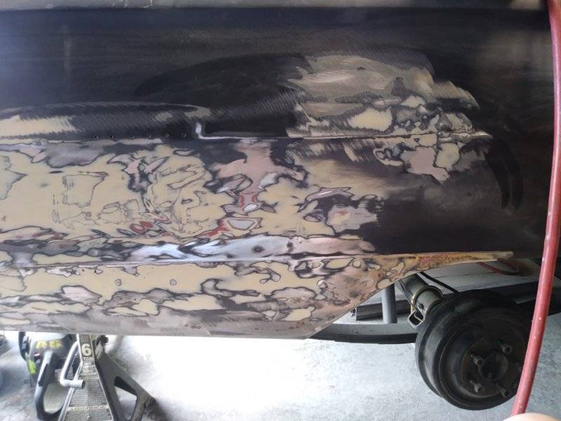

Decided to replace the lower rear section of the right quarter. That side had been hit in the far past and was the most bumpy and holey and rear most portion was rolled inwards instead of the gentle curve and straight line of the bottom edge. This will make the bumper have to be modified again, ( BFH) so the profile will match the new sheet metal. lol. My goal is to have less filler, not more.

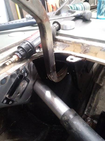

I use copper pipe fitting and flatten a little, hold with vice grips. the copper gets real hot.

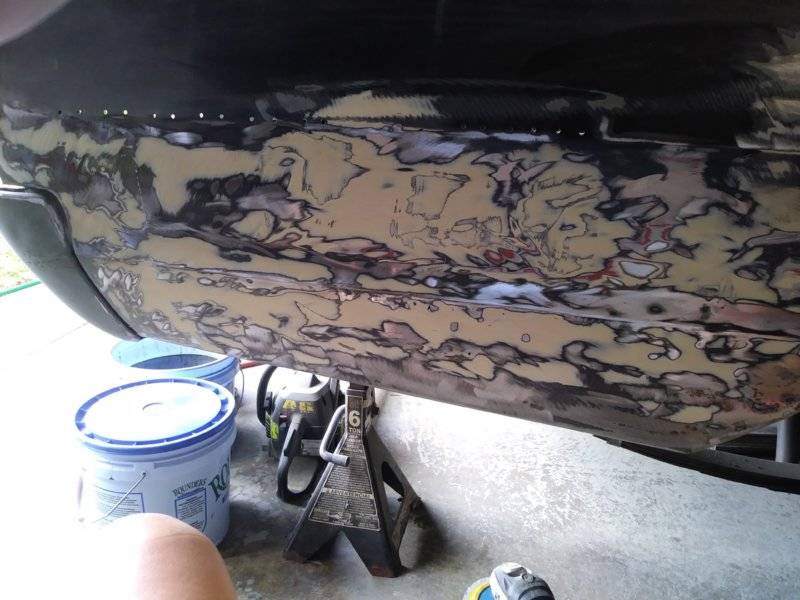

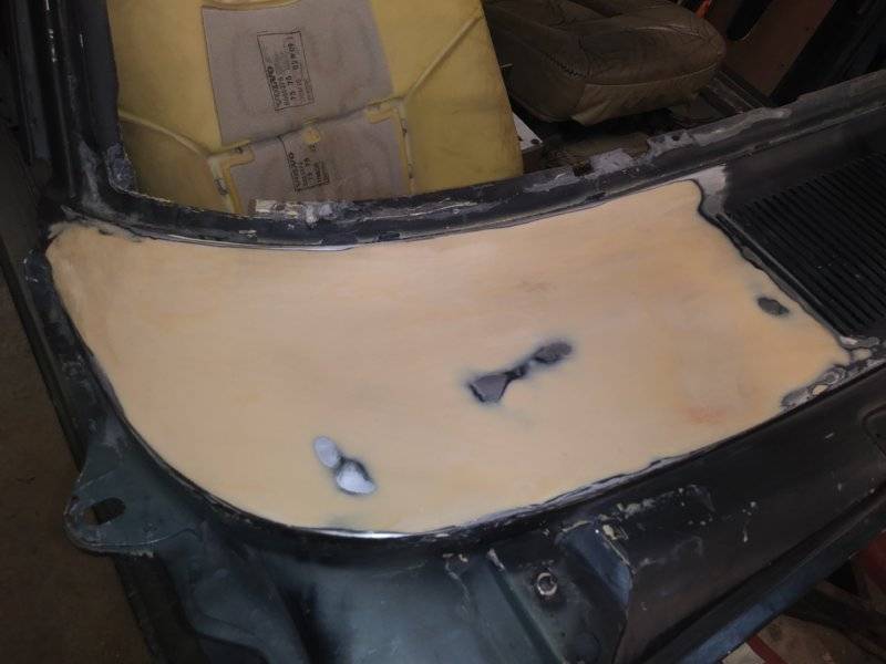

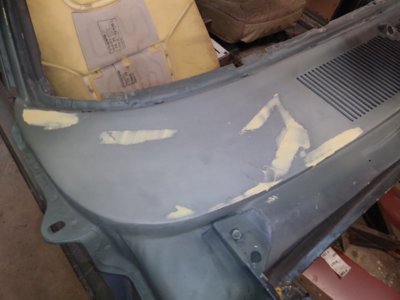

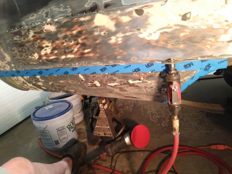

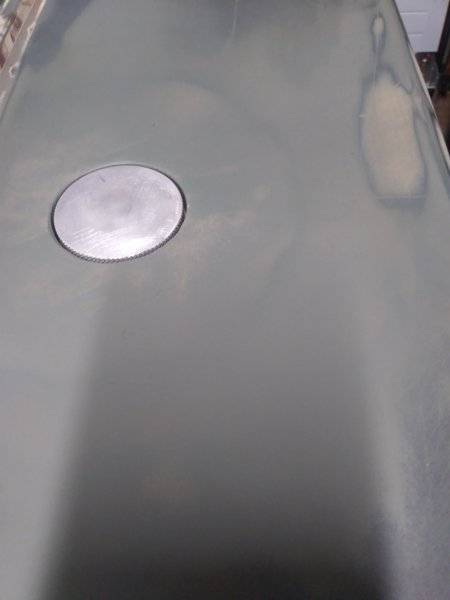

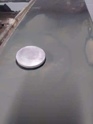

I know, right? I said the same thing to myself after sanding them down to that point. Pretty cool looking from an artistic viewpoint! Should frame a pic and sell it for millions to some rich idiot in NYC!Ghost . . . These ( 2 ) pictures look so cool . . . I'd be tempted to leaved it and paint clear coat over it . . . ok, never mind . . . LOL . . . it still looks really cool ! ! !

GotchaI have tried that in the past and it worked ok. I find that I need both hands to do a good job with filling the holes quickly. I'm just not dexterous enough to hold one and weld with the other. Especially inside quarters and door bottoms.
