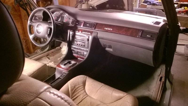

Soo...I have sourced the wood veneer, the polished wire accent line and round chrome AC outlets and the fabric. Should I buy some MDF and build the body of a dash like this and get to covering it? My Audi dash is the same profile across the top.

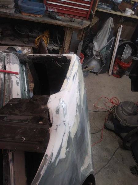

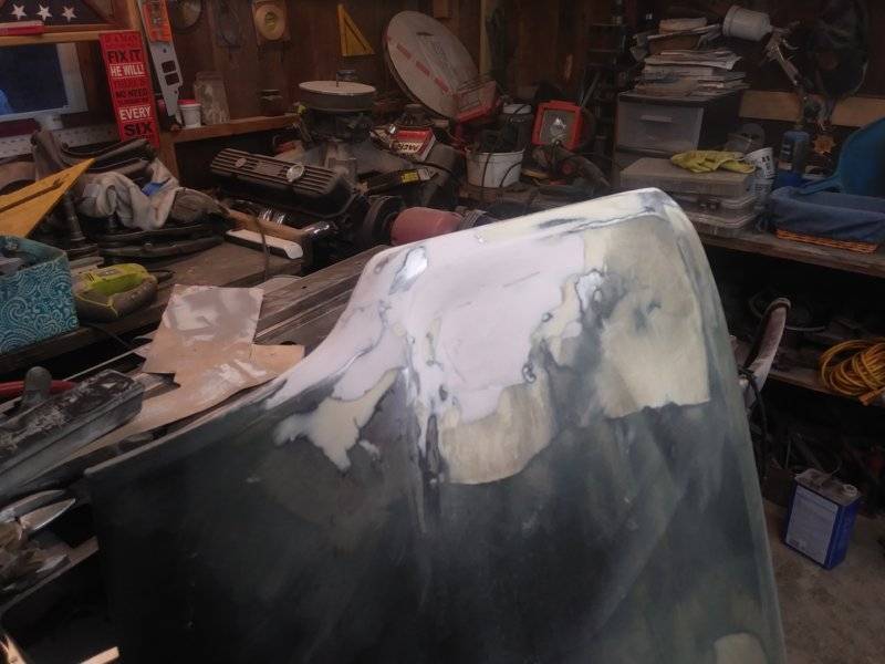

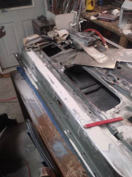

Got out there for a bit and welded up s problem area on the front of the left fender. Slapped some Bondo on it to finish up. Letting it dry. Sanded down and applied filler to the bottom inside panel where I had cut a piece out trying to mount those Audi CD changer/storage bin units. Needed to get that looking presentable again.

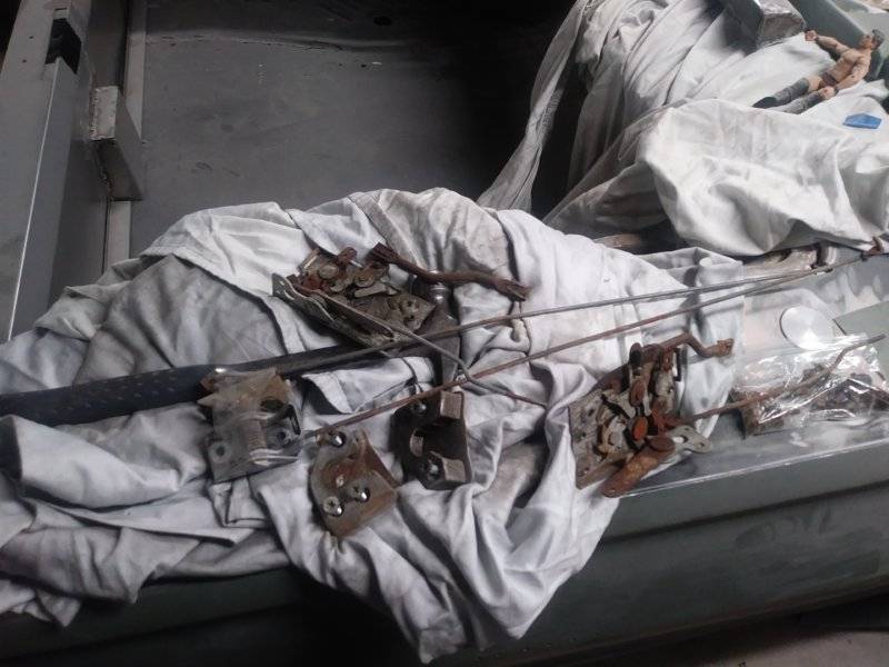

first pass done on both. Got the door latches and hardware in the mail from FBBO member Mopar_Mike.

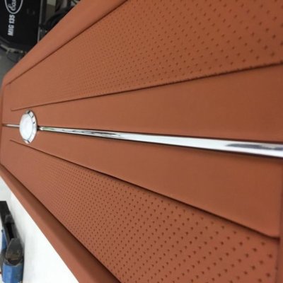

The door card will be split into three sections with the center section being perforated leather. The color is Ultra Leather Adobe. There will be 3/16 depth between each section. the lower section of the three will have a chrome trim line ( reusing the rear door panel upper door card trim) that is indented 3/16" in the center of that panel ( left to right) beginning from the rear edge of the door card and extending towards the speaker grill. About 6" or so along that line of trim there will be a oval Edel Italian Luxury Yacht Deck Light trimmed in chrome that is centered over the chrome door trim.
The pic below shows the idea of how that will look although it has a round light on it. The speaker grill will be black. The door armrest will be recolored in black. The dash top will be recolored in black down to the top of the wood grain insert line. The A/C vents will be removed, the wood trim removed leaving a long narrow 3 1/2" section all across the dash from door to door. This will have a fabricated 3 1/2" panel with a slight curve (bow out) all along it and covered in a wood grain veneer sticker. I will place a "CORONET" script on the right end, centered in that narrow panel.

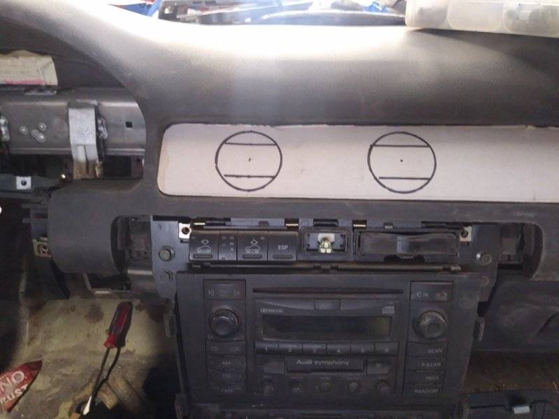

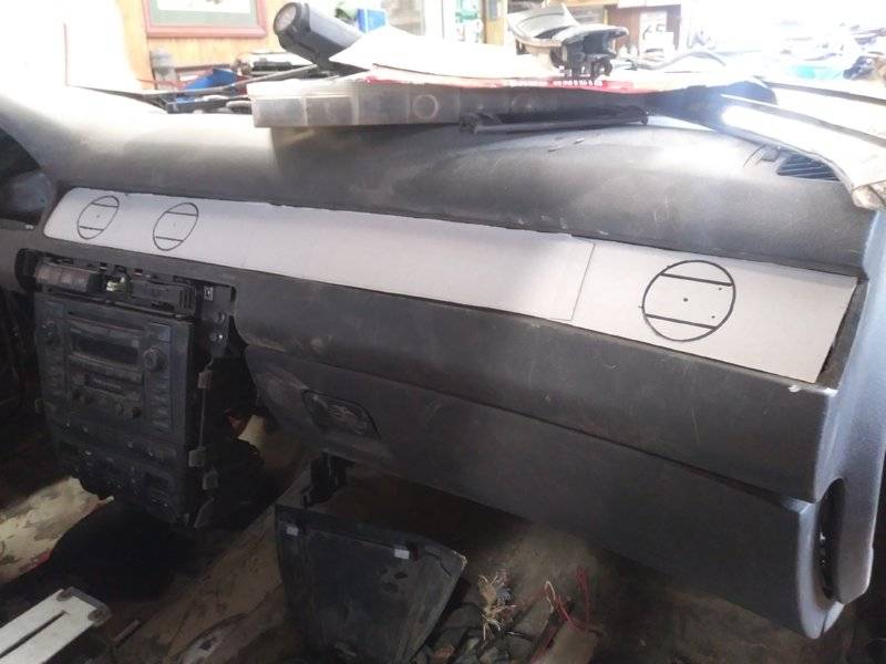

I have sourced the dash AC vents. I needed a smaller size ( 2" tops) and there are few out there. I found the NANO vent from Restomodair. 1 7/8". Billet aluminum. Sent a request for drawings, pictures installed.

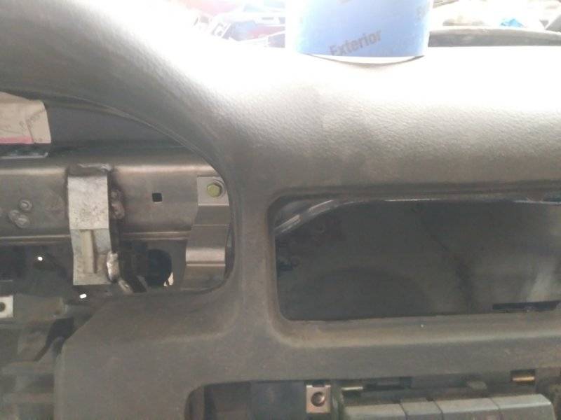

I removed the vents and trim and cut a template to lay in there to see how it might look. I like it...

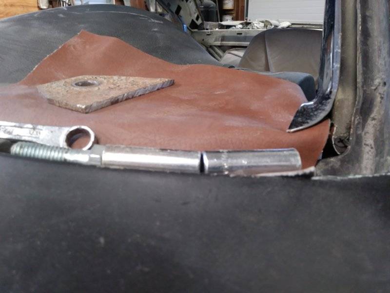

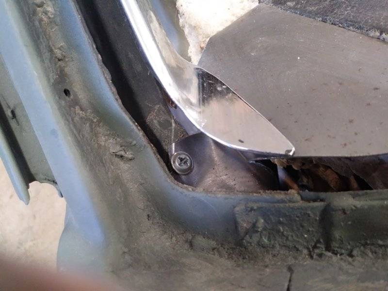

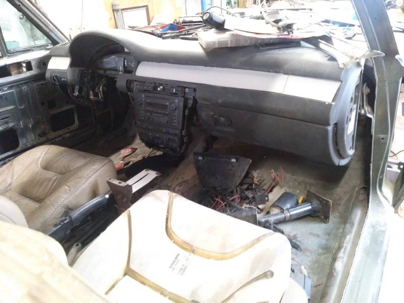

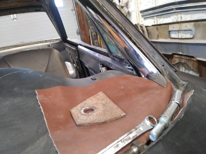

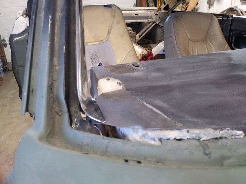

I also finally worked out the shape and installation of both corners of the dash top. I cut a plate out of 26GA and fooled around till I got it how and where I wanted it, in relation to the A pillar trim. It will look ok when the windshield is in and the dash is recovered. Never know there were holes there. I left the plate about 1/16" lower that the surface of the dashtop so I can smooth over the transition edge to hide it under the new leather when glued down.

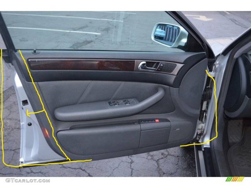

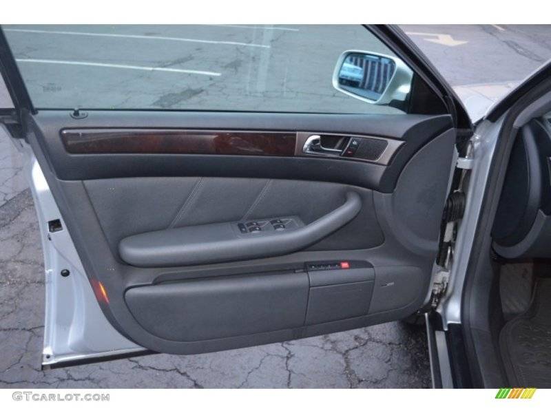

Just ordered these door panels from Nebraska. Going to try again to be creative and get these damn doors right. I may end having to tilt the dash shell down 1/2" to get the door sections lined up with the dash ends AND...AND...have the top of the door panel parallel to the top of the Coronet door. Don't want to, but may have to. Dang it...doing so will rotate the console section down as well and I like it where it is.

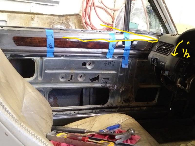

Here's the problem. The top yellow line is the angle the Audi door panel is at if lined up perfect with the dash end. Rotate the dash down 1/2" to bring it in line with the door. Solves a multitude of issues.
Each end of the dash aluminum frame is mounted by a triangle of 1/2" bolts that anchor it to the welded in supports. Pulling two bolts on each side and rotating down, marking the new hole locations and drilling is the deal. Two reasons I don't want to do it. 1. It's a pain in the *** to take the dash all out to drill those holes. 2. I like it where it is. Although, truth be told if I had done so to begin with it would be done a long time ago...

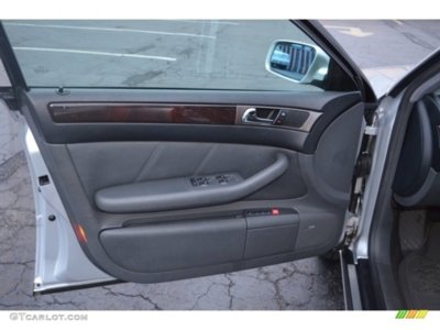

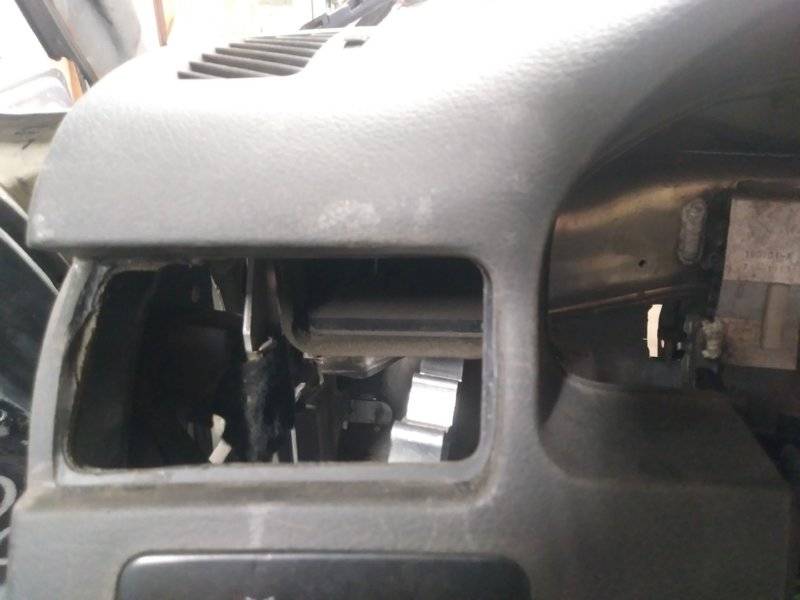

This is how they are supposed to look in order to match up with the dash..I guess what I'll do is slice off the rear vertical edge of the panel top to bottom and move it to the rear of the Coronet door panel. Then strip out the leather panel behind and around the armrest. Then I will build up the space in between the two pieces to the same level across the gap and then lay down fiberglass to join them. The same needs to be done on the front lower corner to match up with the Coronet doors more rectangle shape. This also takes care of the door speaker as it's already in the panel. Everything below the top dark grey section is going to be painted or upholstered in a rich Adobe color so it will all be hidden from view. The thing I don't like about this plan is that the door panel is thick, like 4-5 inches thick and it leaves precious little room between it and the power seat controls. Guess I will have to live with it.

Well, this is exactly what I tried to do, before I cut the original panels apart to then try to incorporate sections of it. They really just don't line up and it's very obvious to the casual eye. The angles are all wrong. I have tried everything else so this has to work, I'm fresh out of more ways to get this doggie roped and hog tied..lol. You are right, this is more work, however, the end result should look like it's SUPPOSED to be there..which is all I want at this point.
To the issue of rotating the dash which changes the position of the console, all I can say is that the console body and frame right now is like 5-6 inches above the tunnel. So there is room to go lower but it will end up with the console at a diminishing angle as it goes towards the rear. I have yet to see how much of an angle. I'm actually dreading it.

I rotated the dash down today. Didn't have to go too far. Still looks good across the top. Going to work out! I will wait till I have the panels before I drill new holes though...
