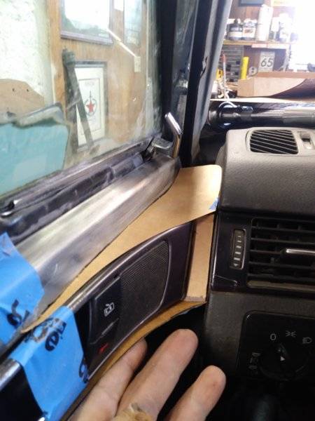

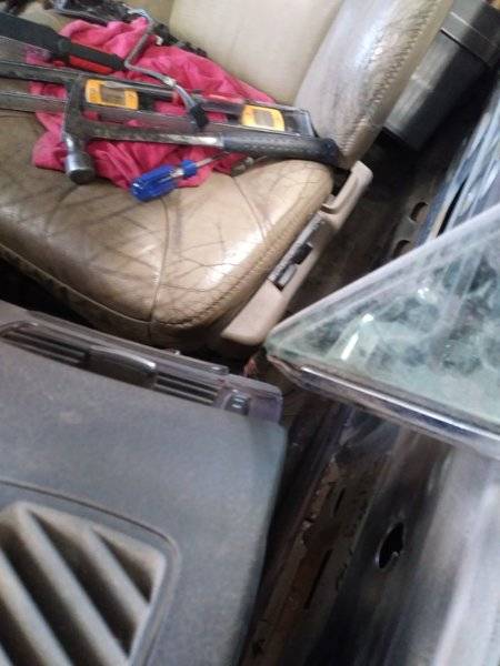

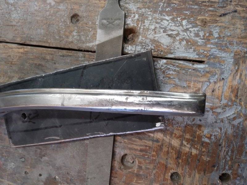

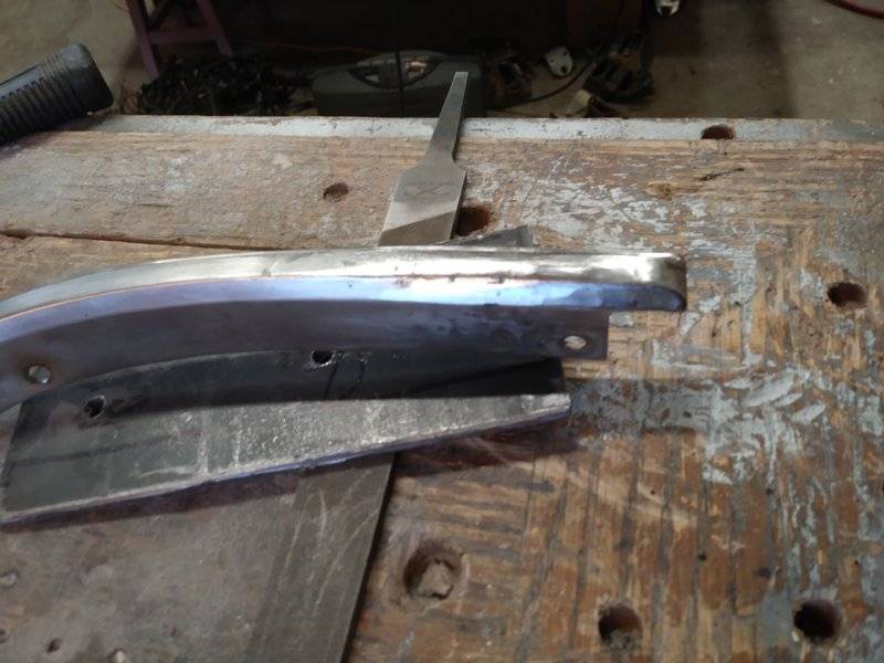

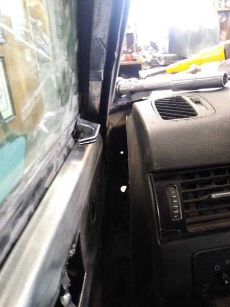

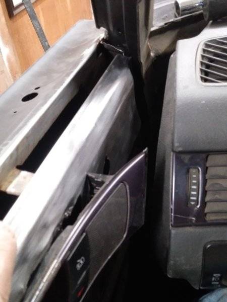

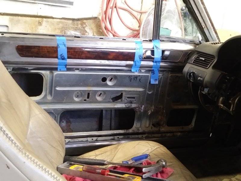

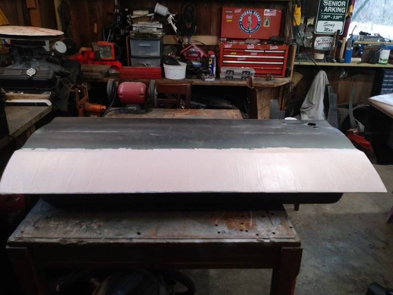

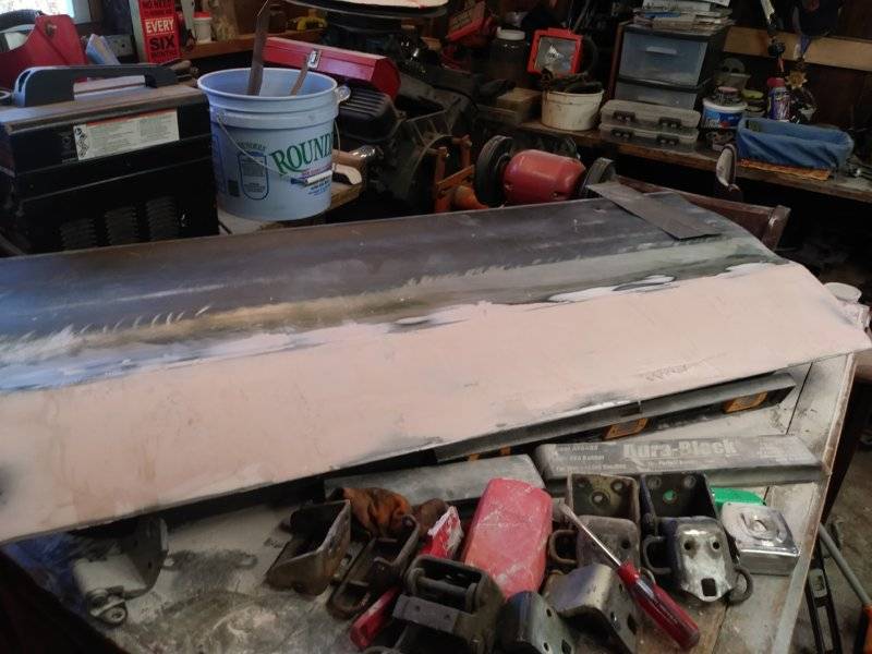

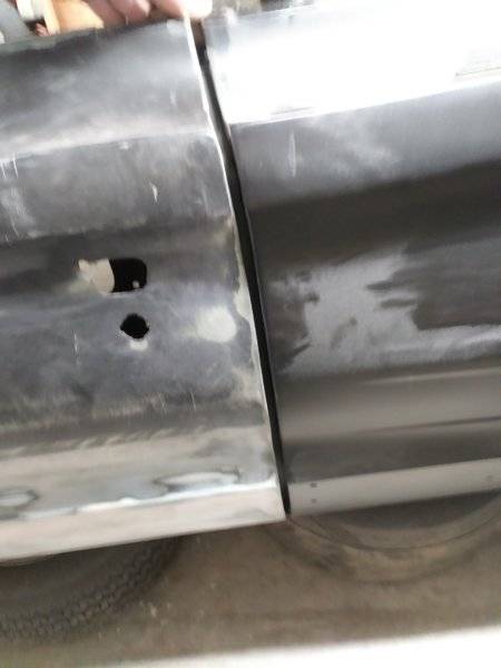

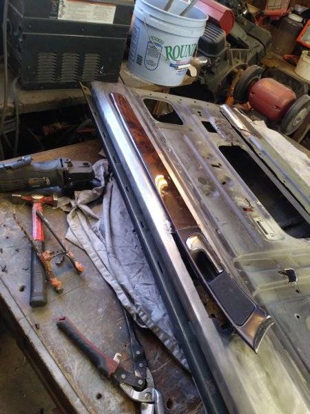

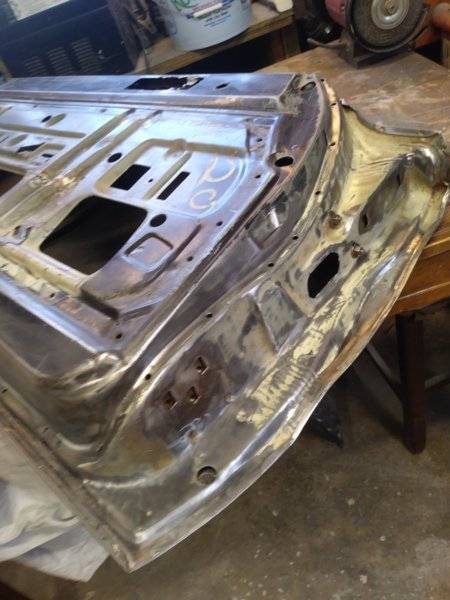

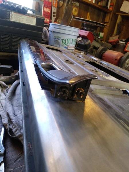

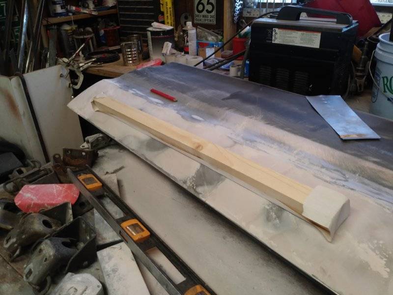

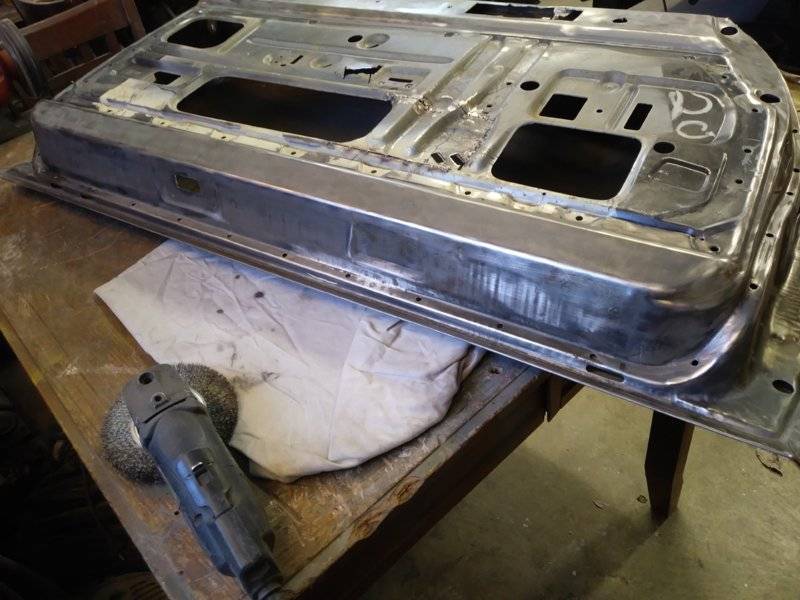

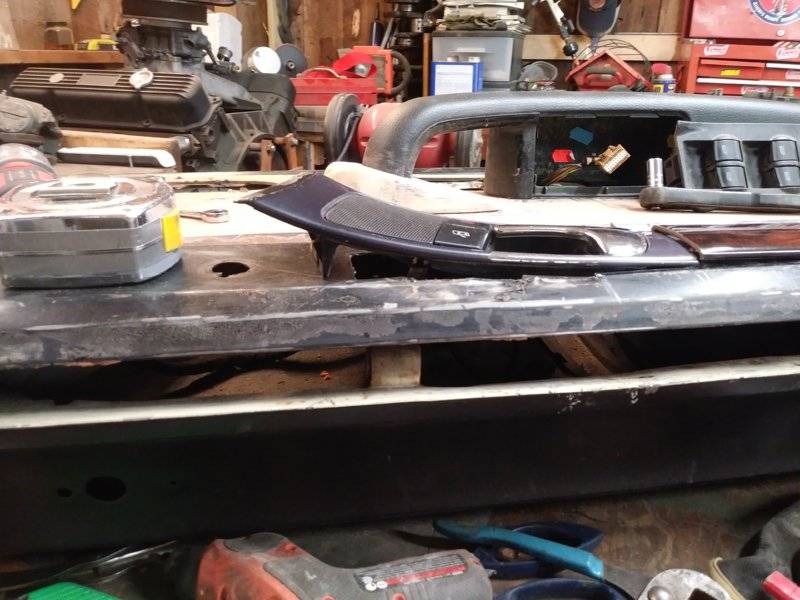

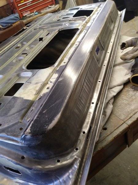

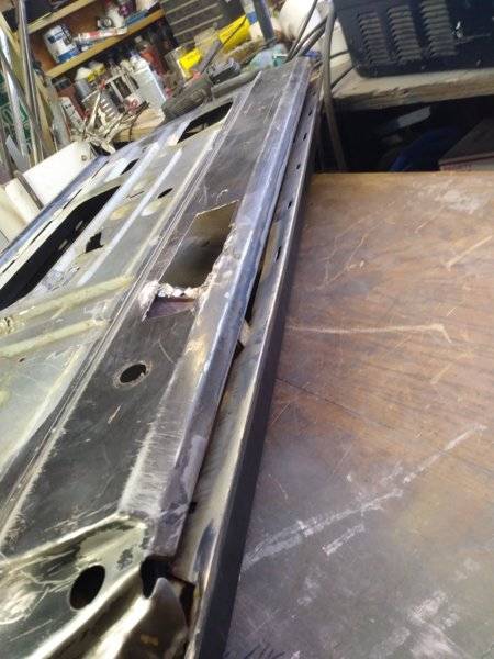

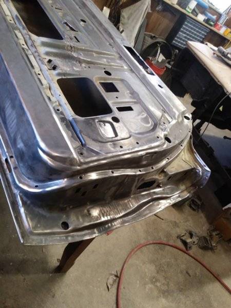

Welded the trim holes closed on the left door and primed with epoxy and now have filler on it to even out the low spots from my quenching the welds.
