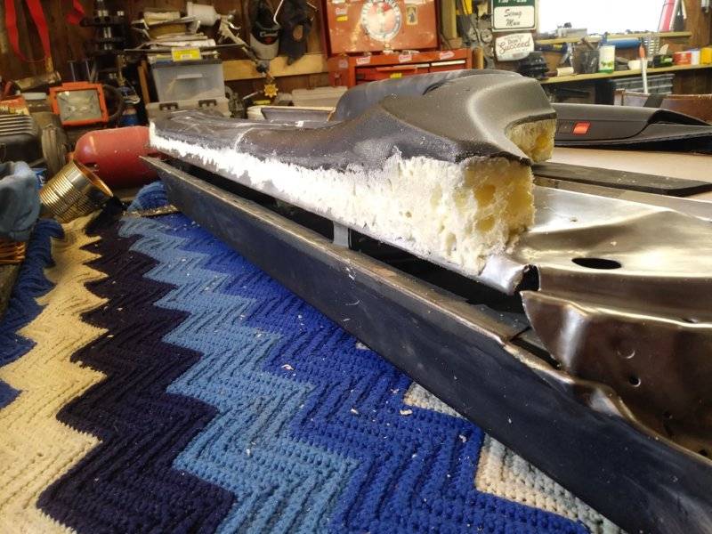

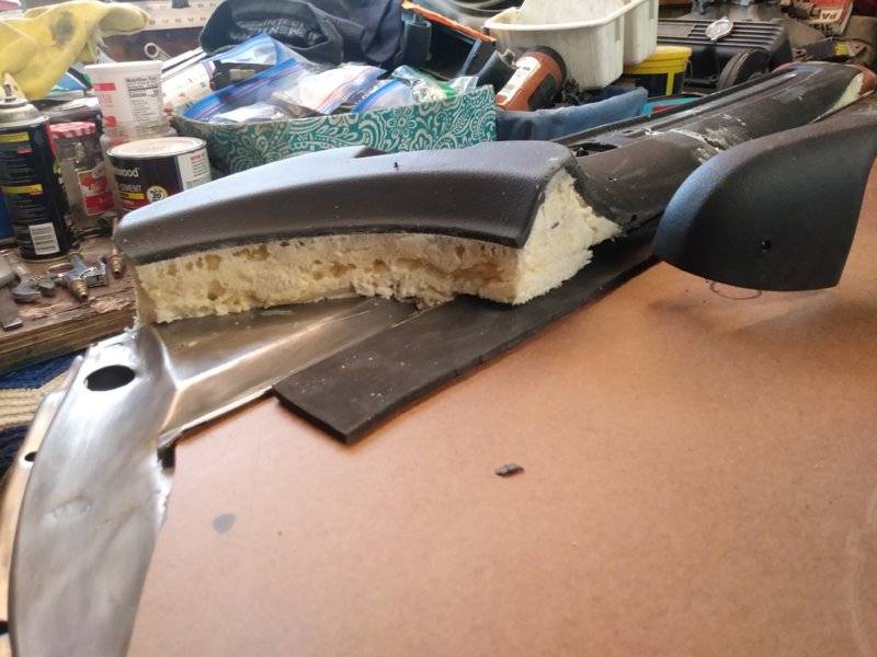

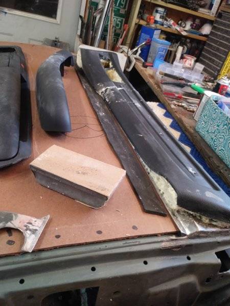

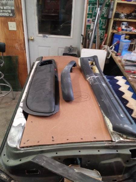

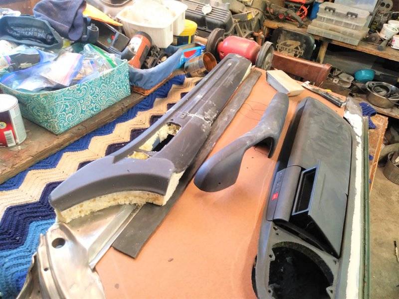

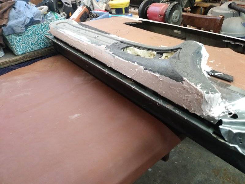

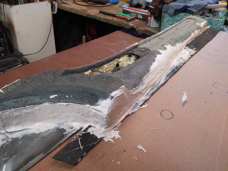

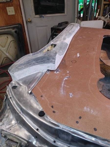

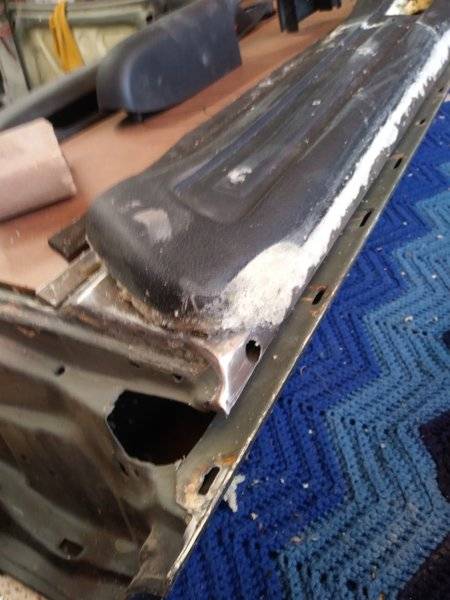

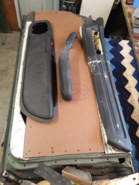

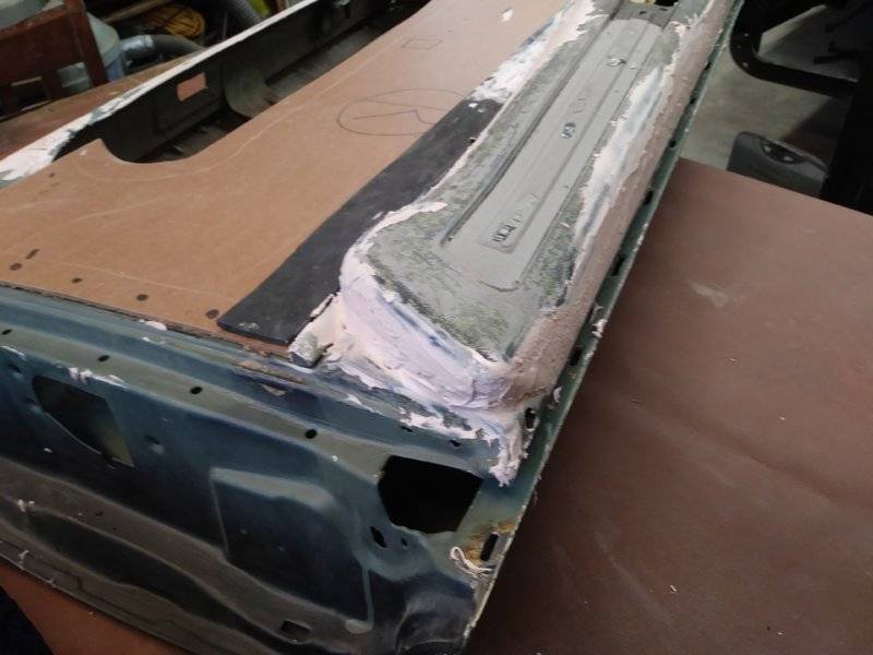

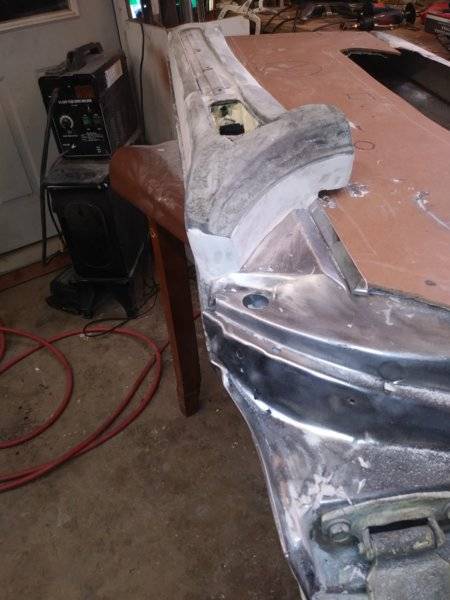

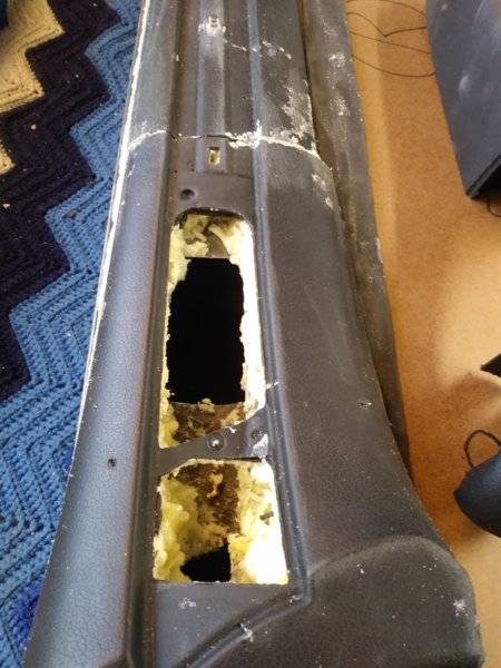

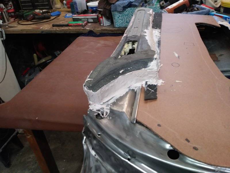

If you look closely you will see drywall screws through the body of the sections holding them in place position wise and also distance from the panel wise. It worked perfectly on the driver side door. The sections are ridged plastic under faux leather. Once dry I'll remove the screws and trim. Then apply Bondo over the foam to give me a smooth surface formed just right , to put fabric over. After I remove the upholstery that already on them.Just be careful with the foam. I use it for modelling, sometimes if it's a thick section it keeps expanding the next day and forms a bulge.
