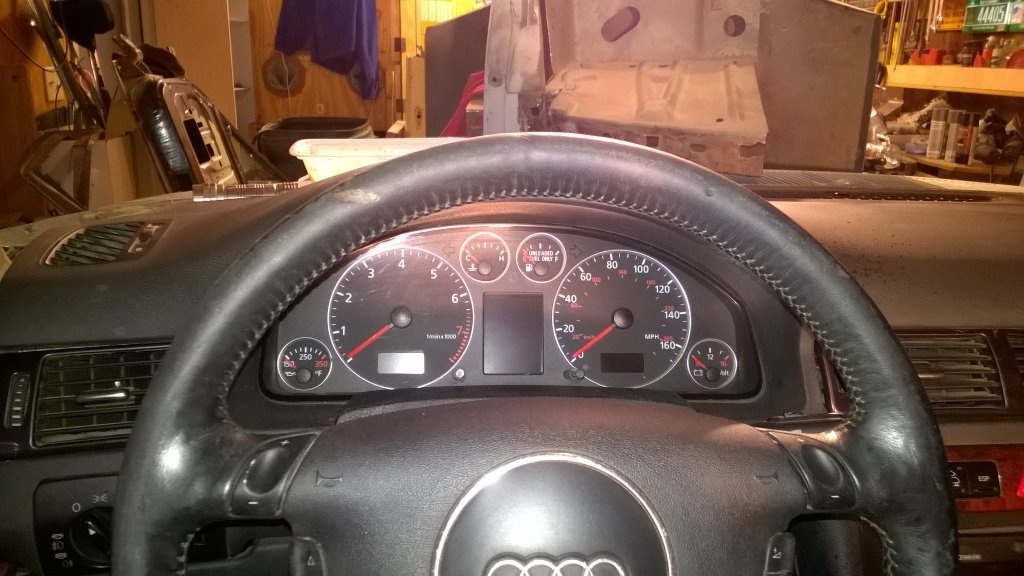

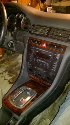

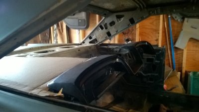

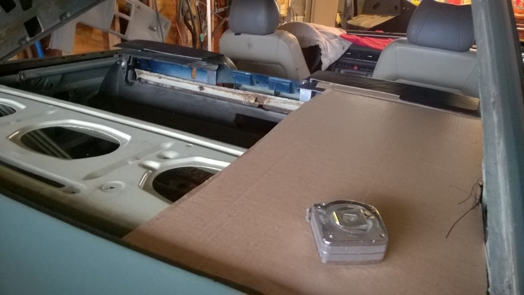

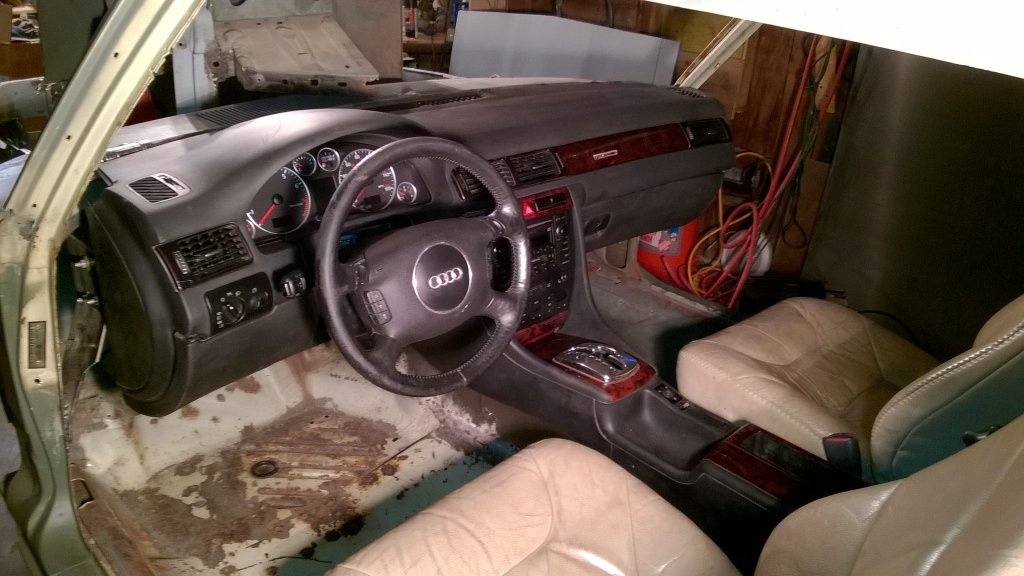

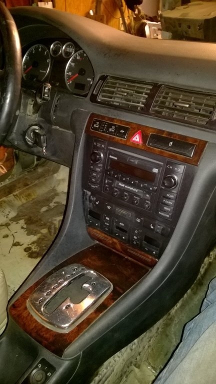

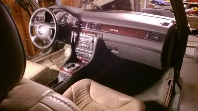

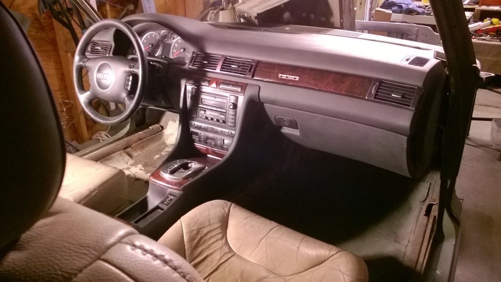

Chip Foose. The 1965 Impala Imposter. I then went to the local salvage yard with a list of measurements and tape measure and looked in every car and truck out there. About 230 vehicles. Strangely enough the Audi was the only one with the dash at the right length. Plus I liked the way it is laid out and it's appearance. I suppose if there had been a Mercedes coupe there that had the right numbers it might be that instead. I did end up having to shift the dash to the right about an inch and a half so the console would center up on the Coronet tunnel. The Audi was designed to give the passenger a little extra room. The other difference is that the distance from floor to lower windshield lip is greater in the Coronet by about 6 inches. As you can see in these pics I took today the center console is sitting a few inches higher than normal. I like it though, it kinda makes the space into two separate cozy areas. All of the radio and whatnot buttons are well within reach too. The power seats make reaching the gas pedal and steering wheel easy.What made you think of using the Audi stuff ?

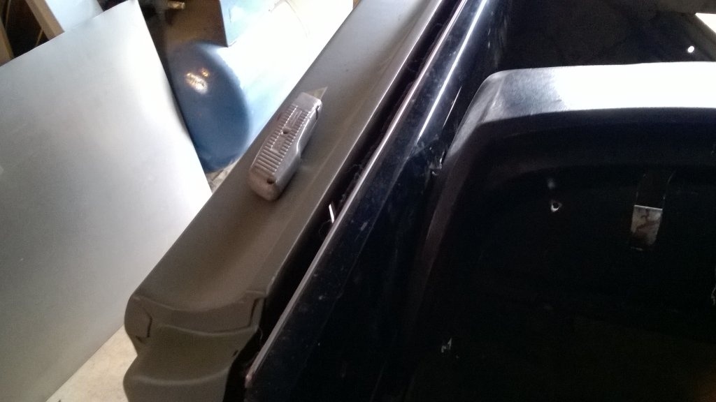

I spoke to the guy at Filler Neck Supply Co. about it and he said I'm not going to find one that is 6 inches across and pops up and is smooth without handles or bolts etc. The best I can do is get one that I can then slice off the top of the pop up and fasten my smooth panel to it and adjust height and positioning until it " Disappears " in the panel leaving a very small gap around the edge. The top will also have to be slightly curved to match the quarter surface. I originally wanted to use the Jet Fuel Only cap but felt it's too gimmicky.Ghost sounds like a great idea

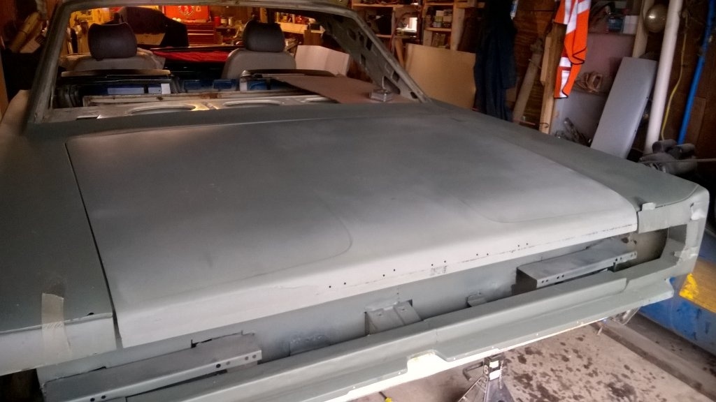

Nope. Looks like one though don't it? I sliced the 67 Coronet skin away from the hood and fabricated a new skin with the cowl on it and welded it to the Coronet frame. Cheaper than buying one and I got to shape it myself. Still have build a insert to go into the rear end opening in the cowl.Is that a roadrunner hood you used ? I have one I was thinking about skinning to see what it looks like.

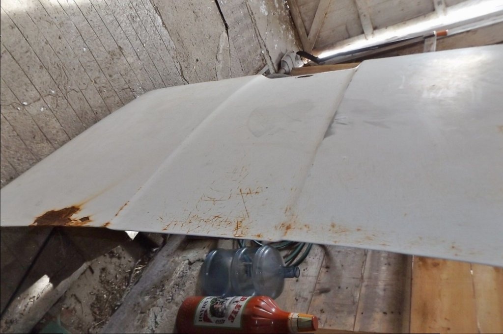

I have one leftover from another build, I planned on skinning it today but didn't get to it, I'm 3 days over on a vette project. Wish people knew what they wanted. I like your hood.I have been told that a 70 RR hood is the right shape, width and thickness but is about 3/4 of an inch longer.
I did, thought the front filler panel was a good idea, and nobody will know how to open your hood. It reminded me of the 72 roadrunner I had. I like the back bumper idea, I moved my reverse lights from the deck lid to the rear bumper to. Saw that on some drag cars.I know, right? People change their minds at the weirdest times. Just make sure you make them pay for it. Thanks about the hood, I originally had two scoops but it didn't grow on me so I changed it. I'm going for a very sinister look, almost evil. lol. Did u see that I made the first 8 inches of the hood stationary? Those hoods are heavy bastards so I shortened the amount to be lifted since it's going to tilt forward.
