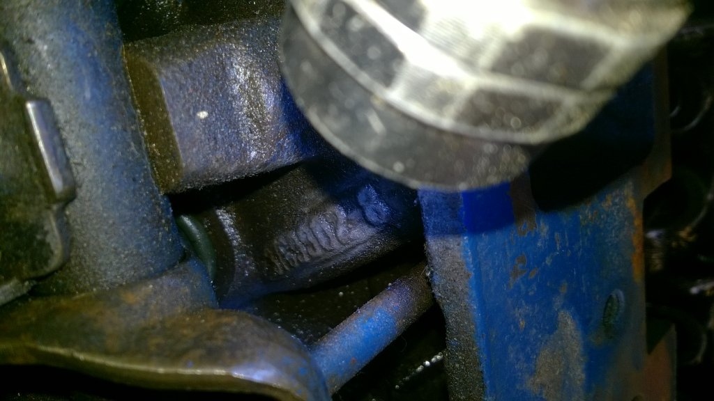

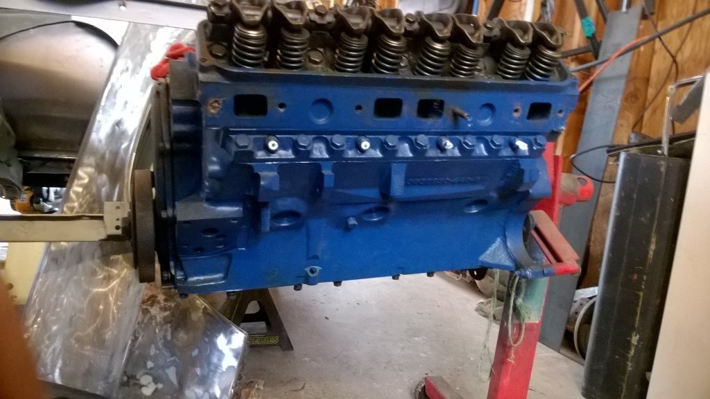

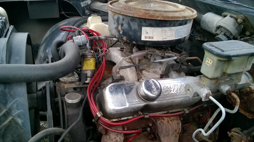

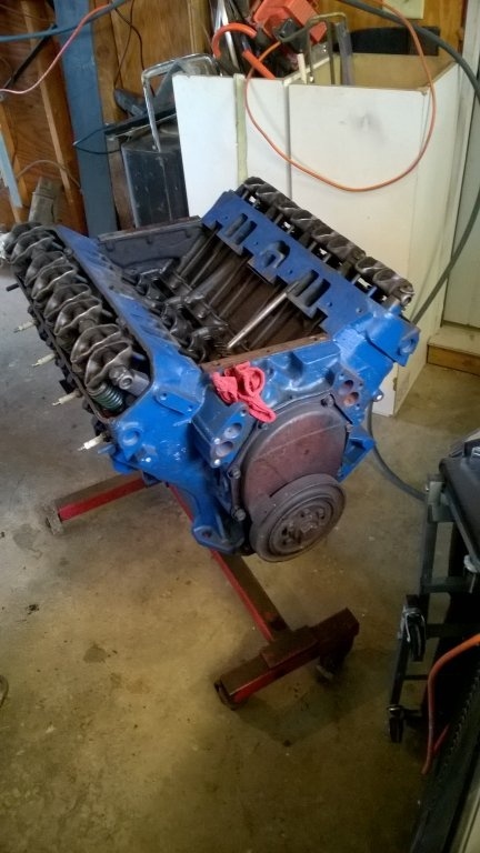

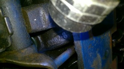

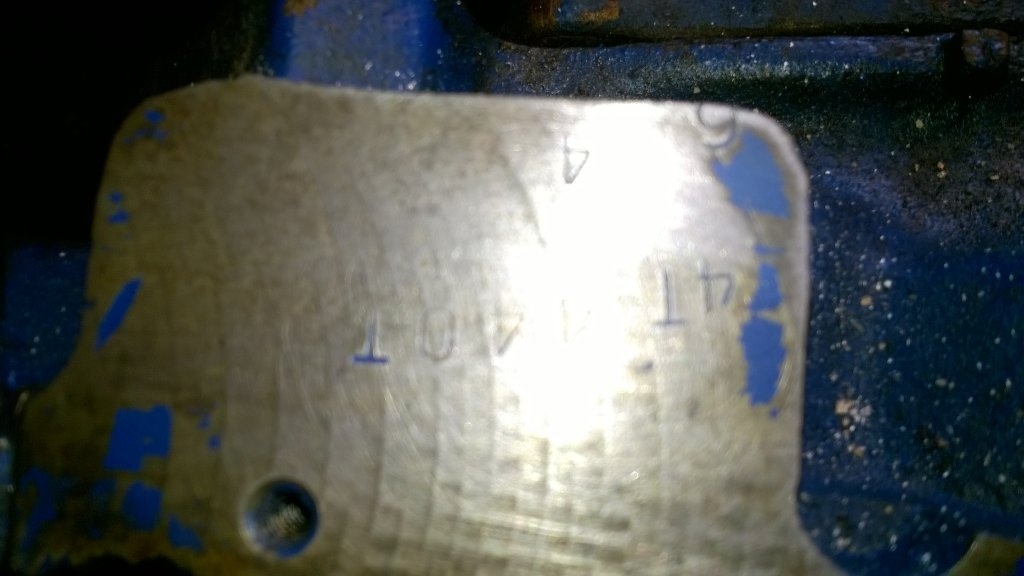

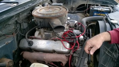

Ok... this engine is an "RB" block, cast crank, "902" heads,8.9:1 compression,
4.32 bore/ 3.75 stroke, built in Trenton 6/4/1974. From what I have gathered so far, the open chambered "902" heads flow as good or better than the "906" heads. This motor has the raised rib along the sides of the block just above the freeze plugs, thicker ears, 10% more cast iron in the block, good thick cylinder walls so I can bore it .60 over if I like, raised deck, increased sized cooling passages, and is classed as a truck engine. The scoop says the cast crank is fine up to 600HP as are the pistons and the block. So I guess my path forward will be to have the block and bare heads hot tanked, sonic checked, honed/bored .30 over, parallel decked, and hardened seats installed on the exhaust side. A 30 degree angle cut on the valves is also a good bet. Porting and smoothing, Gold Race rockers, new springs, small cam, 850 Demon, M1 intake, 2" carb spacer, high volume oil pump, 3/8 fuel line, new rings, performance gasket set, performance ignition. With those things installed it should put out 502 LB-FT @ 3700RPM, 512 LB-FT @ 4900RPM and 519 HP@ 5400 RPM. or thereabouts..lol.
