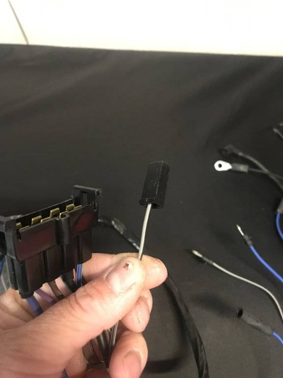

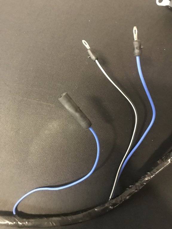

Ok so got a new engine wiring harness was able to tell where most went except a few.i don’t have the grey wire with the black connector on my original harness. And the pic with the three wires together I don’t know where they go either. Can you please help

^^ Yep, need some more info. '70 Coronet? Is that the middle bulkhead harness?
There should be a single wire coming out of the firewall that connects to the short grey wire with blk stripe near the harness. The 3 wire group I believe two of those wires go to the coil and the third I am not certain about. I believe it attaches to the diaphragm on the distributor.
