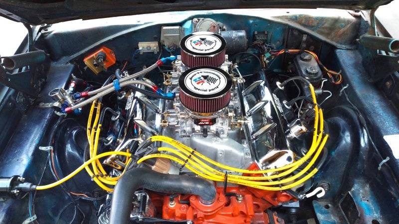

Awesome, Your GTX is bad ***!It's been quite a while since I've posted anything about the GTX. I have put about 1200 miles on it and had it tuned to run pretty good with the 950 Holley on the Indy intake. It just never looked right to me with a single carb. Collected up a KB marine intake and set of chrome valve covers over the last few years. I installed a pair of new 650 AVS2 carbs with straight linkage, so far I've only changed the step up springs based on manifold vacuum. No jet changes yet and kept the same 32 degrees of total timing. Plugs are running dark brown so a little more tuning is needed but it feels like it pulls harder and has crisper throttle response with the dual carbs.

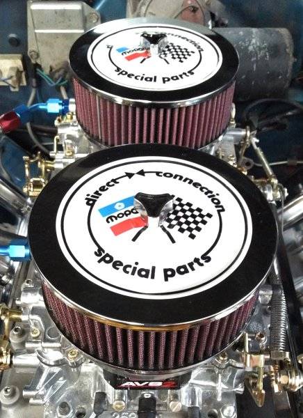

Thank you. They are the generic 6 3/8" x 2 1/2" washable gauze air cleaners that I added a set of DC decals to.What brand air cleaners are those?
That engine bay looks like jewelry.
