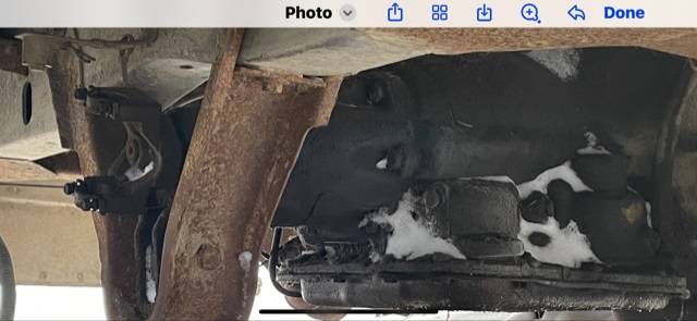

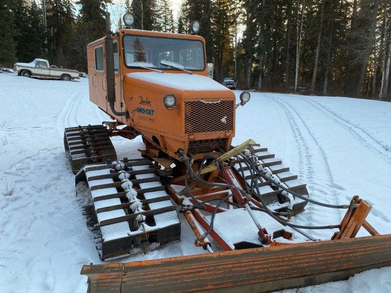

I am looking at replacing the original 5 speed manual transmission with a 727. Space is limited, but the Tucker specs list the 727 and Allison as options. So Tucker must have used the short tail and yoke that used used in trucks and vans that used the 318 engine.View attachment 1382291
I just want to be sure this will fit, but so far I have not found anything online that gives the measurement of the overall length of the truck Loadflite transmission. The space I have to work with is roughly 26"
Anyone have a 727 shorty to measure to end of yoke????
That IS the whole thing, bell housing to end shaft seal.Ya, I saw that measurement, and what then is the long tailstock measurement? It seems 34 3/8" is closer to the long stock length.

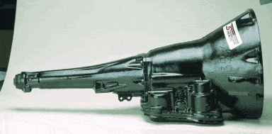

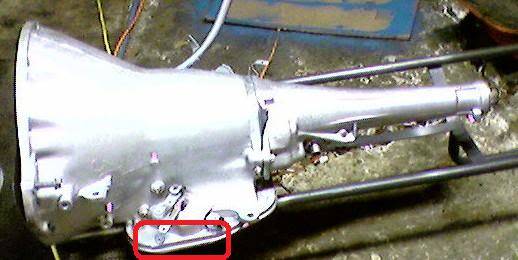

1. Do I have a 727 or a 904?
The picture of the 727 transmission is first, the second is a 904 transmission –

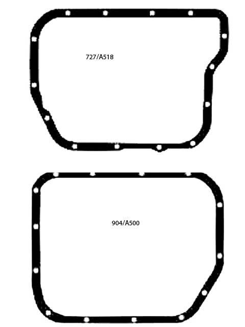

Gasket pictures to see what you may have from a bottom view

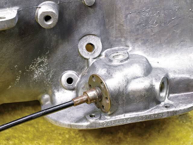

3. Where do I look for the identification number’s on my transmission?
You will see a set of numbers starting with “PK” on the driver’s side of the transmission above the tranny pan but below the shifter levers, see below:
The passenger side carries with it (if its 69 model year only) the complete VIN of the vehicle, 1970 and above have the year, place of manufacturer, and serial number of the vehicle it was made for, see below:

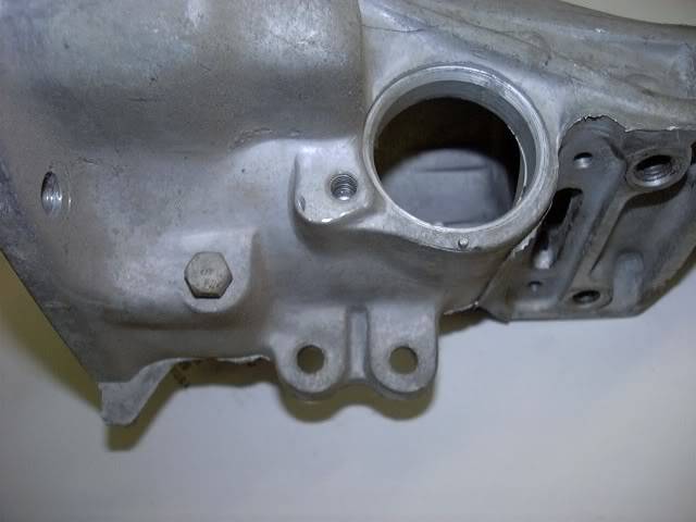

7. What is the difference between a truck and a car tailhousing?
TRUCK HOUSING:
CAR HOUSING:
8. What is the difference, externally, between a 65 and below 727 and a 66 and up?
65 and below will have the parking brake mechanism located on the outside of the tailshaft housing (see right silver transmission), and the transmission mount is located in a difference place, and has wider bolt/stud mounting holes.

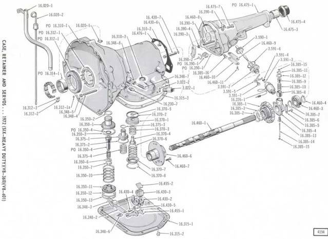

12. BREAK DOWN OF A 727:
