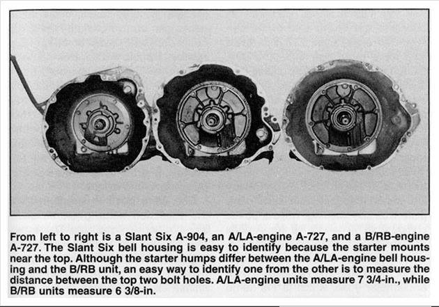

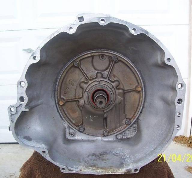

FIRST AND FOREMOST, HERE IS FRONTAL PICTURES OF THE /6, SB, AND BB TRANSMISSIONS:

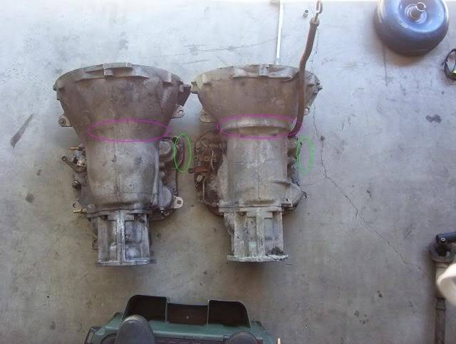

1. Do I have a 727 or a 904?
The picture of the 727 transmission is first, the second is a 904 transmission –

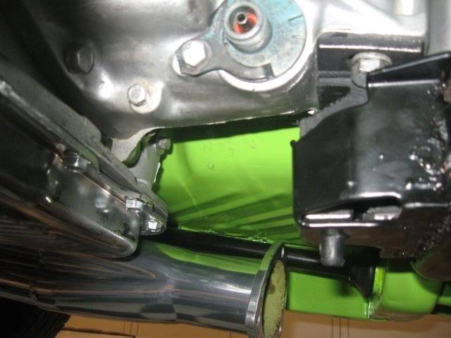

3. Where do I look for the identification number’s on my transmission?
You will see a set of numbers starting with “PK” on the driver’s side of the transmission above the tranny pan but below the shifter levers, see below:

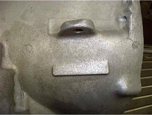

The passenger side carries with it (if its 69 model year only) the complete VIN of the vehicle, 1970 and above have the year, place of manufacturer, and serial number of the vehicle it was made for, see below:

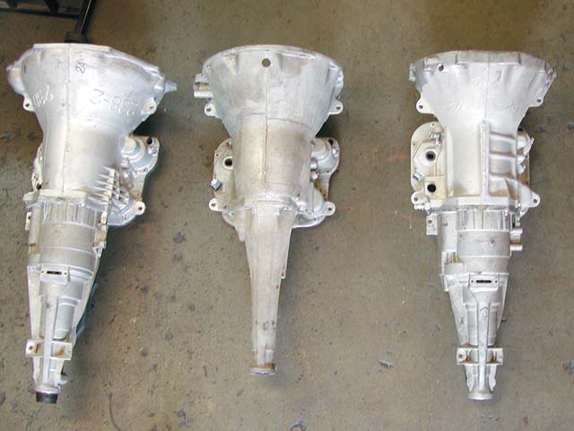

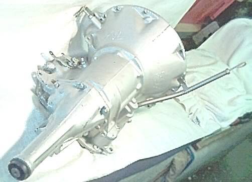

8. What is the difference, externally, between a 65 and below 727 and a 66 and up?
65 and below will have the parking brake mechanism located on the outside of the tailshaft housing (see right silver transmission), and the transmission mount is located in a difference place, and has wider bolt/stud mounting holes.
Also, 65 and below were a pushbutton design:

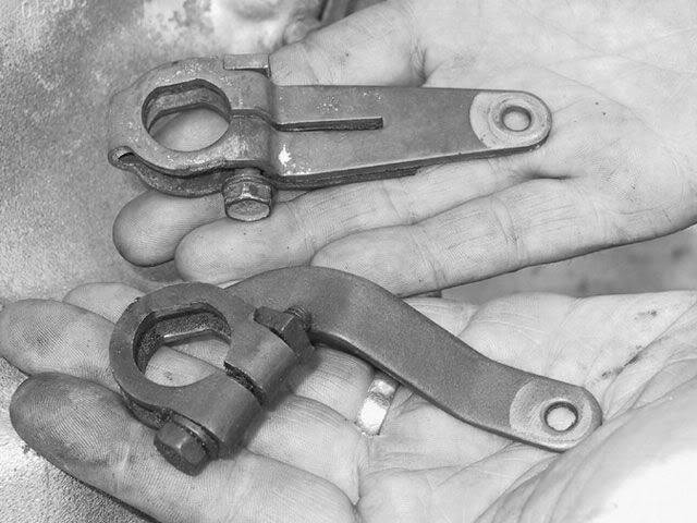

9. What are the differences between the shift levers, are there any?
Generally, a 727 shifter lever is straight and a 904 is offset (though some applications have different length of levers to compensate for vehicle model/engine combinations).
727 on top, 904 on bottom:

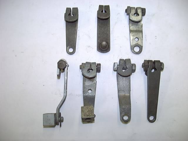

10. This will give you an idea to the different styles of throttle pressure (aka kickdown) levers:

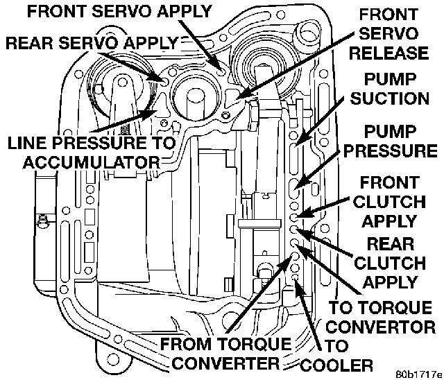

11. Good reference on what each port does in the transmission case:

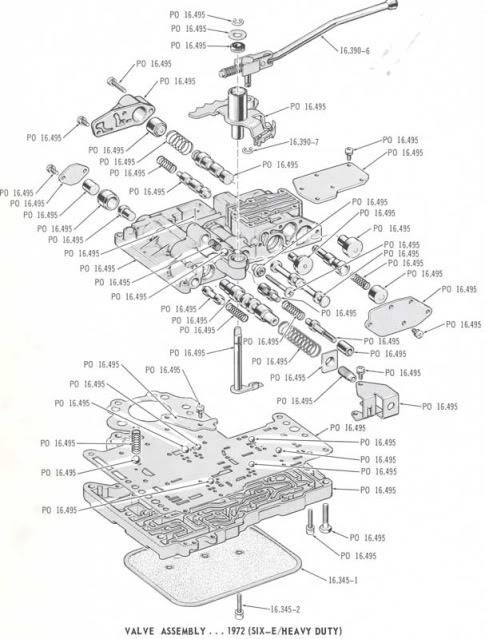

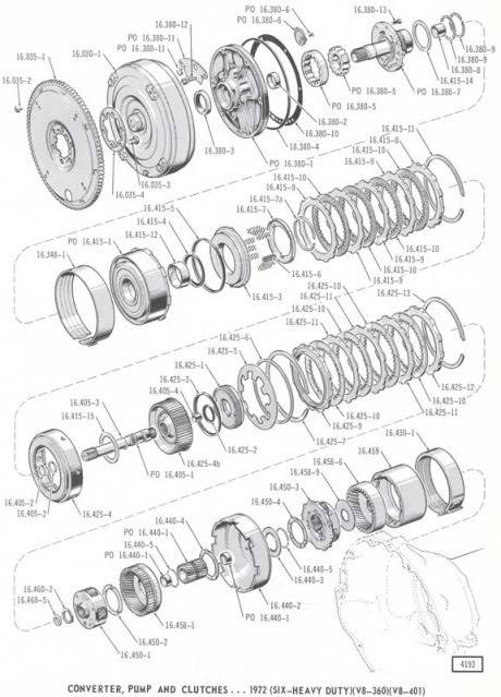

12. BREAK DOWN OF A 727:

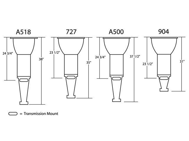

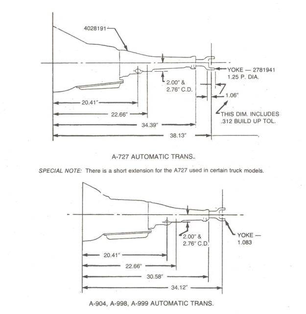

13. DIMENSIONS BETWEEN 727 AND 904:
Remember, only smallblocks have 904 derivative transmissions, though some came with 727’s (i.e. certain truck and HP car models). Big Blocks only came with 727’s.
