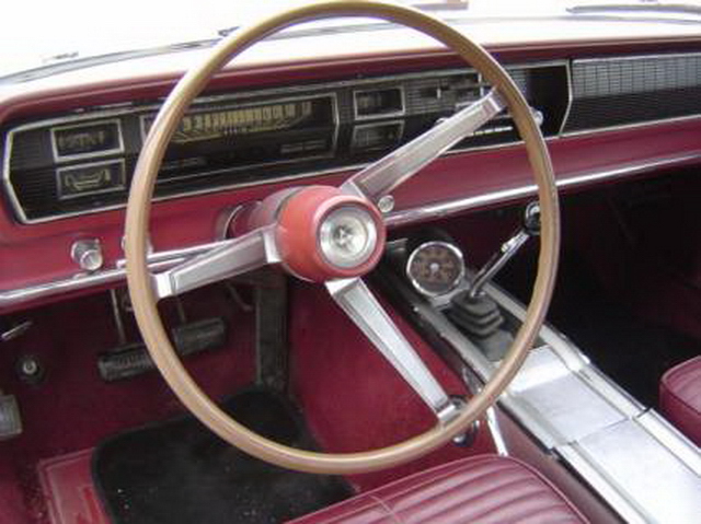

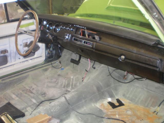

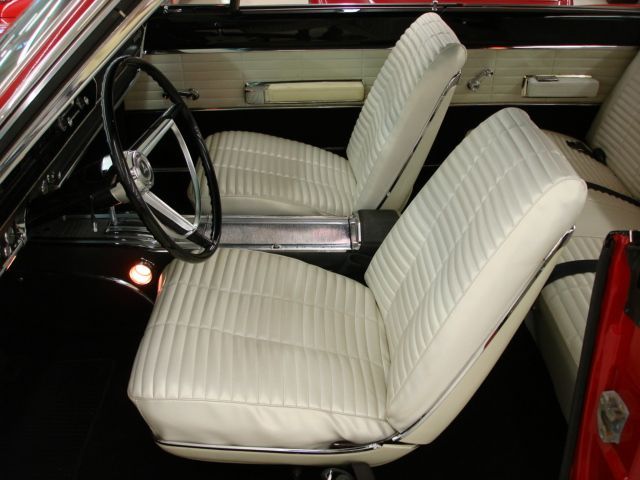

I'm getting ready to do a complete interior restoration on my 1966 Coronet 500 2 door hardtop which will take it back to a much more factory stock looking appearance. It will look very similar to the one shown in picture #1 and 2 below. The only difference will be that I will be keeping my AutoMeter tach and gauges and my floor console mounted B&M Quicksilver shifter.

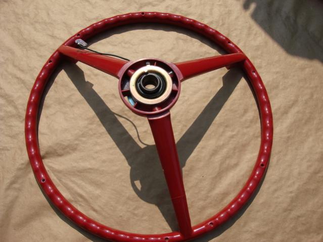

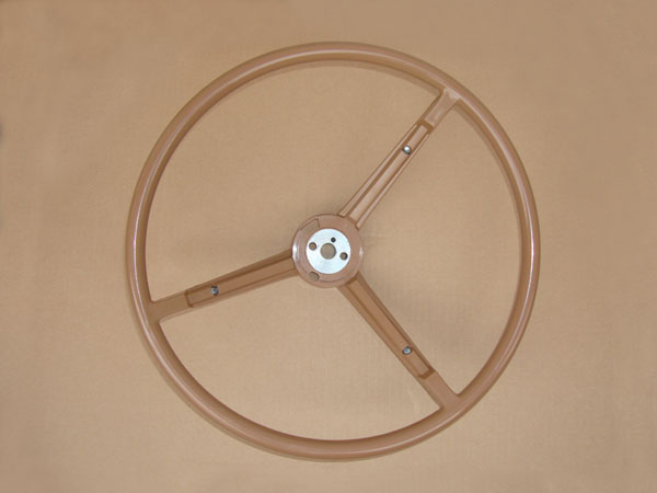

One item that I'm having a hard time making my mind up on, is what steering wheel to use. I have one of the black plastick steering wheels with the full horn ring that came on my car from the factory, (picture #3) but I was also looking at maybe trying to find one of the factory 1966-67 wooden rim steering wheels, (picture #4) or maybe an aftermarket wheel similar to picture #4? Any other suggestions?

Great question! Most of the time I prefer the factory wood wheel, but not on your car! I think the black looks way nicer!!
KID
I agree with the Kid, normally I like the wood but in yours Black.
but not the 2 spoke, the 3 spoke in pic #1
or the 3spoke in pic #3 with a black rim.
i picked the black plastic... i was surprised usually the stuff i pick is not in the majority..
If your interior color combo will be the same as pics 1 & 2, I would opt for the wheel in pic #1 (a black 3-spoke with a half horn ring).
I like the three spoke black as well.I really don't like the wooden 66-67 wheel.I don't know maybe it just looks to fake. Jim
I will admit that I always thought it was strange that the 66-67 B-Body cars had no other woodgrain trim in their interiors. except for the steering wheel itself.

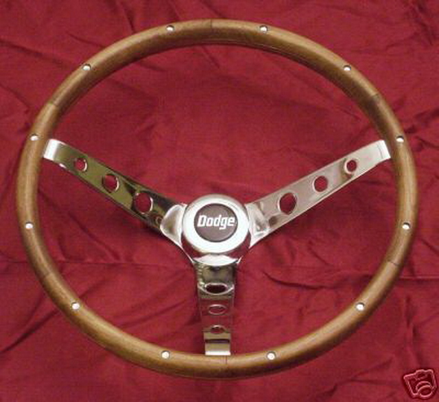

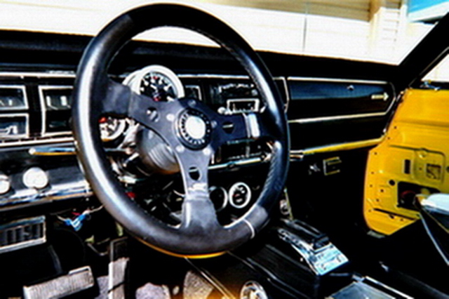

So far, it looks like everyone is favoring either my factory black two spoke wheel, or maybe something like this one?
Thank you all for your ideas!

Definately the black plastic, it looks the most correct and the classiest by far!:imho:
Maybe that black plastic 3 spoke wheel with the partial horn ring might work, as I do have my AutoMeter tach and a couple of other gauges mounted on the steering column, (see picture below) so that partial horn ring might make my gauges easier to see. :dontknow: I also wonder how hard it would be to find one of those plastic three spoke wheels and horn rings in excellent condition?:dontknow:
Richard

After all of the talk about the cool looking three spoke wheels, I went back and looked through my factory 1966 parts book and it looks like there were only two different steering wheels available on 66 Coronets and 66 Belvedere's and Satellite's. These wheels were also used on some of the 66 C-Body cars as well. As a modele code reminder, V = Valiant, L = Dart, W = Coronet, R= Satellite and Belvedere, D = Polara and Monaco and P = Fury I, II, III and Sport Fury. As you also know, the trim codes listed below can be found on your cars fender tag, or build sheet and the codes listed below are used in reference to 1966 model year cars.
Here's what I found reguarding the 3 spoke wood grain and the two spoke black plastic 1966 steering wheels. .
part #4016VTT, steering wheel, yellow tan, with three spokes, used with all 1966 interior trim codes, wood grain rim, optional on V, L, R and W models.
part #4004AX9, steering wheel, black, with two spokes, used with interior trim codes H1X, H4W, H4X, K1X, K1B, K1R, K1T, K2T, K4B, K4R, K4T, K8T, K8A, K9A, L1X, L4X, L5X, L4W, L5W, L8A, L9A, P1X, P4X, P4W, used on R, W, P, and D models.
So it looks like the wood grain wheel is interchangeable on the 66 A and B-Body cars and the black plastic, as well as many of the other two spoke wheels in other various colors which I haven't listed here, are interchangeable with the 66 B and C-Body cars.
The only listing for a three spoke wheel on 1966 B-Body cars is the wood grain version and all the rest are shown to use the two spoke wheel. The only listing for horn rings on the 66 Coronet's, is the "full" horn ring, while the Belvedere's and Satellite's show either a "full" or a "partial" horn ring option depending on the trim level of the car.
