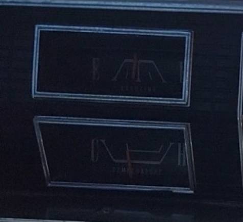

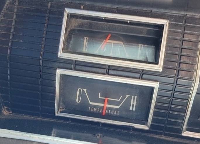

Here's 174, 196 and 222 on a '67 gauge.

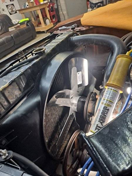

I added a shroud as there was none when i got the car, it wasnt run for years at the time when i bought the car so who can say how long it sat ..the fan is mostly out of the shroud so i bought a 1 inch spacer and a 6 blade fan which i have not yet installed.. looking into the radiator i found some rust flakes but barely any. The lower hose does not have a spring and searching local autoparts stores nobody carries one that does. I have to reference a 1970 plymouth fury 1 for the hoses because thats what the drive train came out of.. the lower is a Gates 20663. I have been looking into the whole clutch fan thing and will go that route if i have to, not a big "fan" of that idea.. { sorry :) } I am having a new trans put in soon and i will have the shop professionally flush the coolant system. They replaced the freeze out plugs in the block as they were paper thin. They also rebuilt the differential and i dropped down from 278 (?) gears to 355 (?) with a posi unit. With the engine running at higher speeds you would think it would run cooler but the heat has been a problem ever since. I borrowed a heat gun and will use it when i reassemble later today. The engine only puked once and alot of fine rust came out after i flushed the system afterwards. With no coolant recovery system my guess is it might of had too much coolant and spit out the rest.. and it was 98 degrees here at the time as well. The gauge seems accurate and i replaced the sending unit as well. It repeats each time so its at least a good reference. Than you much for your input !!

I ran the car with the 6 blade flex fan,shroud,180 thermo ,fan halfway into the shroud etc and i will say the air that was being pulled thru the front of the radiator was incredible!! Driving the car i could see the system cycling as the thermostat opened and it stayed well within the normal range of the gauge. I also ran the heat gun all over the radiator, water pump, hoses, and thermostat housing and nothing was over 190 degrees.. so far so good.
It sits centered both in depth and diameter to the opening.. being a flex fan seems to be frowned upon alot here but when i can find the right clutch fan setup i will likely go that route..right now i am trying to figure out why the new fan belt i put on squeals under power and it seems the lower pully has been replaced by p/o and looks to be about 3/16 of an inch out of line with the water pump/ p/s pump.. now i have to hope i can find another outer damper pully somewhere.. finding parts has been a challenge !!
