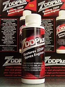

Anyone have any recommendations other than bending over and paying for the shipping ?
I don't normally use additives.
But when I do, I use ZDDP Plus.
