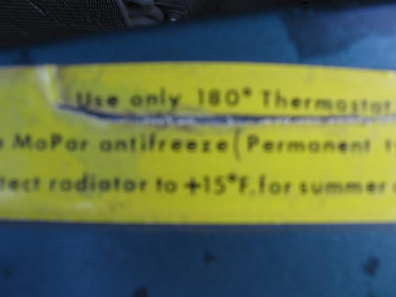

Here is a picture of the FACTORY sticker on the core support of my original 1964 Plymouth Sport Fury. It clearly states to use a 180 degree thermostat. Just my .02 cents.
Roger

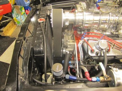

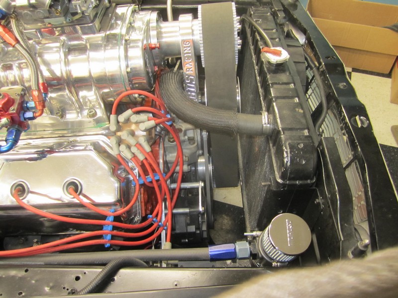

Some systems have different designs then what came from the factory.I have NO room for a puller fan:eusa_think:
