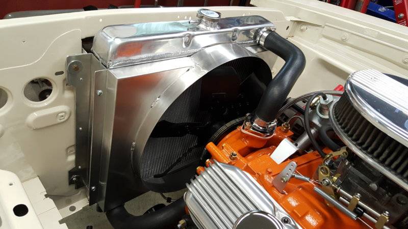

What is the factory spacing?
That I can't tell you as I did not measure it with the stock radiator in it.
I did find out today that with the .75" inch spacing from the radiator fins, the 17" 7 blade fan touches the top tank of the radiator. I have a 1" spacer coming to replace it which should set the front of the fan blades about 1.25" from the radiator and clear the top tank - I'll post dimensions when that is on.

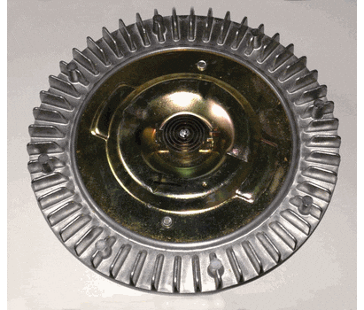

Factory cars were optimized for just that, factory conditions and low-traffic scenarios. Can't even purchase a fan-clutch OEM anymore, believing it is adjusted correctly (or as it left the factory in '1970'). This is a great overview explaining how to adjust this style of fan clutch.
For example, Mancini Racing Thermal Fan Clutch: Adjustable. How many actually adjust prior to installing?
Thanks for bringing this up. Most of ours don't have the little adjustment plate like the one in the video, but there's usually another notch to locate the spring which accomplishes the same thing, or sometimes another notch can be filed in the tang if there is only one...many people aren't aware of it. It helps!
The actual .75” space works fine. It’s funny that simple arithimetic didn’t work with the fan spacers, i.e. a 2.5” space between front of fan and the rear face of the radiator doesn’t necessarily come down to 1” with a 1-1/2” spacer.
Anyway, it runs cool all the time except in extended stop and go crawling traffic so I reinstalled the electric pusher fan for those occasions.
That meant the stock 37 amp alternator needed upgrading so now there’s a 98 amp powermaster alternator with a newer style transistorized voltage regulator under the hood.
Another great article, for those that may have a 'flat plate & plunger' style of clutch fan;
http://midamericachevelles.com/tech/fan_clutch_adjust.pdf
It's a pretty overwhelming article, in the case of GM cars, the factory reproductions from GM (with a plate, no external adjustment) were being set for maximum lockup around 210* F. Would make many people believe there is a cooling problem for sure, when really, the fan clutch was improperly adjusted.
