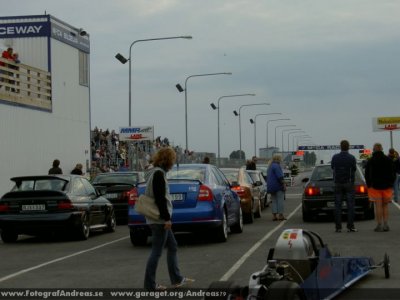

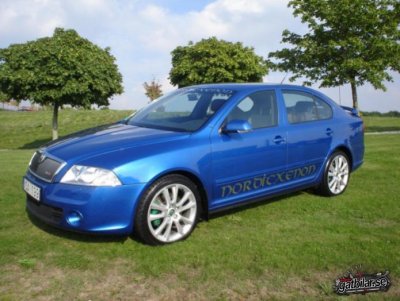

This was my companycar with xenon in Low, high and foglight, did 9,71s, 77 mph on 201 m with 18" wheels.
After new software it ran 9,39, pretty nice family car, same chassie as Golf V GTI.

Great to see your ride on here Joakim. Nice ride! That blue is stunning. Really pops in the sun!

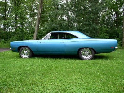

Yer gunna lower that car about 2"? aren't You Will?
Looks good as is to me.It will drop some with a drivetrain it it.
She's coming down in the front Steve, just like Jay mentioned....I'll get about a 2" drop in the front from the drive-train, just enough to make the wheel opening about level or just a tad lower than the wheel. My driveway has a bit of a tilt towards the road, so her stance now looks like a rake to the front, but that's deceiving. Once the drive-train is in, the car will have pretty much the same rake to the front as the picture above appears to have. Only difference is the front wheel will be higher into the wheel well.
I based my rear wheels height off my desired RPM at highway speed with the 3.91's as well as Hunt2Elks rake on his bluebird. My rear will be about an inch higher because I have the Cal-Tracs underneath. Same springs/tire height though.
