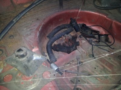

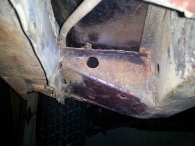

Interesting parking brake cable routing
Working on the car and find out that I'm having a hard time fitting the floors into the car and getting them to lay down flat. So I crawl under the car and find the following situation with the parking brake routing for the cable.
So since there was this very nice, and convenient, hole in the vicinity, I took advantage of it . . . and it helped with the cable angles too.

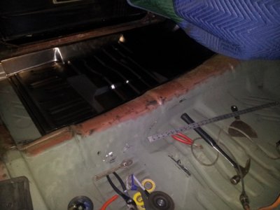

As I've said, I've got some more work done, but I've had a busy time trying to get caught up around the house, so the pictures are way behind on the actual progress of my build. Here's an update of the floor replacement . . .
Removal of the rear seat driver side
Driver side rear seat being removed
Passenger Rear seat tacked in place

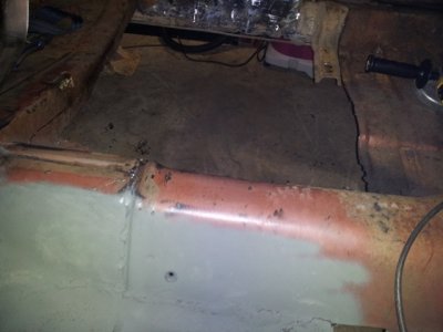

Bottom of completed rear seat welded in place
Little rough on the welding, and I'll clean up the welds more later . . . but my skills are getting better with the more practice I get welding the panels in.

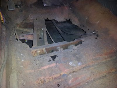

Reminder of what I had to start with

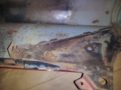

Passenger side removed - frame rails cleaned and primed
Another closer look at the frame rails

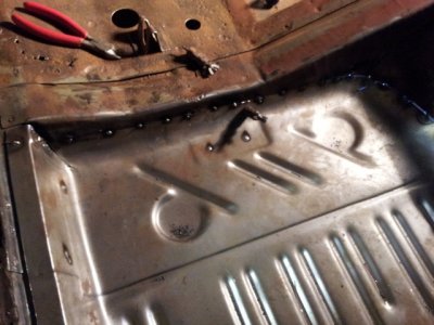

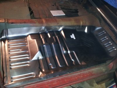

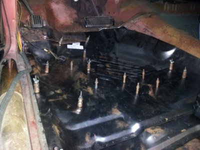

Test fitting - dropped in the original floor plan to start trimming it to size
After a bunch of times in and out of the car to fit it, it's finally tacked into place . . .
Here's the final product - the passenger side is completed - little more grinding and fine tuning yet to do
I think it's coming along quite nicely . . .

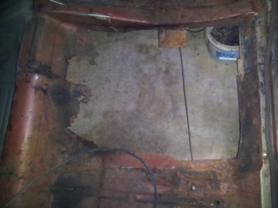

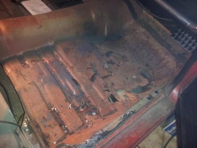

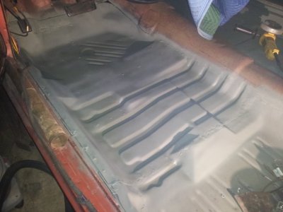

Once again - here's what I had to start with on the driver side - uh, should I say didn't have to start with ( I'm coming Fred Flintstone )
Full panel set in place to start the fitting process . . .
Getting the floor pan to sit down right and fit into place - very happy with how this one went in . . .

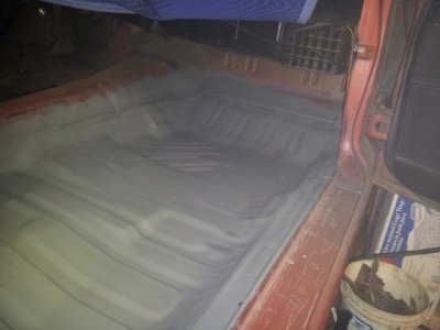

Got the driver side in primer to protect it from rust . . . turned out pretty good . . . will revisit it later.

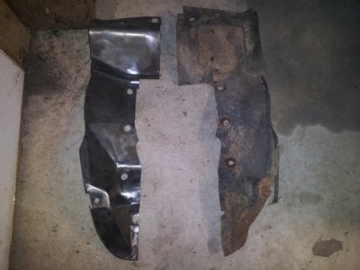

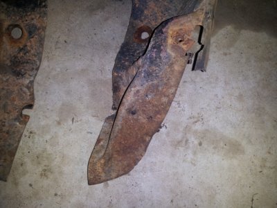

Here's the lower front quarter panels inner panel ( did I say that right ? ) - they look pretty rough
This one had an encounter with a not so favorable opponent - and lost . . . . bit dented in
Progress on the cleaning up process - not looking so bad after all
Even was able to get the dent pulled out of the bad one ( still needs a bit more work ) but it's going to work just fine.
Still got a little crease in the metal that I'd like to get moved where it should be.
Work continues . . .
Those look like the inner splash shields. If there is supposed to be a rubber seal on the edge of them, you can take an old door jam seal from a dodge pickup and cut it to size. Make sure it has the groove that fits over the lip with the rubber seal. That what I did with mine. The rubber sits right up against the inside of the fender.
Thanks roadrunnerman . . . still working on the names of all these parts. Still got the rubber seals, but they're pretty much toast. Will be looking into your recommendation and any other leads I can find for locating the replacement rubber seals. The back sides have a little surface rust, so I'm going to run them in the media blasting cabinet before primer - then maybe bed-liner to have them last.

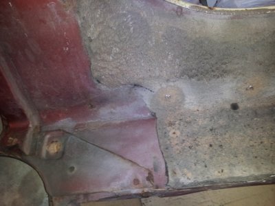

Got a little bit of cancer on this fender support - but I've got the passenger side to use an example to get it fixed up

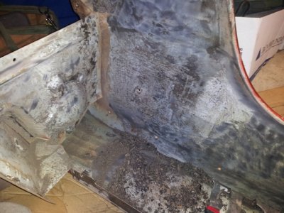

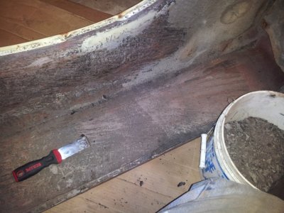

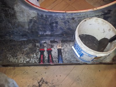

Now on to the passenger side . . . and wow, this thing weight 50 pounds, I think I've hit the mother load of ugh-der coating on this fender . . . my work is cut out for me on this one
Pulled out the front splash guard and the rubber seals, but there toast too - hard as a rock
5 minutes later on, the gunk is removed and ready for the wire brush and media blasting cabinet
Now onto tackling the removal of all this gunk from inside the fenders . . . notice my collection bucket as I fill it up with the remnants. By the way, this is the second bucket full of stuff removed from my car and collected already . . . you can also see my tools of destruction, your typical painting scrapers seem to have the best luck for me so far ( I don't have a needler ).
So, an hour later and I've got a good portion of the inside of this fender cleaning up nicely. This stuff was caked on there over 1/4 thick, maybe even 3/8 thick in spots . . . gonna be filling my bucket up pretty fast with this one . . . yup, it's filling up alright.
