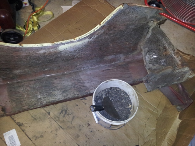

That must be factory undercoat i'm guessing since the metal is clean
Yes it's factory . . . and the fenders are in really good shape - yes ! But 45 year old undercoating want to stay put . . .
Well . . . the surgery was a success . . . the undercoating has been mostly removed from the front fenders. All that's left is to break out the wire wheel, dodge the flying metal spurs, turn black from flying undercoating removal, and finish cleaning these things up before they get media blasted.
Final view of the undercoating removed from inside the fender - finally . . .

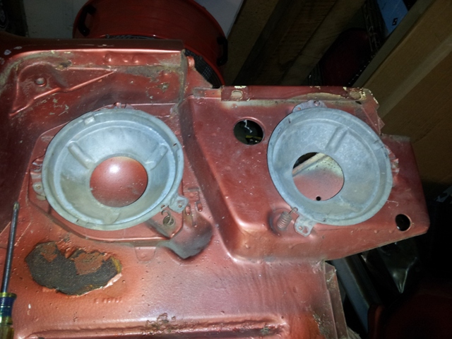

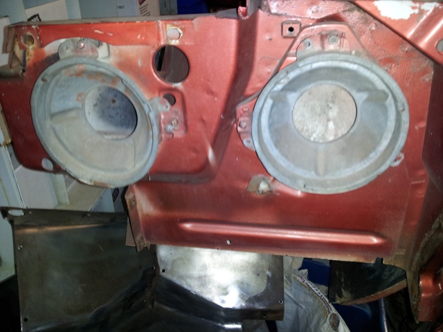

The light buckets and fenders are in great shape . . . hopefully not much work to get done here . . . passenger side
Same on the driver side - hopefully not much work to get done here either . . .

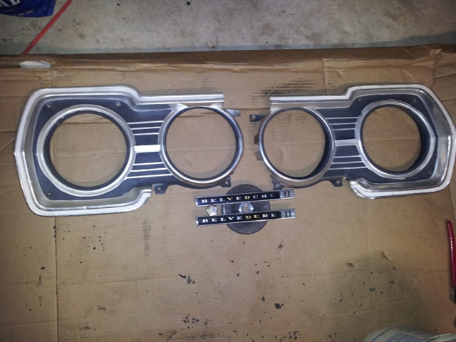

Here's the light bezels, some emblems ( which will not go back on the car ) . . .

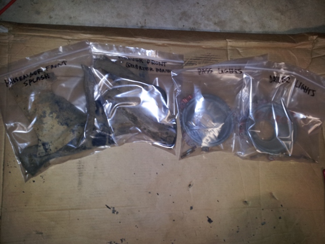

Removed the buckets, screws, and set them all aside . . . bag 'em and tag 'em . . . I'm getting quite a collection of these things already ! !

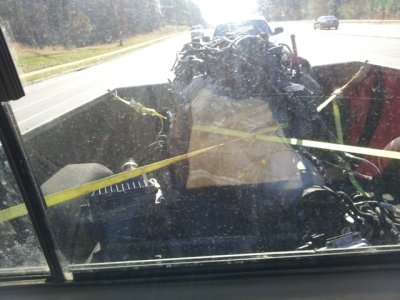

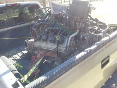

Mom . . . look what followed me home . . .
Looking out of the back window of my pickup truck - what do you see ( besides the fact that the windows need to be cleaned ) . . . got a little tag-a-long . . .
Look at what's following me home . . .
5.7L Hemi from a 2004 Dodge Magnum - Auto transmission ( will get replaced with a Tremec 5-speed )
Anyone interested in an automatic transmission ? ? ? Full wiring harness included . . . this is going to be interesting.
Haha I remember doing that, you keep looking in your mirror thinking about how frickin awesome it is to have a hemi in the back...

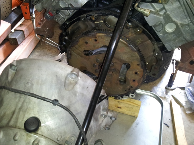

Got the hemi and the transmission apart and now it's time to get it up on the engine stand.

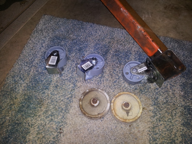

Picked up a cherry picker and an engine stand for only $200 on CL . . . thought I had a heck of a deal. As I was getting ready to put it on the stand I noticed the wheels were plastic . . . ugh. So needed to make a trip to Northern Tools and pick up a better set of casters for this stand.

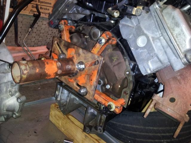

Working on getting the new casters welded to the stand so the engine can be set up on the stand . . . so this can be installed . . .

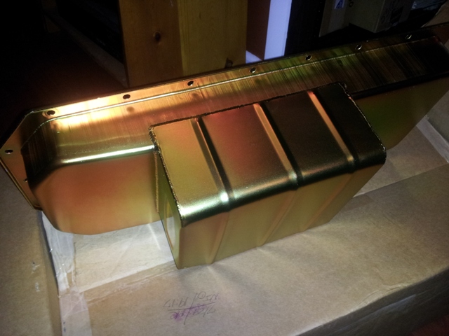

Got a few needed parts shipped my way . . . whoohooo . . .

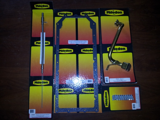

Thanks to people at Mancini Racing - got my pan, new pickup, gasket, and new bolts . . . ready for the swap to work with the K-member.
For your information:
Milodon Oil Pan - P/N - 31000
Milodon Oil Gan Gasket - P/N - 40750
Milodon Oil Pick-up - P/N - 18331
Milodon Oil Pan bolts - P/N - 85025
Milodon Oil Dipstick - P/N -22065
( stainless steel braided line - cool - should dress up the engine compartment nicely
BTW - they have "upgraded" windage tray that can gain additional HP, but since I'm not going to be racing this, I opted for the stock windage tray.

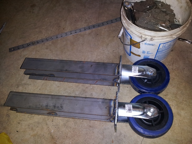

Making up some casters . . .
Also in the process of making up some casters to put under the car and move it around:
Fixed for the rear - attached where the springs bolt into the front of the frame.
Just need to get the spacing, drill the holes, and get them attached ( and the rear end removed )

Alright, the engine stand is ready, now for the hemi
Now, to put the cherry picker back together and get this thing lifted into place . . .
Hemi on engine stand . . . yay
Well, finally got the hemi on the engine stand, and now I can get back to work on the car a bit . . . and the engine a bit too . . .
Glad to have that part done !
