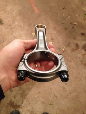

Yeah if I decide to get a little more aggressive in the future, that bottom end will take anything I can dish it. The thing is, I happen to have these beautiful Manley rods that I was planning on using them but now that I have the balanced rotating assembly, it seems a shame to break that up.
Do I rebalance and use the Manley rods or do i stick with the LY rods? So far by buddy ken and the guy I bought them from both agreed I should stick with the LY's, so that's what I'm probably going to do.

how much do the manleys weigh? are they 1.094 pin or .990? lighter componets are easier on the main caps, the true weak link.

Not exactly sure how much they weigh, I've been meaning to bring a scale home and to weigh it all. I'll do that tonight.
The rods are std 440 big end and std 1.094 pin.

Okey dokey, just weighed the shiny pieces...
pistons: 539g
Pins: 160g
LY's: 832g
Manley's: 859g

if it were me i'd re-think this. see if you can use the manelys. they're not too heavy and well made, much superior to the ly's. the extra weight is probably on the big end. i'd see if everything can be rebalanced and add some steel caps. then you'd be in a position for later up grades without a lot of worry about the bottom end. the #4 cap takes a beating and keep in mind it's just cast iron. i think the aftermarket steel caps already have the low deck bore size.

Thanks for the input, lew. I didn't know the caps were the weak point, I always thought the rods were. I think billet caps and the machining are out of my budget, this gives me food for thought. Question - is it possible to add a girdle later? Maybe that's the direction I head in if I get a little nuts with my goals later. Visually it looks to me like I'd need longer studs, can those be removed and replaced at a later date without machining?

in my opinion, girdles are gadgets. anything in the 500-550hp will cause the mains to jump around, less weight in the rod and piston, especially the piston, help. steel caps are stronger but also have the benefit of creating the "dissimilar metals" effect where the cap and block mate; no metal erosion or galling that i've seen. some prefer the alum cap but my experience has been with steel and light pistons and it worked. i actually prefer the steel cross bolt but i'm sure that's a hoop you don't want to jump thru. you might do some research and compare costs between caps and girdles. or you can do the hot rodder unthinkable (LOL), set power limits and forget about taking the project in direction that's uncomfortable, i do this.

I value your input for sure, but I think before I run away with billet caps and cross bolted mains, I have to remind myself that 99% of the time I'm driving my kids to get ice cream. So I think I agree with that last part - let's just limit the power to what the equipment at hand can take.

I think when I put all the advice together, I find that most people are telling me the rods can handle those lighter pistons past the point I'll ever take them and it's actually the caps that are the limiting factor here.
So... looks like I'm selling those beautiful Manley rods and sticking with the LY's, since the caps will be an issue before the rods.
And in keeping with my plan of only occasional track usage but 99% family fun, I'll keep the block and caps as is.
