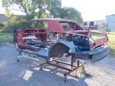

Cradles back out and on the rotisserie:

Next step is about a mile of seam sealer, undercoat, and paint the engine compartment. I'll put the wiring, fuel, brake, running gear back in and send it to paint and body. I won't start on that until next weekend, so no more pics until I actually do some more!
