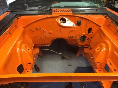

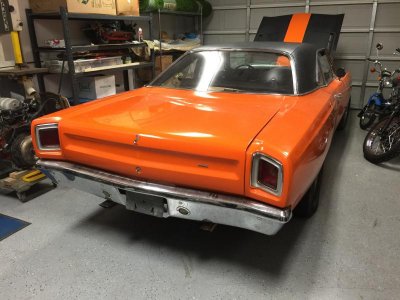

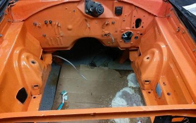

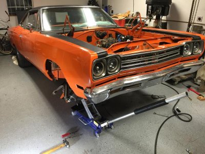

Hey B-Body peeps,

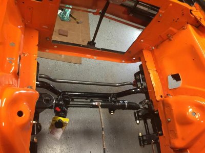

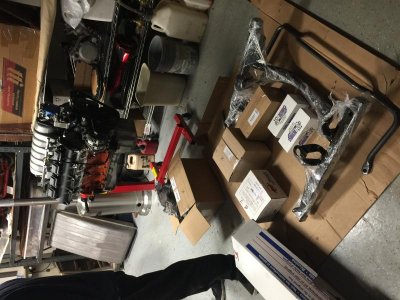

I have started my build and wanted to post pictures of my progress. :hello2:
Here it is;
1969 Plymouth RoadRunner ( B body)
2007 SRT8 6.1
Transmission: TBD (leaning towards 4L60 for an easy fit)
Transmission ecu: Compu shift or PCI
Wiring Harness & ECU: Hotwires or Holly EFI
Subframe: Control freaks:angryfire:

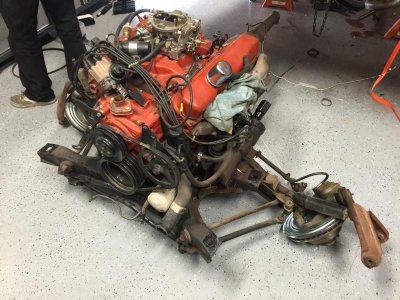

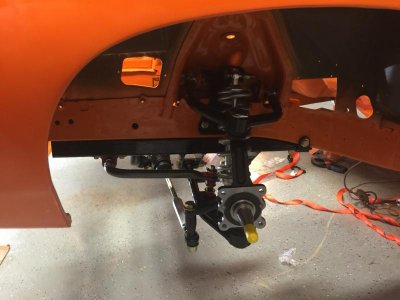

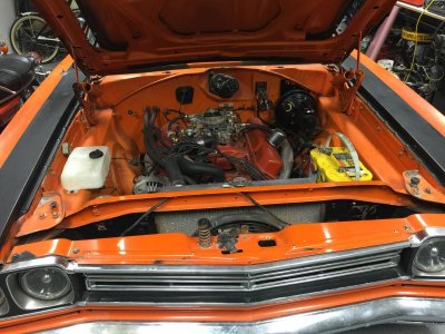

I have started by removing and selling the engine, I still have the original K-member with Disc brakes that i want to sell.

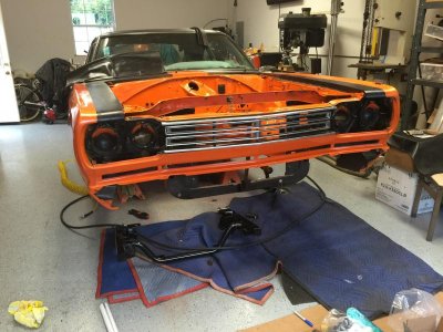

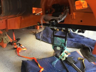

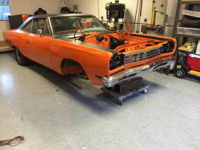

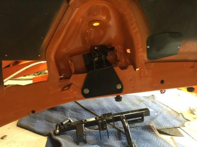

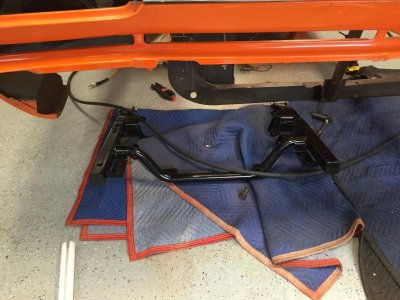

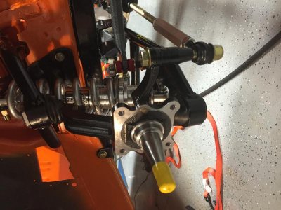

Currently i have the new K-member and suspension installed.
Currently hung up on transmission adaptor. Debating between Wilcap or Quicktime set up. One requires a 3 piece case and one requires a 2 piece case. IMG_4606.jpgIMG_4603.jpgIMG_5789.jpgIMG_5784.jpgIMG_5779.jpgIMG_5767.jpgIMG_5765.jpgIMG_5764.jpgIMG_5762.jpgIMG_5702.jpgIMG_5646 2.jpgIMG_5642.jpgIMG_4671.jpgIMG_4633.jpgIMG_4613.jpgIMG_4609.jpgIMG_4607.jpgIMG_5790.jpg

Wondering why the Control Freak vs. The alternatives?
That's going to be sweet look forward to watching the progress.
Thanks for following..
Very good question... about why I chose CF vs Atlr
I didnt know much about Mopars before this project, nothing at all actually. This was my uncles car which sat for years and years before i bought it from him.
My last project i stuffed a Honda Vtec engine in a Mini Cooper.
What i had learned from my last project was "SUPPORT"
When i spoke to Al at CF i felt like i could call them with questions... concerns... he would always pick up my call within 2 rings and answer my emails within the hour.
When i called Alter.. a chick picked up... stubbled around to get me pricing and just didn't feel like it was all together...everything seems extra, and it was more about are you buying or not? Now reading everything it might have been a better choice.. but hey.. Im married now and there is no used looking at the other kit .
ANNNNNnDDDD.. it was around $1800 cheaper... not that it was THAT big of a difference... but it was a significant amount.
