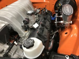

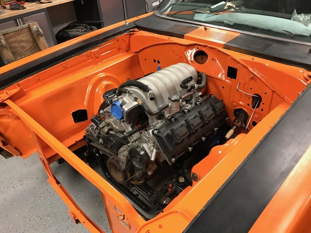

Looking good man, I thought the frame would have to be notched for the alt but there's plenty of clearance, good to know. Where did you get your tranny from? Are you running an aftermarket tranny kit?
The Tranny is a 4L60e, ive had it for a while. No kit with the tranny they seem to been VERY expensive.

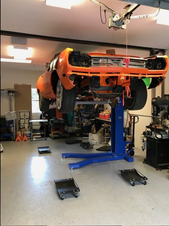

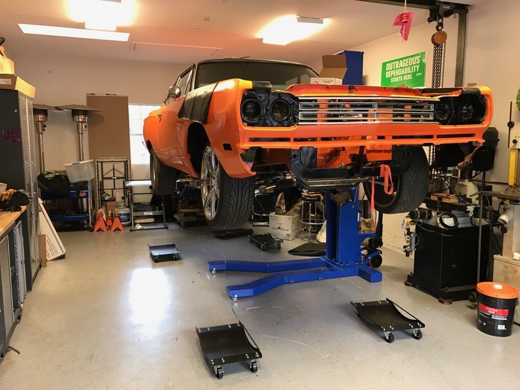

Broke down and bought a single post lift... Life changer!!!
Curious about lift. Who is the manufacture?
I looked at one of those wilcap adaptors when I had my Big Block, was going to use a 4l60e as well. I kept running into the issue no one could answer, what about my external balance? ended up using a small block Magnum and A518.
I think the name of the manufacturer is Tuxedo. But it's not indicated anywhere.
I purchased it from a local tool supplier

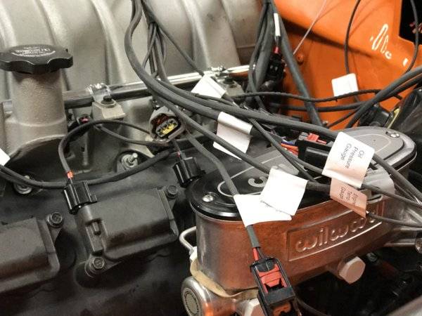

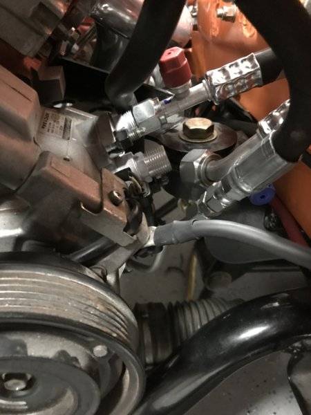

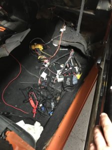

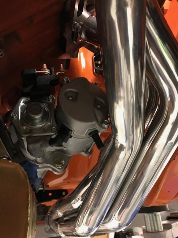

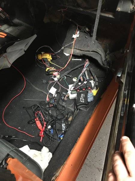

Here are some pictures of the headers, starter, and everything coming together underneath...

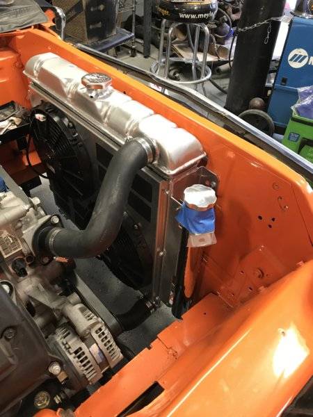

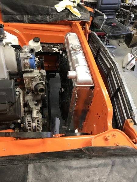

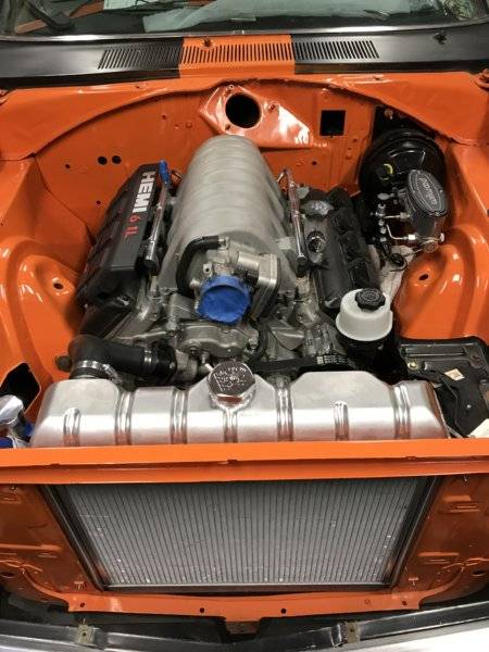

Spaghetti mess! Lol, hey what hoses did you run for the rad?
