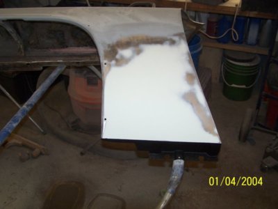

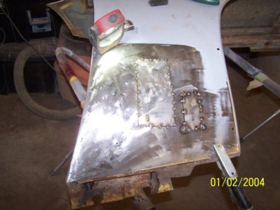

Still going. Very solid car!!! So far there has only been a little rust hole on the quarter behind the left rear wheel. Still need more time and more space to work on this but it is moving forward:) Should probably fix the date.
100_8122.JPG 100_8121.JPG 100_8119.JPG 100_8114.JPG 100_8115.JPG 100_8117.JPG

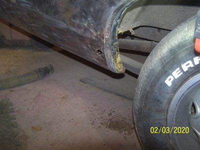

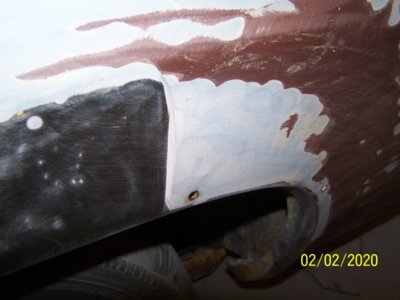

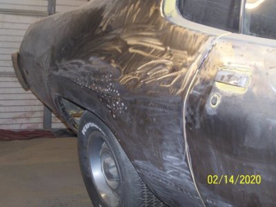

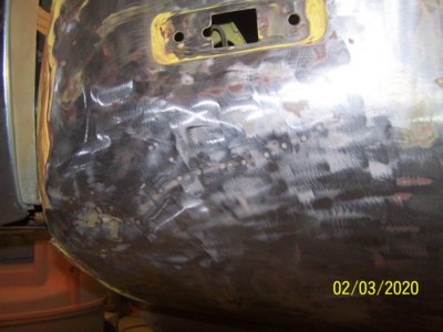

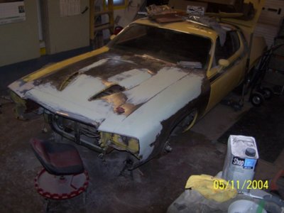

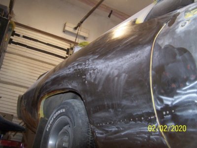

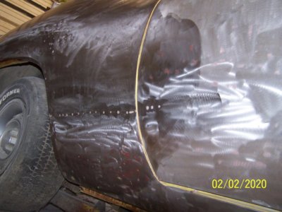

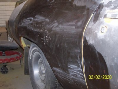

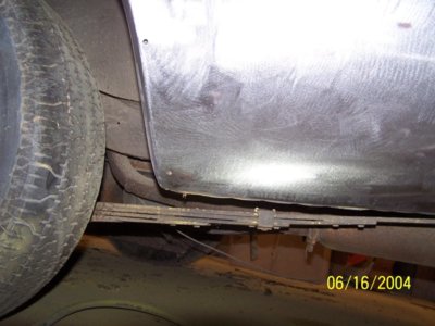

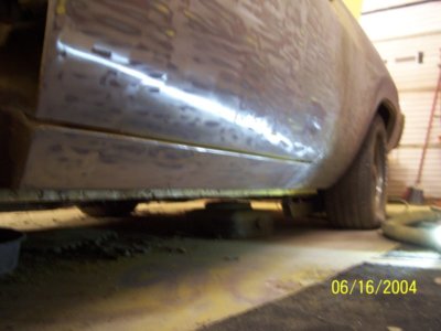

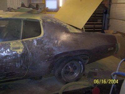

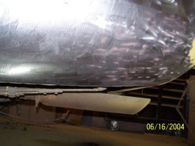

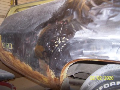

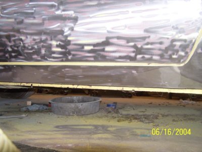

Superbowl Sunday and I am out in the garage again. Started on the passenger side to see how bad it is. Not bad for a 48 year old car. Found a lot of bondo that I don't understand. There was a scrape that went from the back of the door to just before the wheel arch and then some damage to both sides of the wheel arch (top). They filled the #$%@#&* out of this for no reason what so ever. It did not look too bad from 20 feet but the body lines were all wrong. All they had to do was bang a little more of the high spots down, weld in the holes they made, and they could have just glazed it. I don't get it, I took off prob a gallon of bondo and will have this repaired with about 3 hours of work. It was their car so I guess they could do whatever they wanted. I would rather do it right so I removed it all. Few more hours of paint removal and I can switch to pulling the motor and trans. Good for me cause I need to change it up a little:)
100_8126.JPG 100_8127.JPG 100_8135.JPG 100_8134.JPG 100_8131.JPG 100_8130.JPG 100_8133.JPG
Thanks guys. Body work to me is fun. Making the metal do what I want it to do and take the shape that I need just kinda floats my boat. Could use a couple more tools but I am working on getting those. It is the upcoming motor work that stresses me a little. Mainly cause I am not that good at it and it has been a few years since I tore one down. I love FBBO because I get great advise on areas I am not sure of. I ask a lot of questions because I don't like to make mistakes or do things over. On this site, if I see a question I think I know the answer to, I will chime in. Give and take information because you guys/gals are the best. Just my $.02 worth.

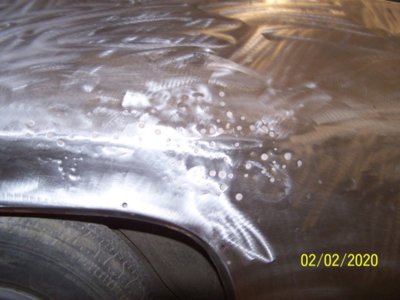

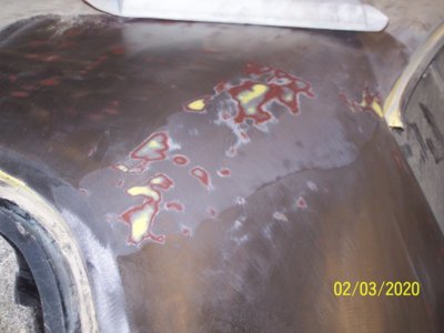

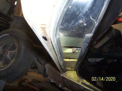

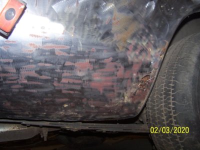

Had a couple of hours so striped the last of the paint. Was a little worse than I expected but not as bad as it could have been. Patch panel or just cut out the bad and weld in new pieces. Not sure yet but I am sure that a rotisserie (should have bought one instead of another car) would make life much easier. Oh well, maybe after taxes are paid, if there is any $$$$ left.

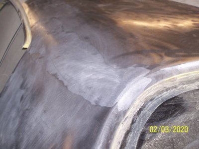

As for the lead filler in the joint between the quarter and roof, the guy on the left side did a much better job than the guy on the right.

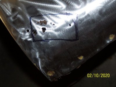

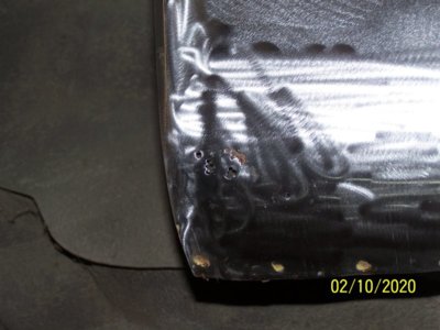

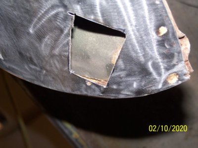

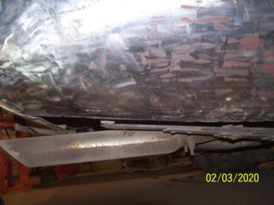

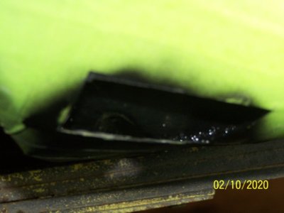

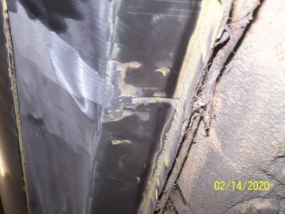

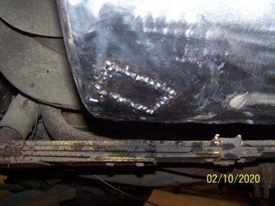

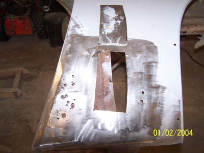

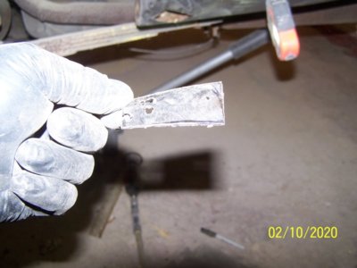

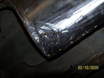

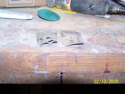

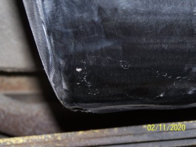

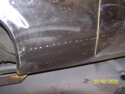

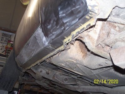

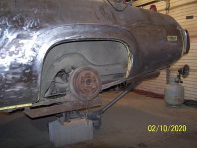

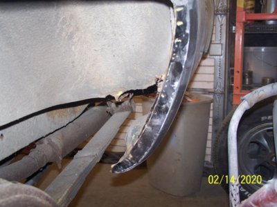

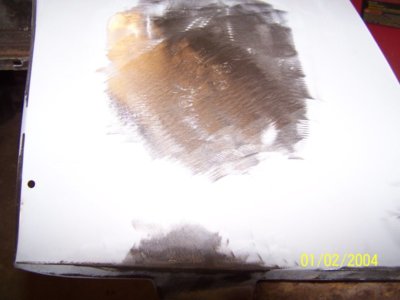

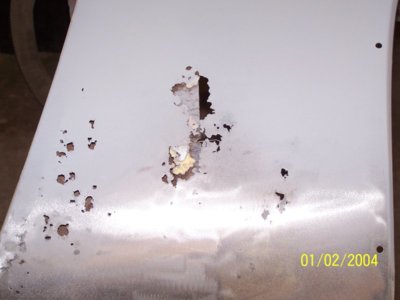

Left rear quarter rust repair:
1) All jacked up
2) Rusted area
3) Area to cut out
4) Little tricky as it has a double bend
5) Rust cut out
6) Rust stop applied
7) New piece
8) Tacked in place
9) Welded in
10) Done
I gotta learn to take less photos. probably gets a little boring to look at after awhile.
You will notice that I didn't cut the patch to the exact size on this repair, and I usually do,
but since this was a small piece I was afraid it would expand a little too much when being
welded and cause some issues with matching the existing metal. I can fill the gap so it is not
a big issue, just uses more wire and makes for more grinding. Six of one 1/2 dozen of the other.
Either that, or I forgot to allow for the thickness of my cutoff wheel.

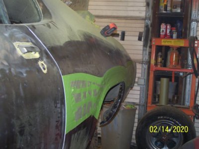

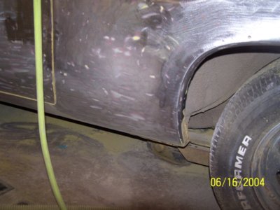

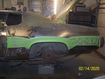

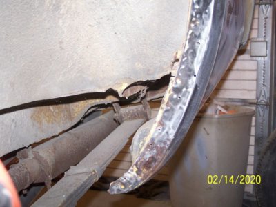

I still can't believe how solid this car is. Either it was not raised in Michigan or it was very very well taken care of. Someday when I get some time I will try and do a VIN history but for now work needs to continue. Filled the holes left by the rear mud flap and laid out a template for the body lines to be used on the damaged passenger side. I will transfer this over, mark where the lines should be, and start working to metal to meet the template.
100_8186.JPG 100_8187.JPG 100_8189.JPG 100_8190.JPG 100_8195.JPG 100_8206.JPG 100_8208.JPG 100_8207.JPG
