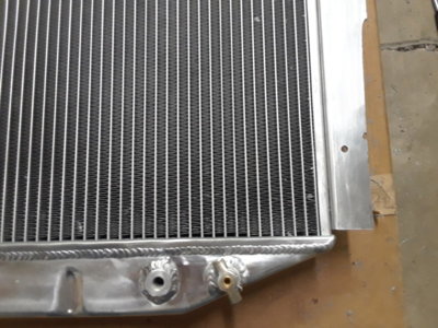

Contrary to what I was told, quite a bit of fab work was required for fitment. I know there are lots of people on FBBO that says different, but that was not my case.
Then about a month of ownership and it started leaking at the upper hose neck. ECP does not cover return shipping which would be $60. I had a local diesel participants filter rebuilder reweld the neck.
Cold Case for me from now on out.
Needed to drill shroud holes also.

drilling holes for the fan shroud is a given for an aluminum radiator.....looks like I'll be ordering my Cold Case rad tomorrow.
I had to grind for fitment at the battery tray, and then down low on the passenger side to clear. One mounting hole was misdrilled and I had to elongate it more than I really wanted to, and the shroud barely fits.
