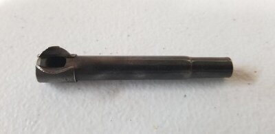

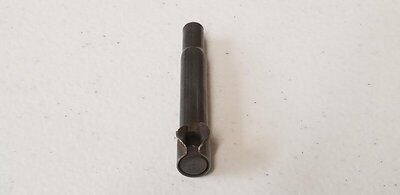

Kickdown fitting 64 Sport Fury 426
dmoore
Mopar to the end
4:48 PM
Nov 30, 2008
1,729
2,168
Virginia
Does anyone know if this fitting is reproduced in a longer version? Changed to an Edelbrock Performer intake & Edelbrock AVS2 changed the total height so I cannot correctly adjust the throttle kick down pressure (need more rear adjustment) shifts into 3rd at 30 mph. I currently have an internal thread barrel nut about 3/4" long in between but it's not long enough. That original factory connector is 1/4 x 24 tpi & 2 5/8" long. Thanks!

Is it an original 426 car? The 383/361 is a bit shorter, (too short). Could make up an extension, female threads on one end, male on the other. An Imperial would have the right rod too, might be easier to find than a 426W one. I have a CH4B with a Holley and the stock length one is working for me. *I redrilled the hole to attach the linkage on the carburetor because the provided hole was too far from the throttle shaft. I’ll explain if you want.
Yes Nate, original 426 convertible..I guess drilling a hole in the adapter arm may work...I need to look at that closer...
I found that the distance from the throttle shaft center to attachment point (hole) on the factory AFB was 1.12” and on the Holley (with Mopar adapter) was 1.5”. Throttle needed to be halfway down before kickdown was at off idle position. I drilled a new hole at 1.12” and a little bit back from the one provided on the bracket. Works perfectly now.
Oh yeah, with the 1.5” radius the throttle didn’t open all the way either.
Just installed the recently built trans yesterday..I will look into your suggestion next day or two..Thanks for your input Nate!
i have an Edelbrock 1407 and had same problem, not enough travel to move shift rod; shifted into 3rd about 20mph and no kickdown. Edelbrock sells MOPAR adapter, but I made my own with a 28tpi "turnbuckle" bi-directional thread, and a sawed off 3/8x28 bolt. Works perfectly now, and easily adjustable. Are you sure yours is 24tpi? Can't find photo but can take one and post if you like.
Geff I misspoke..I mean't to correct that earlier..it is 28 tpi. And I bought that adapter when I purchased the carb knowing I would need it.
