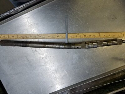

This was not an internal trans problem. This output shaft came out of the 1st 727 that lost a cap. I've seen it happen 4 times. Every one broke the tail shaft. Some did more damage as well. I did it myself with my 4 speed Challenger. Broke the bell housing clean off the back of the block. In every case it spit a cap. Unbelievable amount of force when the shaft gets that far off center and out of balance. Believe or not the trans this shaft came out of only needed a shaft and tail housing.

I think every car should have a front loop. I have seen that happen after they balanced a stock driveshaft, turns out they heated it in spots and pulled the little dings out, it never fully came out because of front and rear loops, the shaft bent right where the heat was applied, failed the front joint, bent the mainshaft and broke the housing. Everything else was fine, a good shaft from Dennys driveshaft is worth the money , I will never balance a stock one again
Years ago I had a rear ujoint cup get loose at about 60 mph. It also broke the trans tail housing and bent the tailshaft. Driveshaft never became disconnected so there was enough vibration that i remember my interior rear view mirror rotating. I do believe the tail housing broke immediately as the smoke from fluid on the exhaust was instantaneous
Trans blew apart because of the yoke/strap failure. Overrun clutch grenaded at the tailshaft/housing because it went beyond design parameters.
