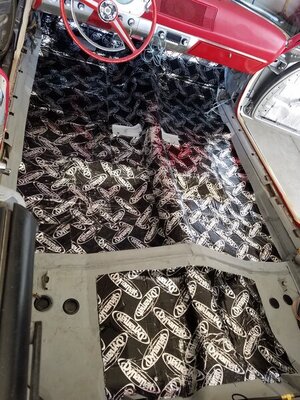

Has anyone ever installed dynamat and 1/4” dynaliner on the interior floor of there car? If so, did you have any issues or problems with thickness? I was planning on covering the entire floor and hump. I thought I’d ask before I got started. It’s an automatic console car.
I installed dynamat extreme and some 1/4" closed-cell foam and on top of that I also got the insulation-backed carpet. I probably overdid it. No issues for me, but I don't have a console.
Keep in mind Dynamat is designed for sound deadening, not insulation. You don't need 100% coverage for it to be effective, especially if you use a foam insulation. Reason I mention this is if you think you're going to have spots where you want less thickness, you don't have to install Dynamat there.
Have you heard the stories of people using the tar roof adhesive on cars. They have a definite aroma when the temperature starts increasing.
The Dynamat is pretty thin and didn’t think that would be problem but adding the 1/4”dynaliner might be.
bought X mat from East wood. After much research it seemed to be the best. The foil will cut you if not care full. LOL. Got the roof liner made for roof and hood application's. No problem with covering the tunnel. Every thing fit fine with the console. I was afraid of the thickness also. But left it off where the floor shifter came through. So the boot would seat well.
Drove the car yesterday and it is quiet.

That's a good point. Some are tar-based, some are butyl-based. The butyl ones have no scent. The tar ones also may not adhere as well in high heat areas.
I used this instead of dynamat. About 1/2 the price. No smell. Then used this insulation over it and then the carpet.
The X mat has no smell. Think it is butyl also. It sticks well. No issue with fitting console after installing carpet. That was my biggest concern was it going to inter fear with fitment.
I installed dynomat and used adhesive duct insulation inside the doors and quarters. I had more than enough dynomat covering more of the floor than planned; figured that was enough...being a vert I can hear more of the wind noise from the top, lol.
I have Dynamat on my 31" coupe and even on such a same car it gets stupid expensive if you do everywhere. I used a product called Siless that i got from Amazon and it is the same stuff but way easier on the wallet.
I used Dynamat on the floors then a layer of 1/2” jute padding. No problems, quiet and cool.
