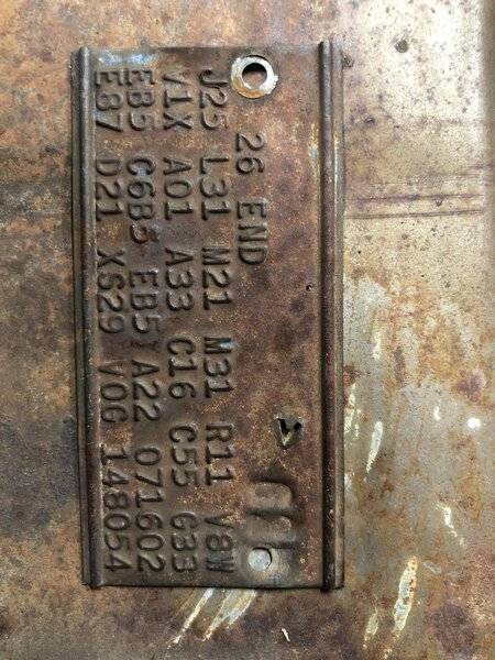

Recently acquired a 1970 Charger RT V code 4 speed car. The sequence number on the VIN is 148054 which matches the title, fender tag, and vin tag. The sequence number on the trunk gutter and radiator support are both 138054. Is there any way to see if and what sequence number 138054 would have been?

I was able to match up the inspection stamps with the inner fender well. Everything is a perfect match so I’m assuming a mistake was made on rad support and trunk sequence numbers.

I was saying it wrong. The vin on the trunk and rad support match each other, but they do not match the fender tag, or dash vin. The fender tag and the rest of the car appear to not have been tampered with. I’ve hear stories of MOPAR having some odd things happen with their vins. Was hoping this was one of them

The fact that I could see the 3 digit inspection stamping on the inner fender and have it line up with the fender tag lead me to believe that it was original to the car.

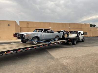

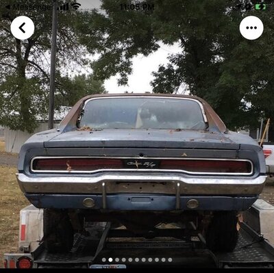

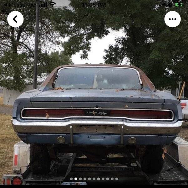

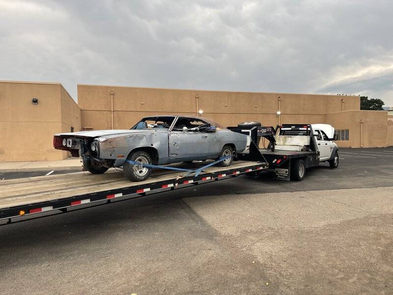

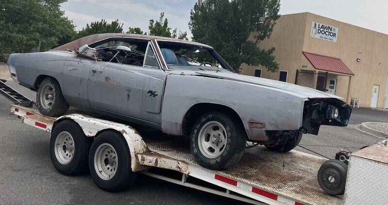

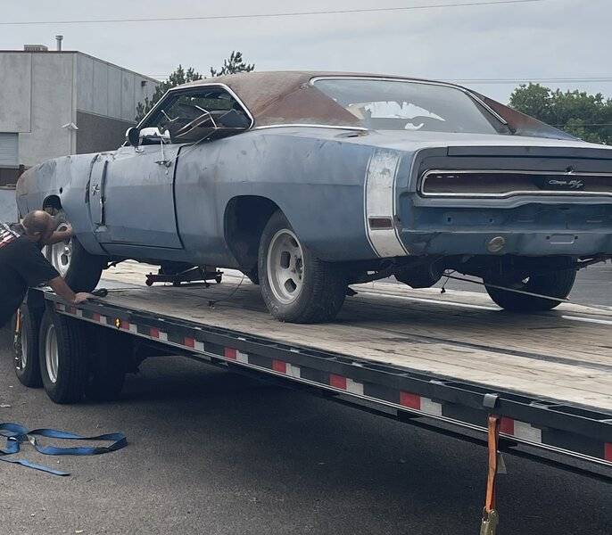

here’s a few pics. A little rough but plan to get it back on the road.
