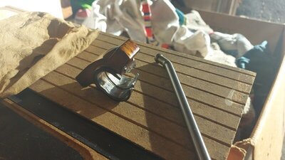

I was cruising on the highway at 3K rpm and I heard alot of racket coming from under the hood, I had the car towed and after inspecting I found 1 rocker demolished, the pushrod to that rocker Blue at the tip, The intake rocker next to it was ok but the pushrod which is a Manton .130 thick turned into a hockey stick LOL These were Crane Gold 1.6 that were on the car for about 35 Years, My bad for leaving them that long, I should have known better. I don't understand what made the adjacent intake pushrod bend like that but I'll investigate, I did pull the plug and all was good as well as springs /retainers ok and pushed down on valves and they move it's a TRICK FLOW 240. I want to replace all of them and looking for 1.6 and I would like stainless steel for longevity and I do beat on this car at track as well. Comp has only 1.5 and Harland sharps although I was told are good I've heard too many issues with Needle Bearings. Anyone besides RAS that has 1.6? domestic Brand? Yes Ebay and PRW are available not sure on PRW haven't heard any feedback on them. I'll attach a pic for you to see

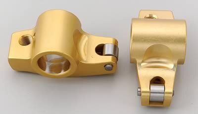

35 yrs? Curious to what the clearance is between the shaft and rocker is and how thick is the wall/journal compared to a new rocker. Just looking at the cross section where it broke looks thin, did you have low oil pressure by any chance due to excessive wear?
This is a pic of a new one, maybe somone can measure a newer one and you can compare it to yours.

Does it look like rocker failure or lack of oil seizing on shaft ?
After examining it it does look like oil starvation but just on that rocker which is weird
I was cruising on the open road for about 90 minutes headed to the track for a race meet, Oil pressure was about 70 and temp was 175, I was actually commenting on how nice the car was going and then heard all kinds of noise and I shut engine down and coasted, Crazy thing is that it just came out of nowhere and it's only that 1 rocker, as well as the biggest mystery of all the rocker next to it, the pushrod got bent and the rocker looks prestine as if it wasn't ever installed HOW ?? going nuts to figure that one out. Did the damaged one move it and cause it to come off it's place and jam up against shart or bottom of rocker?? it's a mystery as to why for oil and bent pushrod

I wonder if the pushrod "escaped" and ended up under the broken rocker? What came first, the chicken or the egg?
That is the most plausible explanation, I went over to see Nick @ Nick's garage, Been racing with him for 45 years since we were kids and he kind of said the same thing, Great minds LOL!!!
