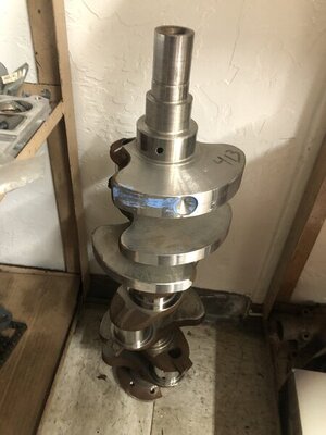

Are the rocker arms adjustable? Have you checked the crank flange? Are the holes in the flange threaded or through bolt? The cast iron TorqueFlite torque converters had studs that slipped through the flange and were held on with nuts. Painted red I am wondering if it might be an engine for an older car even with a '64 casting date. The 361 in my '59 Plymouth was painted red.
The rockers are adjustable. I’ll let you know about the flange. I’ll probably go to the machine shop this week sometime.

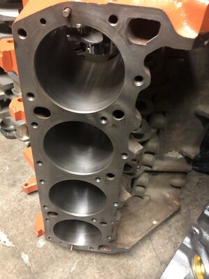

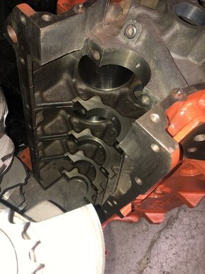

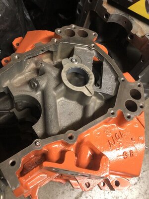

8EF10D99-0A60-4B46-BA75-4508E7E7926E.jpeg C1728024-A0E0-4342-B3E7-E72EC025A2F5.jpeg 77D1324B-A564-4DDA-A3F8-7EAA0CB13265.jpeg 1332881E-F83C-46E9-8A08-B9D0AFF533B8.jpeg
The 413 in our 64 New Yorker was red. Do the heads have 4 or 6 valve cover bolts? Cast in rocker pedestals or aluminum bolt on stands?
6 bolts on the valve covers. I also had a 64 New Yorker. It was turquoise. Not sure about the rocker pedestals. My 64 New Yorker had non adjustable rockers.

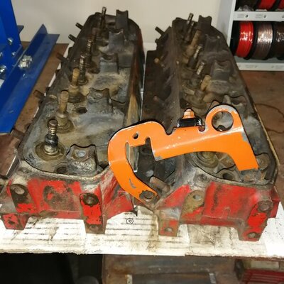

I think somewhere in '63/64 was the changeover. My 62/63 heads have aluminum rocker stands, and four bolt valve covers.
My buddy gave me a set of 516's for my 361 and they were red as well.
