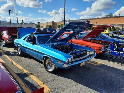

I used the 1" over springs from Springs and Things on my 71 Cuda. I was happy with the resulting stance.
The car was a little high after the spring installation but settled down fairly quickly.

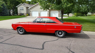

Not in the weeds but probably lower in the rear than you are looking for. I have a 7 quart Milodon oil pan and its never been a problem. It has Hemi (one extra leaf on each side) springs under the rear and I adjusted the front torsion bars to my liking and it rides as well as a new Cadillac. Not the best photo for a profile but the car has a noticeable yet subtle rake.

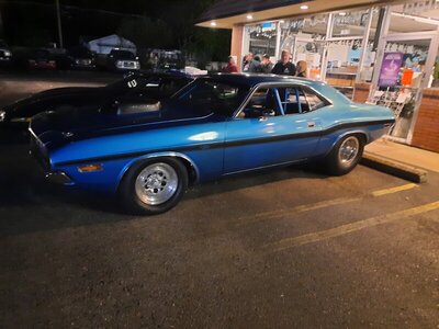

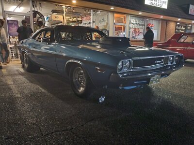

I went the opposite since I mini tubbed mine with 30" tall tires. I went with -1" lowering split mono leafs moved in board to keep it low.
