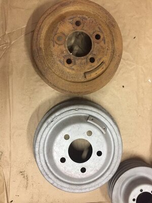

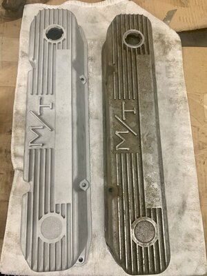

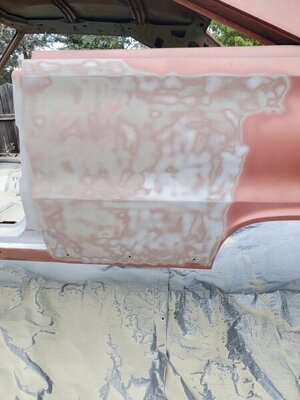

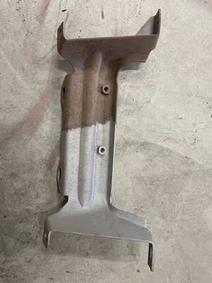

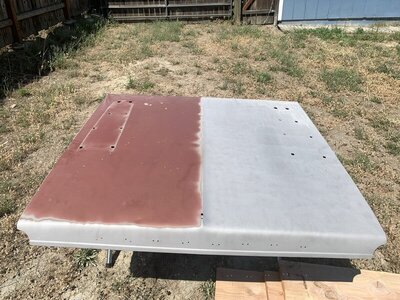

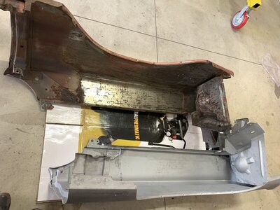

For body panels I use extra fine crushed glass and do three quick passes.
A99D112A-6264-458C-B8AF-97195B7A095C.jpeg 9F06C156-935A-4C66-B938-7010945E234D.jpeg BCD65842-8866-46CF-A80F-63E632620D18.jpeg 3A1DEE03-DDE6-40D5-8278-54C7FC7DB02C.jpeg E70890E5-4441-4380-A1CE-727A04EEB854.jpeg 92E061DD-C433-4EA6-94DC-7BD32251776F.jpeg
I use coal slag media in my cabinet and pot blaster. I source that at a builder's supply. They normally have at least two grades, I get the finest grade they stock. Comes in 90 or 100 lb. bags, which are a pain. I keep a small bag of glass beads around for aluminum or die-cast parts that I want to be gentle with. I blast a lot of cast iron and sheet metal. If you end up with coarse paint chips in your media, it can tend to plug the pickups or nozzles. Some people sift their media to remove these larger contaminants, but I find that to be very tedious and dusty. I tend to just change the media. The media loses it's sharpness with use, also.
Steel parts like chassis or backing plates, I use 80 grit red garnet. The red garnet is value priced around here in the NW, less than half of the other choices, and does the job well. Not too dusty; best if not used too many cycles.
