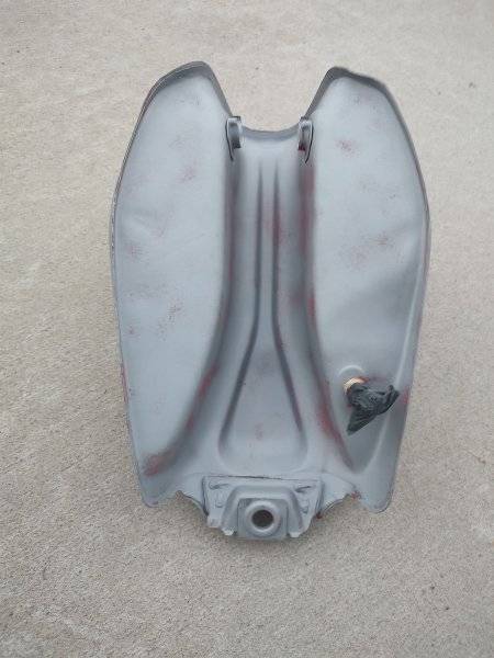

Here's a tank that I hadn't planned on blasting until I realized someone had put cheap paint over the original with little prep. Paint stripper wasn't touching it so I figured I'd do a quick cleaning blast but it stripped it down to the metal really fast using cheap playground sand.

Playground sand is cheap for sure but has also been "softened." It doesn't have the cut blasting medias have. Using it equates to longer run time and compressor wear over the long term. $21 for 100 pounds vs. $7 for 50 lbs vs. New 5 hp Compressor = $megabux.
