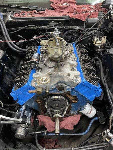

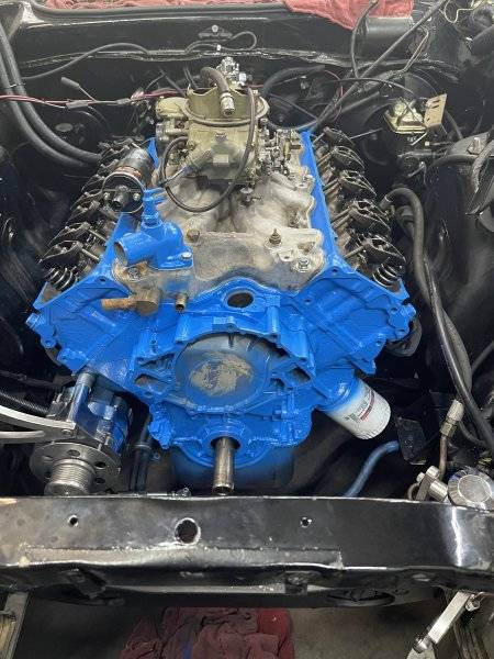

This is a Ford 429 BB I have at work. Machine shop checked heads and put on new double springs to match the cam we bought from them. So easy right? New cam, lifters, and check heads. Flat hydraulic tappet no adjustment. POS didn’t last 5 minutes and we can’t figure out why except crappy parts.
Glad it wasn’t my car!! Any ideas of what could have happened? It is a simple engine, used plenty of assembly lube, cam thrust plate installed. I am baffled.

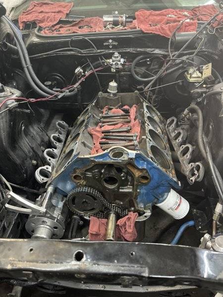

Now you have to pull it out and do a complete tear down and clean everything completely. Take the oil pump apart and clean it well. Inspect everything closely.
I already have the oil pan off and have cleaned and cleaned. I’ll do the pump too. About 1/2 lifters had to come out the bottom because they we’re mushroom.
