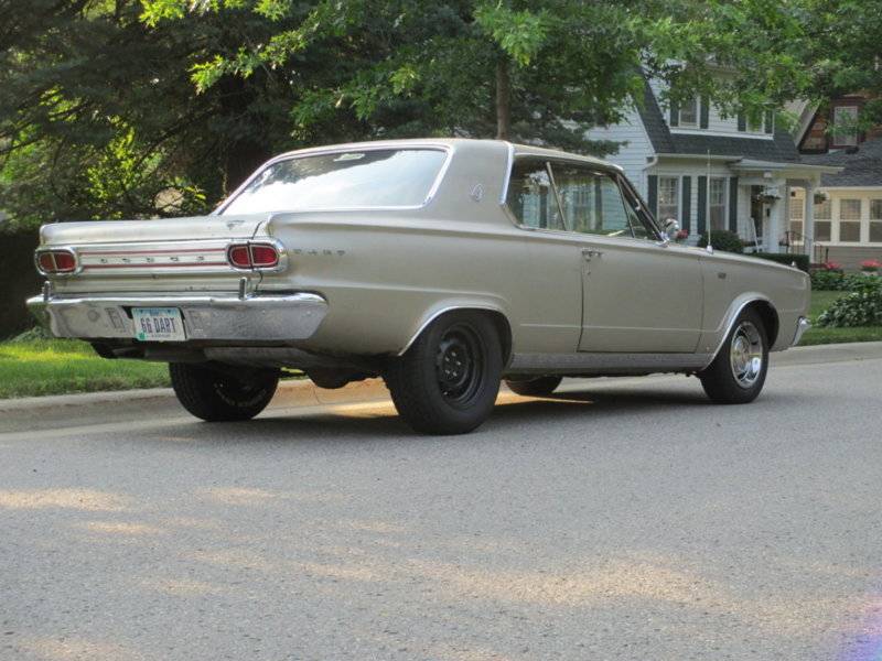

14/15" on both my A bodies. Depending on the look you're going for it works!.

71 340 Cuda....275-60-15's on the rear mounted on custom made 8" rallies and stock 14's on the front. Don't remember the exact size of the front tires but the car still handled well. The car had just a bit of understeer but with a tap of the gas, you could easily induce oversteer! Loved that car and still wonder why I sold it :(
^^^^ I say that with all the cars I have sold... Why ? :BangHead:
