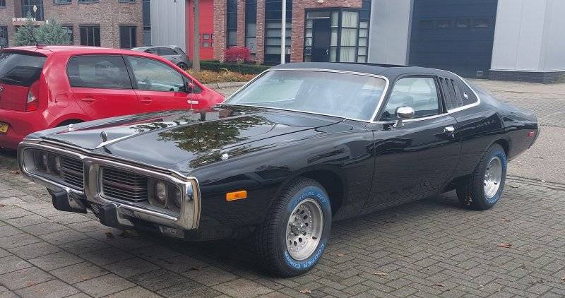

I have 295/50/15 inch tires on 15x10 dragstars on my 73 Charger..
Post a photo. Those are a little short (in my opinion). I'm pushing the 325/50's - because they're wider they're also a tad taller. The 295/50's are only 26.8" tall with a 12.2" cross section. The 325's are 28.3" tall and 13" in the cross section. With close to an inch more thread. But the point is the height fills the well a bit better.
These also take full advantage of a 10" wheel.

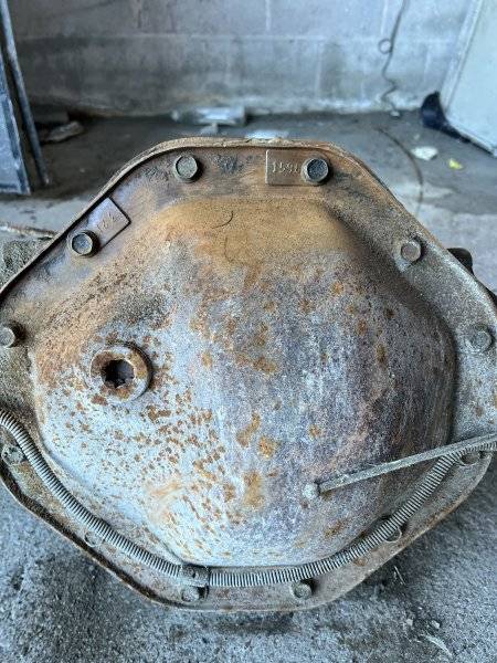

16 posts about aluminum slots and not one pic.......if anyone had posted a Mopar, I'd have spared you all the AMC

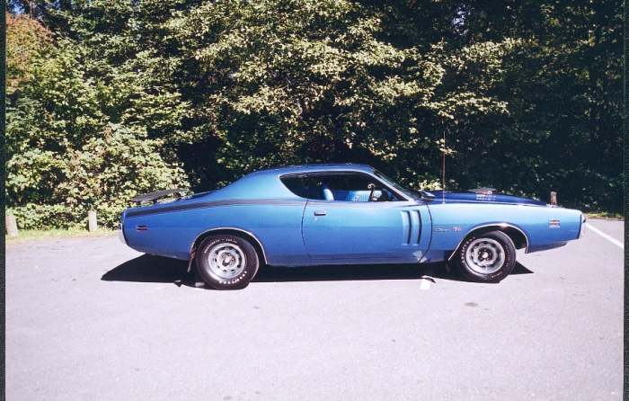

That's a 9 1/4 Mopar rear. These cars have big wheel wells at a minimum you need 245X60 front 275X60 rear IMO. That's what I ran on my 71.
