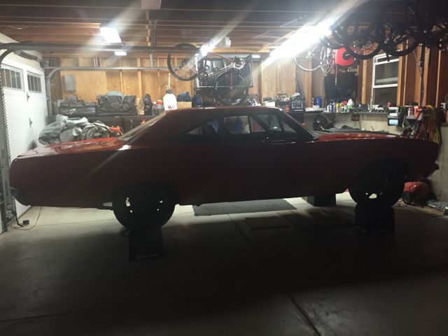

here is mine, had to go with 18s to clear the wilwoods. i tried to go with the biggest side wall. i don't like the rubber band look. 18x8.5 front 18.9.5 rear. none taken RC, we all can't be the same, what fun would that be.
i got 4.5 on the front an 5.75 in the rear for back spacing. you might get by with the 6 in the back but i think you will have a problem with the front. jmo
Hey usa, what size tires are you running here ?

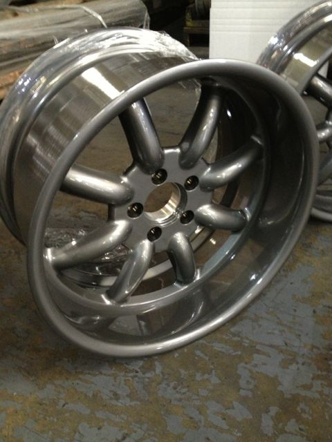

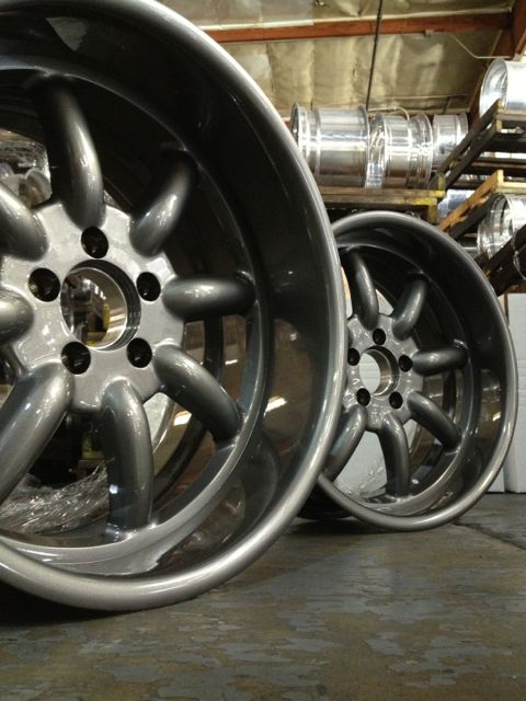

Do you have a full Hotchkis setup? I have essentially the same with a mix of parts from various vendors. I do want to eventually put on bigger brakes/wheels/tires as well.
There was a Forgeline wheel I really liked, now I found an HRE wheel I like even more. Very costly though....

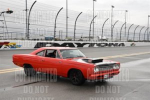

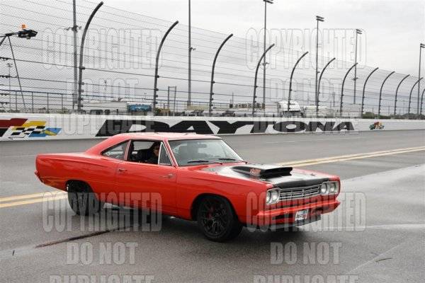

Car weighed 3,800 lbs before and after larger wheels so the load changed how:realcrazy:... my tires did quit buckling under around turns making it feel much safer? So far over 12,000 miles without so much as a hiccup with 18s and 19s but I do really enjoy blowing by guys like yourself on the twisty roads or cruising by them on the freeway at 80 mph only turning 1,800 rpm while they're screaming at 3,500 rpm doing 65 mph all because I chose to IMPROVE my ride. Opinions are like :carrot:, I build my cars to drive and build them for me just like you do yours, difference is I don't poke you for your 15s. :lol:
