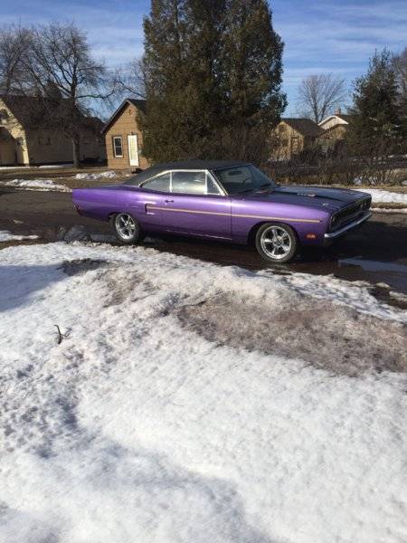

Car weighed 3,800 lbs before and after larger wheels so the load changed how... my tires did quit buckling under around turns making it feel much safer? So far over 12,000 miles without so much as a hiccup with 18s and 19s but I do really enjoy blowing by guys like yourself on the twisty roads or cruising by them on the freeway at 80 mph only turning 1,800 rpm while they're screaming at 3,500 rpm doing 65 mph all because I chose to IMPROVE my ride. Opinions are like
, I build my cars to drive and build them for me just like you do yours, difference is I don't poke you for your 15s.
It's 2 totally different crowds, there's the guys that like what they grew up knowing and there's the guys that like all around performance and nothing wrong with either one.
I swore this thread clearly said 18s on a Roadrunner... why do so many that disapprove keep opening it just to say how much they dislike it. Oh well, enjoy.

I can see your argument in applications where someone makes these mods for serious hard cornering or racing applications but for most of us we just want improved ride quality. In my case mine is a cruiser, I don't try to see how fast I can push it threw corners but really enjoy cruising a twisty road and having the car feel firm and safe. I've cruised the same roads in my last car with 15s and I can tell you the difference is night and day.My comment has nothing to do with the b4/after weight of the car (static weight). It has to do with dynamic (moving) forces imposed on the hearings by the car and the unsprung weight of the wheel/tire. Since these forces are easily calculated (F = M x A) Force equals Mass x Acceleration (speed or G force generated during cornering) applied to the bearing's maximum axial load capacity. For exampke, during a hard left cornering maneuver at say 40 mph, the left inboard bearing and RIGHT outboard bearing receive the cornering forces less tire slippage (less slippage results in greater loads). Just be aware of what is involved. What you do to your own car is totally up to you.... I really do not care. ...just be aware that bearing life MAY be shortened.

I'm old school.....I cannot understand the infatuation with the large diameter wheels and tires. To my taste, i prefer the 15" wheel tire combo that came with the car.
There is one aspect that none of the "big tire/wheel" proponents seem to take in considerstion is wheel/axle bearing loading.....larger wheels and tires add considerably to the radial and axial forces the front wheel bearings (especially the outboard bearing) must carry. True, tapered bearings are great for radial and axial loads (and to a lesser degree rear outboard axle bearings) but bearings have limitations to their capacities. The bearings will run hotter perhaps to the point of lubrication failure. Years ago, while commuting to work, I experienced an front outboard wheel bearing failure.....ruining the spindle, both bearings, brake drum, brake backing plate, shoes.....the right front tire and car parted company......all without warning. It would be my opinion to review your wheel/tire combination to make sure the respective bearings are not overloaded. BTW..I was using a high temp synthetic bearing grease when the bearing failed. CAVIET EMPTOR. ..definitely applies....

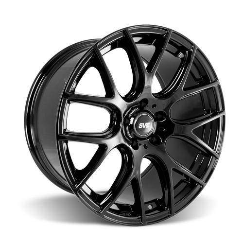

Nice, who makes the wheels?
had to bring this back up
Same construction, forged, cast, billet?
That's what I figured, forged is a more costly process and a much better product where once the molds are made cast is very cheaply produced. I myself won't buy cast rims, cast has a tendency to loose it's finish and isn't easily brought back where forged and billet can always be buffed back to shiney new. You get what you pay for, would you put cast or forged pistons in a high output motor? I know not really the same but you get the point.
I paid a pretty penny for mine and already bent one and scuffed another pretty badly but not being cast I was able to pound out the ding vs it being cracked and polish them right back up.

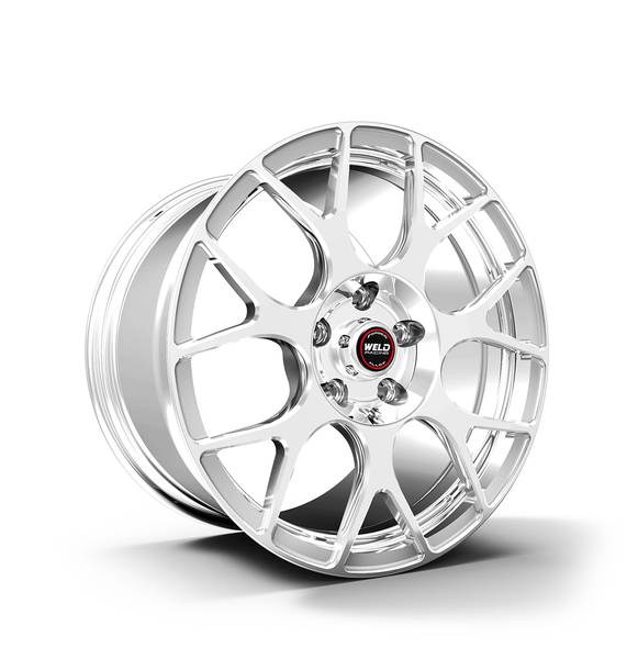

I had never heard of SVE, or many of the other dozens of wheel manufacturers now. If you buy 'em, post a review. They look nice.Bumping an old thread, to prove the value of shopping around. One 18" wheel costs $169/ea the other wheel costs $1,009/ea. They look 90% identical, other than the center hub, I don't know the weight of the Weld wheel but I just sent an email to see what you get for $840 additional dollars:
