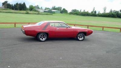

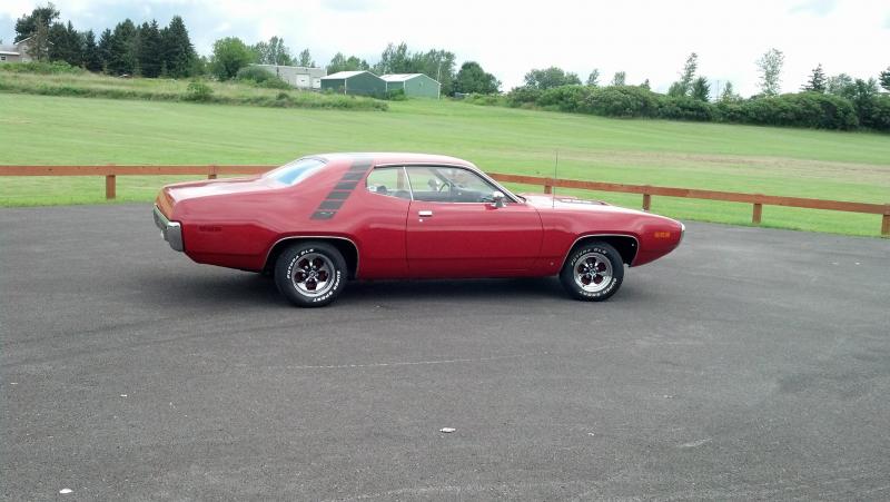

I was in the garage yesterday... - 245's on 7" rallyes
Post pics when you get them please....I have some 14" rally's and I'm looking for a decent tire size that will look good on my Charger.
I used to run 235/60s on 14x6 rallyes. They fit fine and fine, but switching to 15s was one of the best choices I ever made.

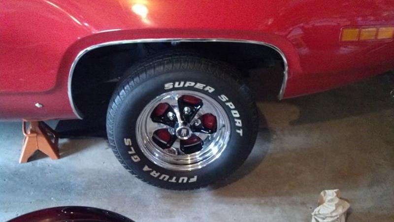

Just put one on today in the front 14x6 with 205/70R14
