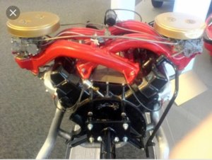

I recently purchased a 65 satellite convertible, I know someone with a complete 383 long tube cross ram RB engine. I am thinking about buying the motor for my satellite. Does anyone know if the cross ram will fit and what the complete motor is worth. Any help or input would be greatly appreciated.
yea i think the gentleman isis right it will hit the innerfenders but cool find i love the long cross rams

Notch the inner fender. Google it's been done before.

RB 383, low mileage to boot. Thinking that would be a fairly rare motor! 1959 only.

if the crank is original, extended flange, you may have some issues trying to bolt it up to a '62 or later transmission.

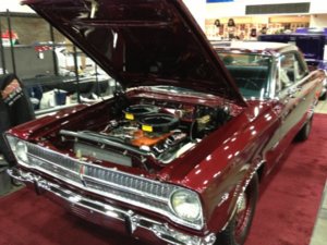

Pictures here might help a little. It looks like the passenger side inner fender is the problem. http://car-from-uk.com/sale.php?id=90647

View attachment 565912 View attachment 565913
